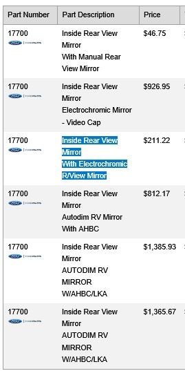

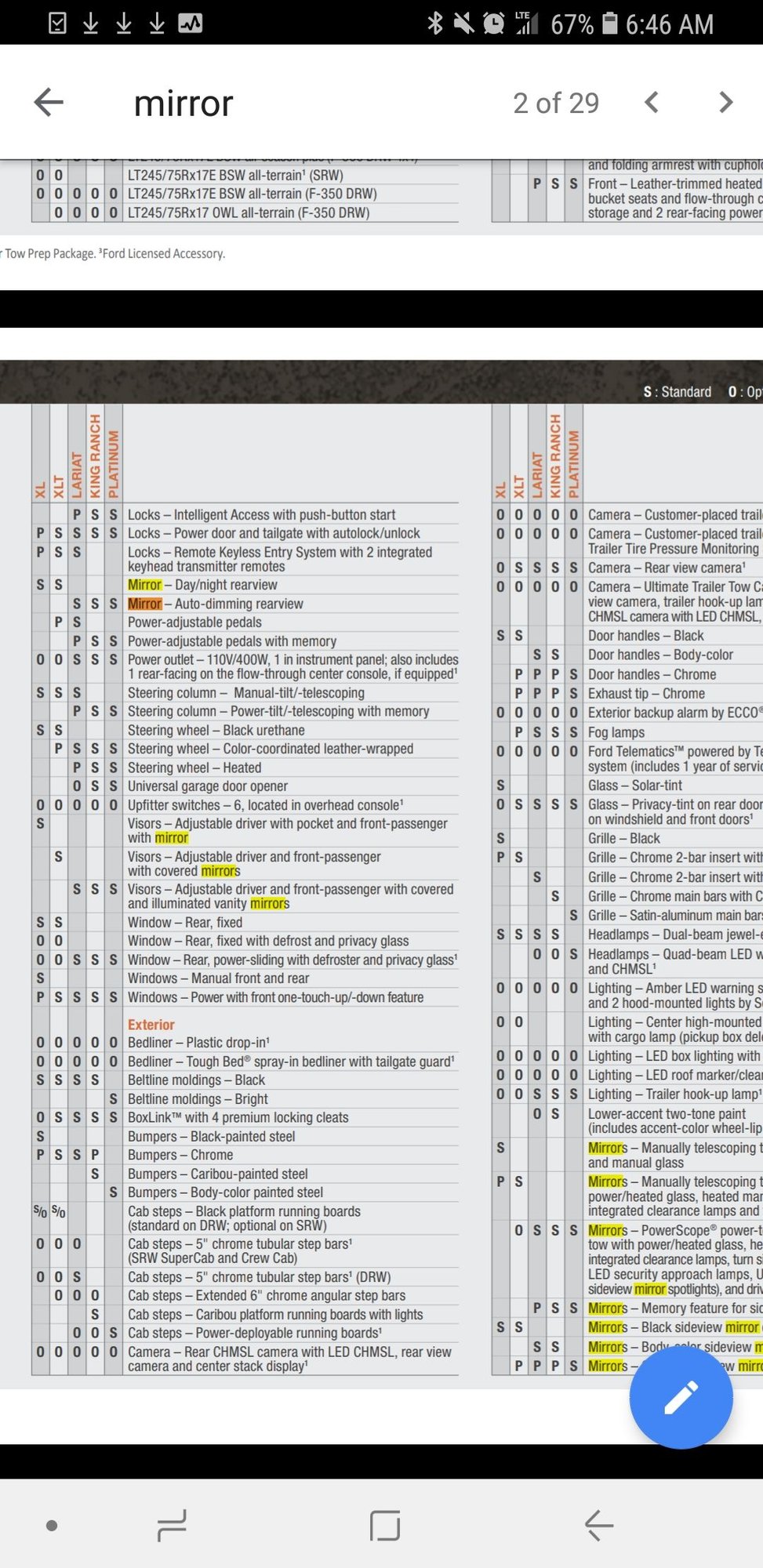

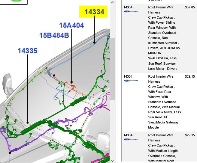

What style rearview mirror do you have? The basic non powered one with the ability to manually flip the switch for manual dimming? That is the only one available on XLT regardless of options. Not sure where you are getting from Ford your truck is auto diming as its neither optional or standard on the XLT. It could be added of you wanted but would require new mirror and programming along with the missing harness.
Keep in mind the option 54F for the XLT adds PowerScope mirrors to the XLT but these are not the same mirrors as found on Lariat and above (Part numbers are different, mostly due to the memory feature). There was also a very brief prior to November 2018 when you could add the driver assistance package to the XLT which did get you the auto dimming features, steering assist, 8" gauge cluster and a few more accessories. This option was rarely ordered and Ford announced that due to commodity restraints it would be dropped. Both the Driver's Assistance Package (96D) and Adaptive Steering (60A) options are no longer available on the XLT. I stand by my original statement that neither of your mirrors are auto dimming.

Not to Hijack but, where can I get these diagrams. I need to know if there is a part number for the drivers side heated/cooled seat wire harness... dont ask☹
