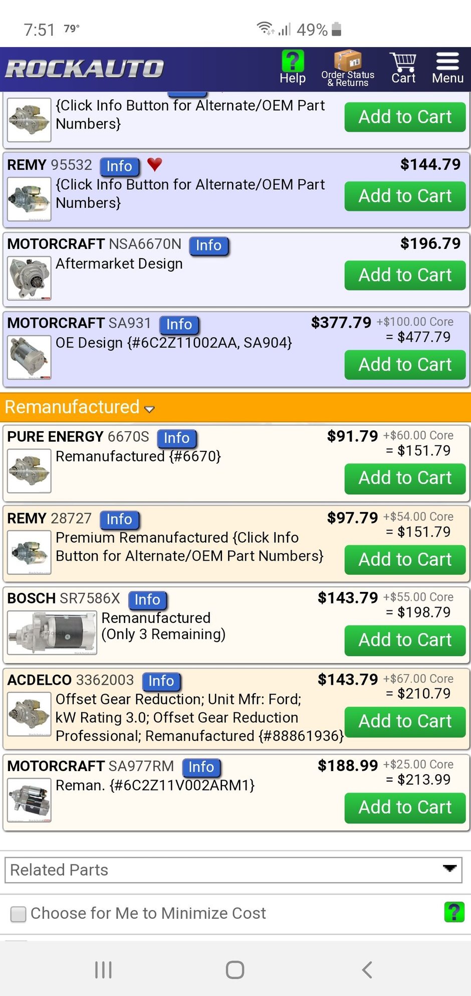

Back in 2000, Ford started up a program in the Motorcraft part of the business to make the parts over the counter to be more competitive to the commercial marketplace, and it also morphed towards the retail customer. The success of that seems to hampered by the fact that every dealer's parts manager has free rein to price the parts, they can sell list, under list, or over list.
But from the supply chain, while you used to have "Blue Box" parts that were exact to what was installed on the assembly line, or you had remanufactured example of the OE part, now there is a spread to accommodate different price structures. To me, that waters down what I would go to Ford to buy. My reasoning would be I can get OE, or its rebuilt done well. Now we have your dilemma. OE, OE rebuilt, OE Design, and Service Design. Really, WTF is Service Design?
I've condensed the Motorcraft offerings from RockAuto that HP noted, and showing the images that they provide.

Chris, again you have to go with what you are comfortable with, and that maybe $300+. I've got no issue with that.
I was comfortable doing a less than $75 purchase, primarily for a test and then possibly selling the starter back on eBay. I still have not decided on doing that. Others like Caleb, Randy, etc have been fine, but that's their mindset, not necessarily yours. Sean went a step above us and on his one did a mini-rebuild. I've been to a local shop (now closed) that used to do fantastic rebuilds. I also had been in a local shop where a past employee worked that rebuilt starters and alternators, not replacing parts if they were not failed, not using new bush or voltage regulators. A crap rebuild, more like what the "retail" auto parts stores are selling in my opinion.
