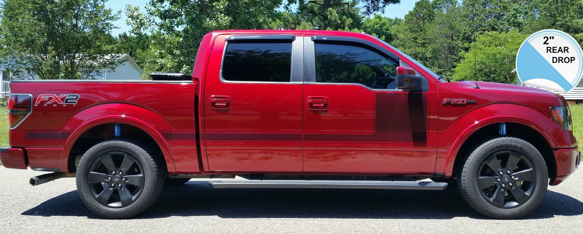

So here's where I am currently. A couple years ago, I installed a 2" Rear Drop, using Ford Racing Shackles, making it 1/2" higher than the Front (still have OE Shackle's).
I've recently Installed a Hellwig # 7705 Rear Sway-Bar (see link below on my Build-Thread for Pic's) & want the Lowering Kit to work with it :
https://www.ford-trucks.com/forums/1...l#post18552784
I read a few people have used a McGaughy's Lowering Kit # 70029, which is a 2/4 Drop & what I want. Unfortunately I am unable to find great detail about it.

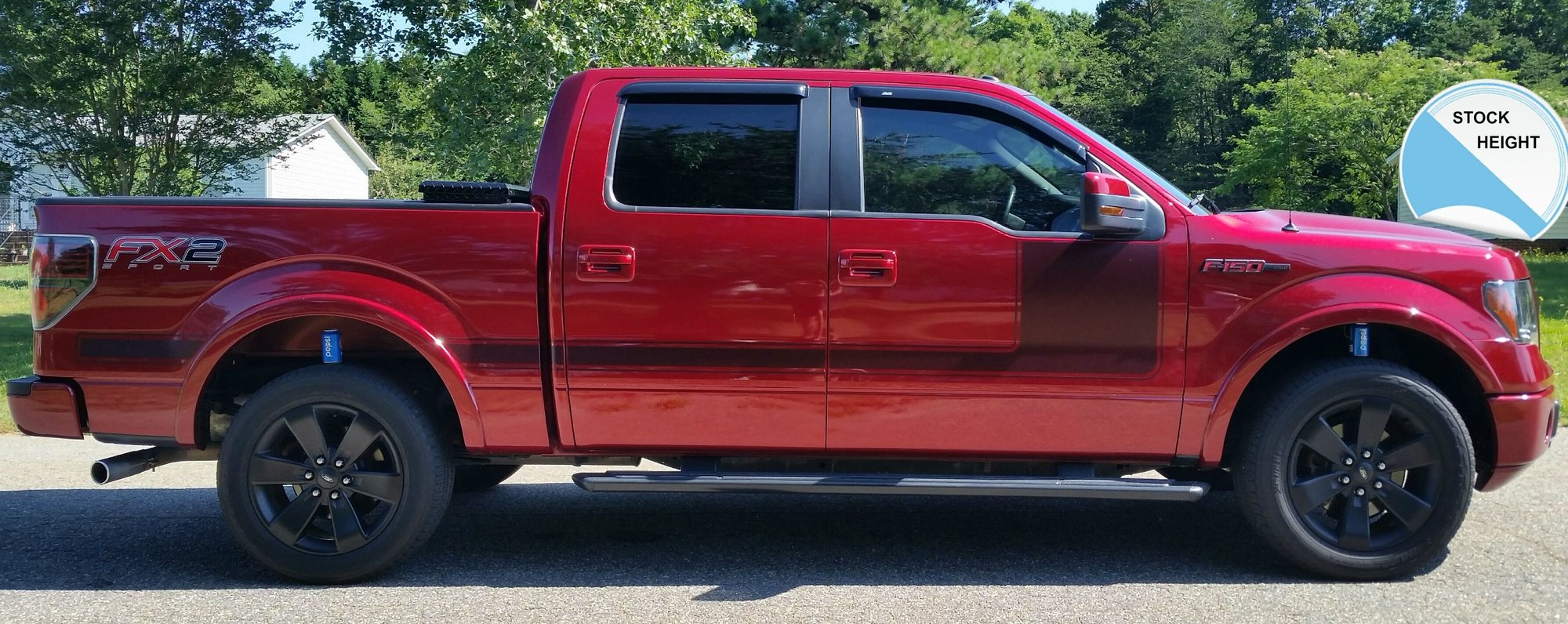

Of course I am including Pic's... The first 2 are from 3 years ago, when I dropped the Rear... The next 2 are recent photos

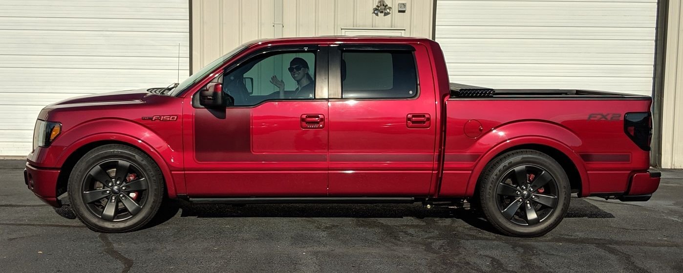

Great News.... The Belltech # 983SP Kit has been Installed & the Truck looks like a Sport-Truck should
Now for some details; as I previously stated I wanted to switch the Springs (both Front & Rear) Right to Left, while it was apart. Because the Truck sat 3/8 inch lower on the left side. IMO, it's because all the weight is always on the left side (Fuel Tank & Driver), not to mention the Springs are 6 y/o's old now... My theory proved right, the Truck now sits only 1/8 inch lower on the left side & that's with a Full Tank of Gas! Plus, initial measurements were taken with only a 1/8-1/4 fuel level, so it may actually be less than 1/8 inch considering. I'll re-measure later.
Also, I initially wanted a 2-4 drop. However, I ended up with a 3-5 drop... Here's how; after the Flip-Kit was installed (yes, I re-installed the oem Shackles) it was actually 3" lower, than it was with the 2" shackles & 3+2=5 total. This was confirmed after the Front was set at a 2" drop, which resulted in the Front being nearly an inch higher than the Rear (oh, hell no). So, the Front was taken back apart (urrgg) & all collars removed, then set at max-drop of 3" supposedly. Afterwards, the Truck sits exactly 5/8" higher in the Rear... PERFECT, IMO
