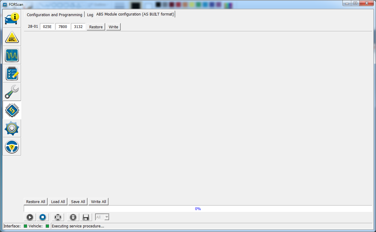

Here is what the old way looked like if you wanted to make changes:
Here is what the new way looks like if you want to make changes:

I'm getting conflicting answers for speedo corrections from the various ForScan forums/Facebook groups. Seems they're all "punters" just like us...
I'm connected to the '01 Ex PSD, analog odo, and within the ABS Module I only have two tires sizes to choose. My AS BUILT format looks like the first photo on both 2.3.13 beta or 2.3.14 beta. I'm told the analog speedos can only correct down to 600 revs/mi minimum (I need 592). If/when I can gain access to the improved version I'll mess around with both revs and tone ring size to see if I can find a nice compromise (but even 600 is far batter than the 655 I have now).

Just checked and it works like a champ. You need to click the ABS Module not the ABS Module (AS BUILT)

Yeah, this is what I get when I select ABS Module, both versions. If I select "Other" it does not give me the option to add another value, it just stays at "Other":

Weird. Have you tried uninstalling and reinstalling? Make sure it's not the wine edition.
i have the latest version and when I open the abs, I get 3 lines. Like in my original post.
