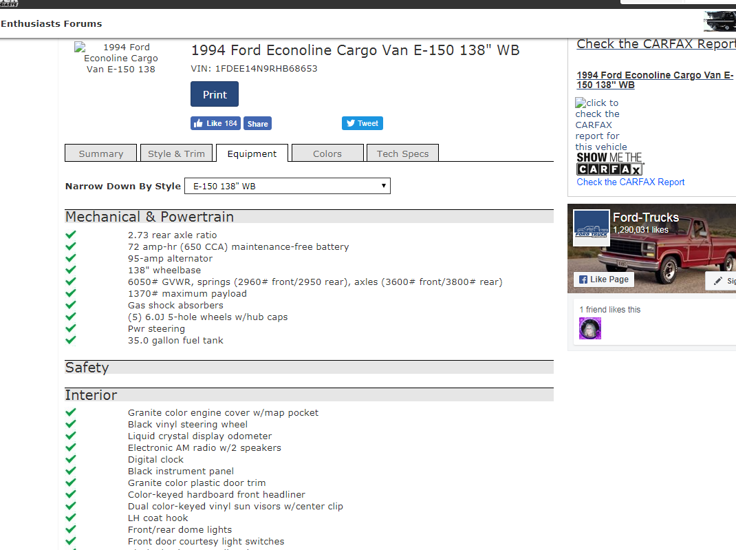

According to the VIN decoder on this website it's loaded with 2.73 but other decoders showed 3.23. I figured for the weight involved Ford would be crazy to stick something under 3.00 in it. I wish I had 3.55 or 3.73..

I just ran across a chart that showed road speed vs RPM for a group of gear ratios and at 60mph I'm doing around 1800 RPM. This chart says 3.55 is what I have so you were right. I have no idea why these VIN decoders have errors the way they do.

Out of all the 90's pickups and vans I've been under, all had either 3.08 or 3.55. That online info is often chock full of mistakes.
