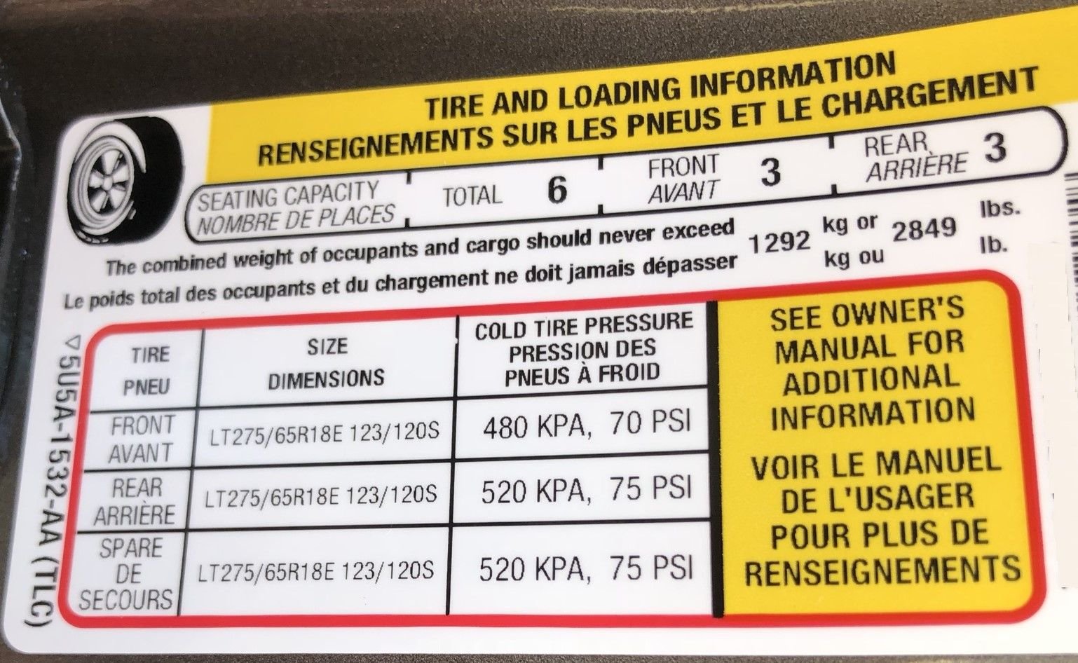

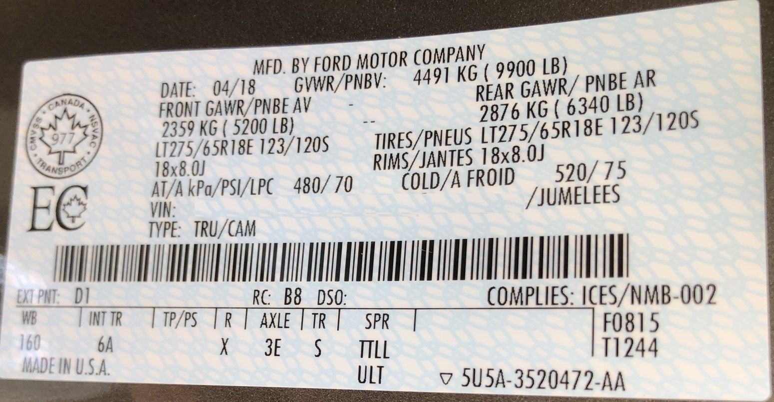

Here's some numbers for you. This truck:
With these tires, axles and springs:
Has this payload:
Even accounting for the 100 lb difference between the 9900 gvwr and the 10000 gvwr package, that would only bring it to 2949 lbs payload with the gasser, spec'd this way.
