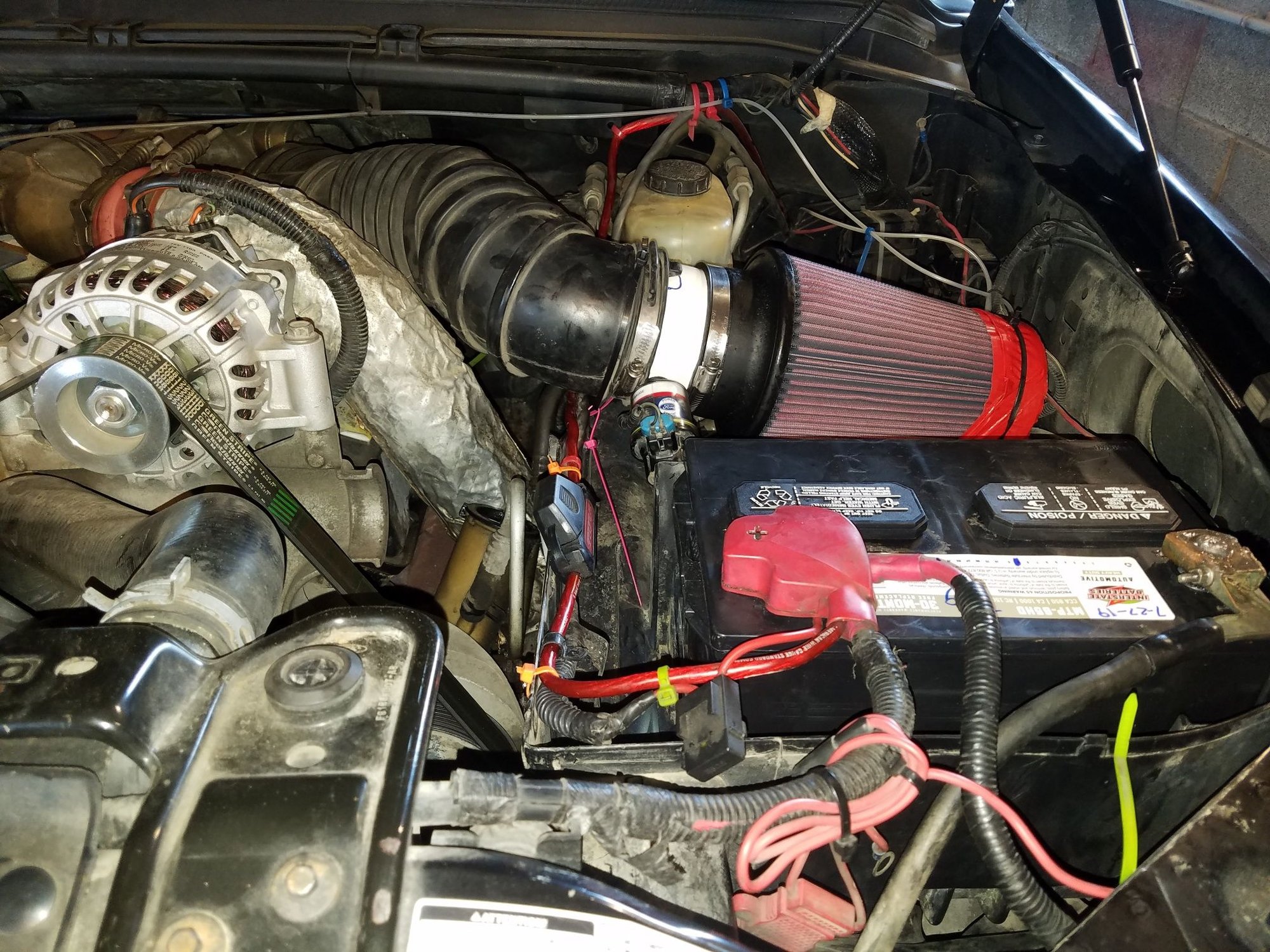

Hooking up the 2nd battery cable on the driver side and I noticed it had a heavy spark, not your typical memory and such light spark. Key OFF.

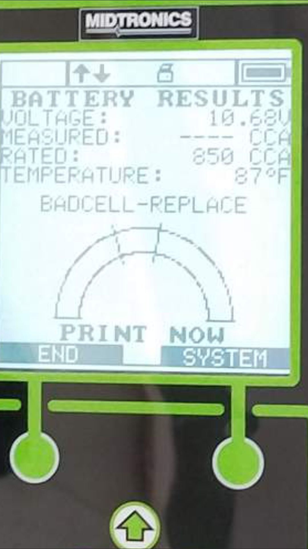

Took the Ex into work with me Friday night. Used a REAL battery tester we use for AAA calls, the same one Interstate battery dealers use, and lo and behold I had a dead cell in the one battery.
They gave me a little bit of pro-rata so I saved like 50 bucks off new replacements. Almost guarantee the starter dying was killing the batteries, now 4 years old...6 year warranty.
So....new alternator, new starter, 2 new batteries, 3 inch lift...really need a break financially!!!
$1600 in less than 2 weeks is way too rich for my blood...thank God we dont have car payments!
