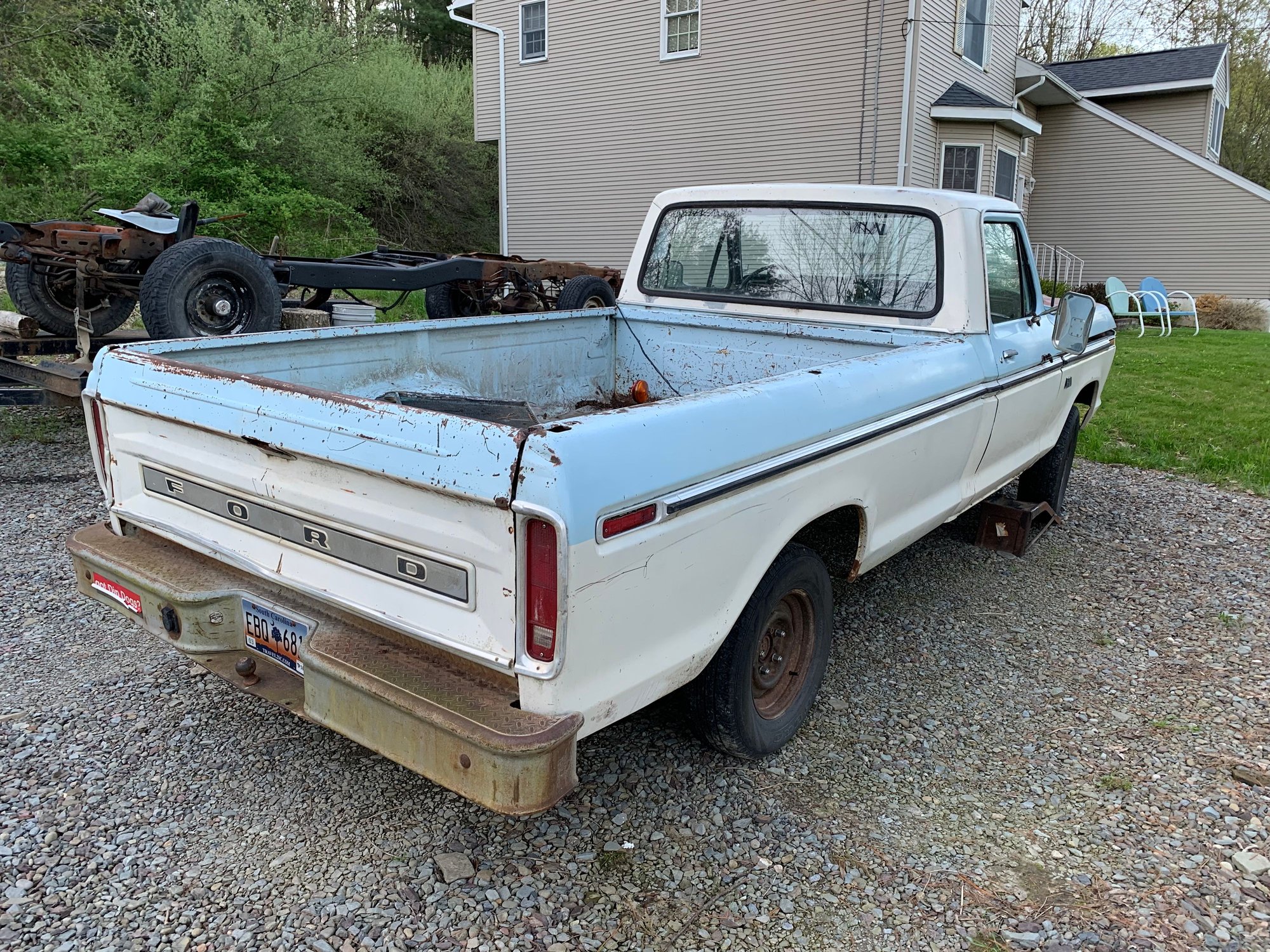

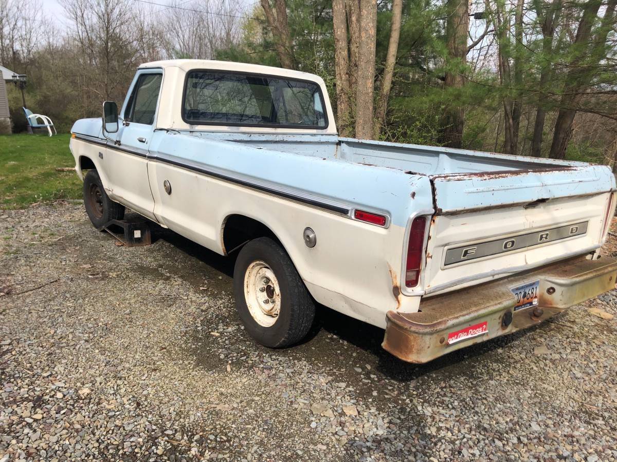

I have all the side trim & attachment hardware off this 1976 F100. I don’t know what shipping would be but I can look into it if you’re interested.

Yes please, check shipping and send me a message.
