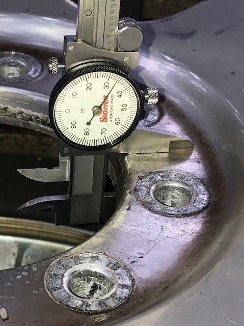

Help, I have a 2001 superduty and bought these wheels from a 2005. I'm using the 2" spacers with the correct hub centric design. When I bolted a couple on yesterday, I noticed the lugs dont screw as far down. I added a pictured. Is this ok? I pressed one out and have been looking for one about 1/2" longer but have found nothing. The studs are M14 x 2.0 and inside lip to end of thread are 2-3/8" long. Anyone know where I can find studs about 1/2" longer?

So I took the wheels back off right after I took the pics because I didn't want to chance it. The thread length on the studs is about 1.5" and if I could find replacement M14-2.0 studs atleast a 1/4" or 1/2" longer I would use them. So my next question is this. The hub thickness on these wheels is .835" or right at 21mm. Compared to the stock 16" wheels I've got on the truck they are about 3/8" thicker. The pic is of the 20" wheel hub thickness. Could anyone with another set of 20" factory wheels of another style check there hub thickness and let me know if others are thinner? Thanks
