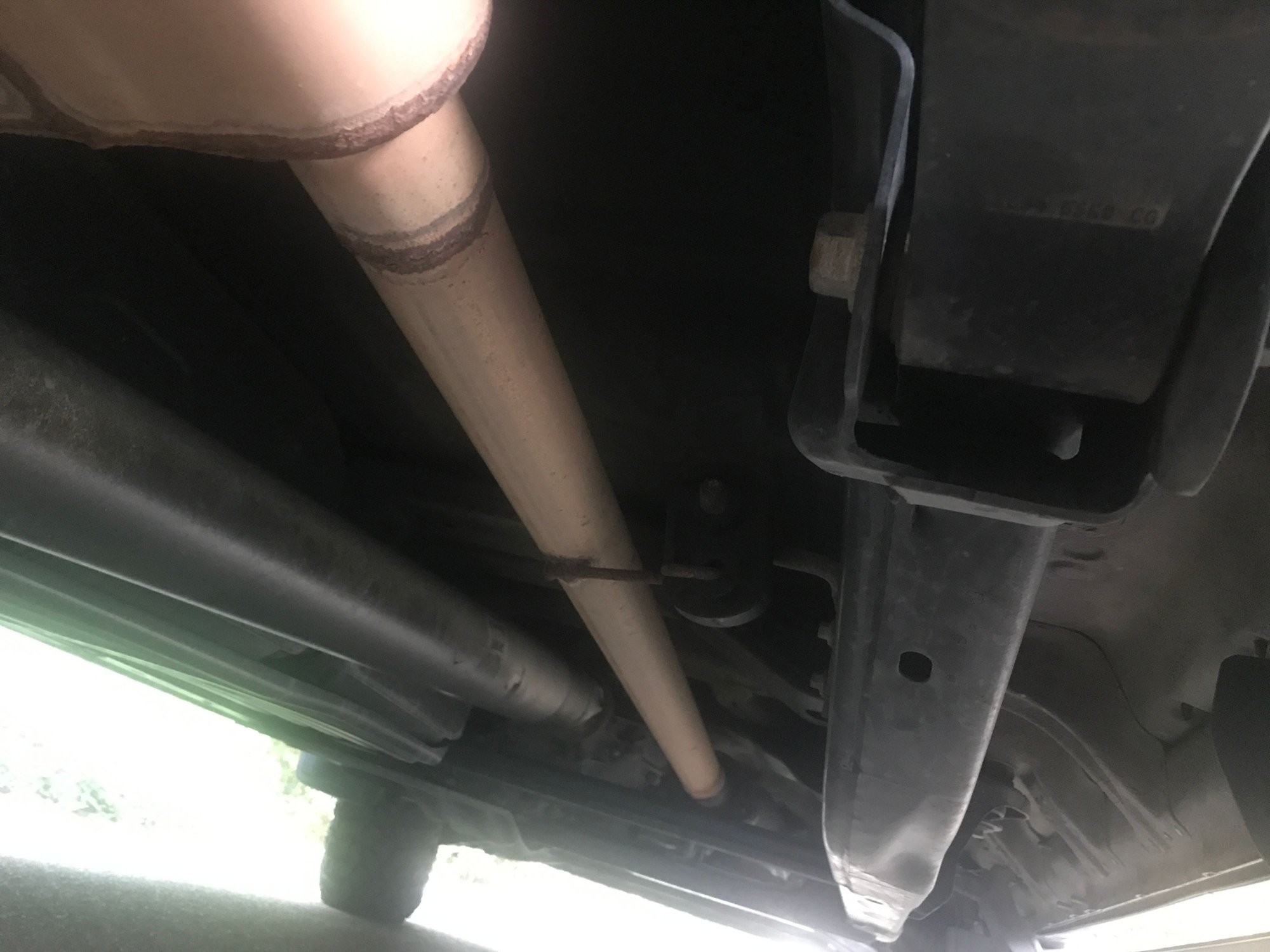

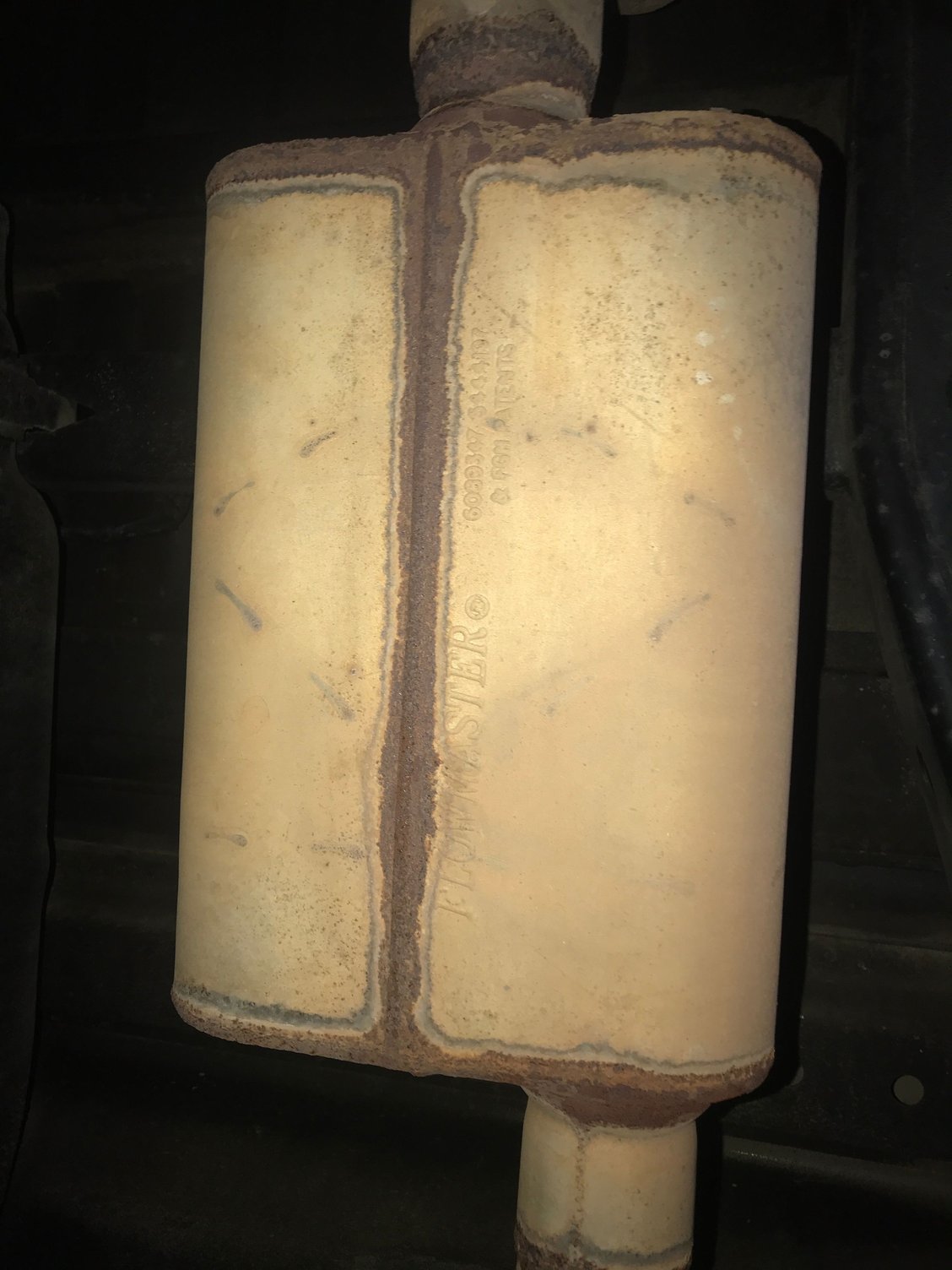

So I bough my 2015 5.0 a couple of months ago and love it. I do however dislike the muffler a bit. It’s a flowmaster, not sure which model, it was put on by the previous owner.
I will say it is cool hearing that V8 a bit and don’t want to lose that entirely. Is there a muffler anyone can recommend in between stock and ridiculous? Not looking for entire exhaust, just a replacement muffler.

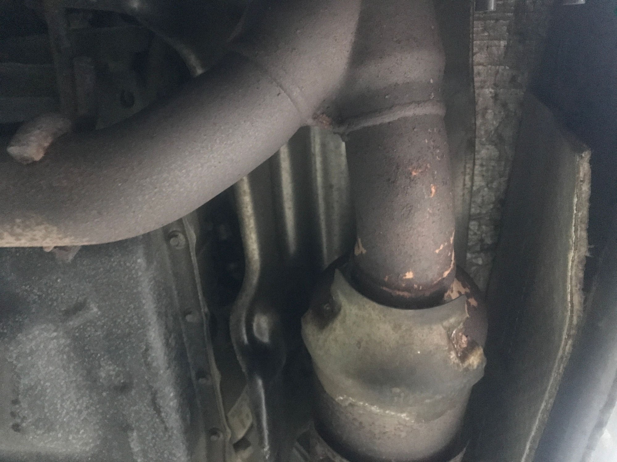

edit- i added a few more photos to show most of what i got going on underneath since I don’t have a clue what stock looks like and i started hearing about resonators, which looks like I don’t have???

so it is hard to make out my model #, but i’m 90% sure I have the 40’s series 42541, which makes sense, it says very aggressive on their web site.
i want a little less sound, but not stock. Now that I know what I have, any suggestions would be great. I’m open to any brand, just want to replace the muffler to something sweet sounding without quite as much noise.

Definitely get something stainless, looks like that Flowmaster is aluminized and maybe a year from rusting out anyway. Why Flowmaster still makes aluminized mufflers I don't know, since they're only about $10 cheaper than their 409 stainless ones.
Also, you may find it still annoying without the resonator. Possibly you could find a factory resonator and splice it into the system? I know a couple places sell replacement resonators but all the ones I've seen were aluminized only, not 409 stainless like the stock one. You can find some stainless aftermarket resonators that mostly do the job but probably not as well as the stock one.

yes, you could definitely get rid of the resonator, I did with mine .. the tone will continue to warm up after being on for awhile, been about 6 months and it sounds very nice and low now.

As already mentioned the muffler looks like one of the 40s. If its very loud I think its not a delta flow. Adding the resonator will take out some noise. Especially in the cab the sound will be more "civilized".
If you want the sound lvl more in the midrange I would try the 50 series heavy duty. I almost bought this muffler myself. I decided for a 40 series delta flow without resonator delete (cops will hunt me here in germany with a delete).

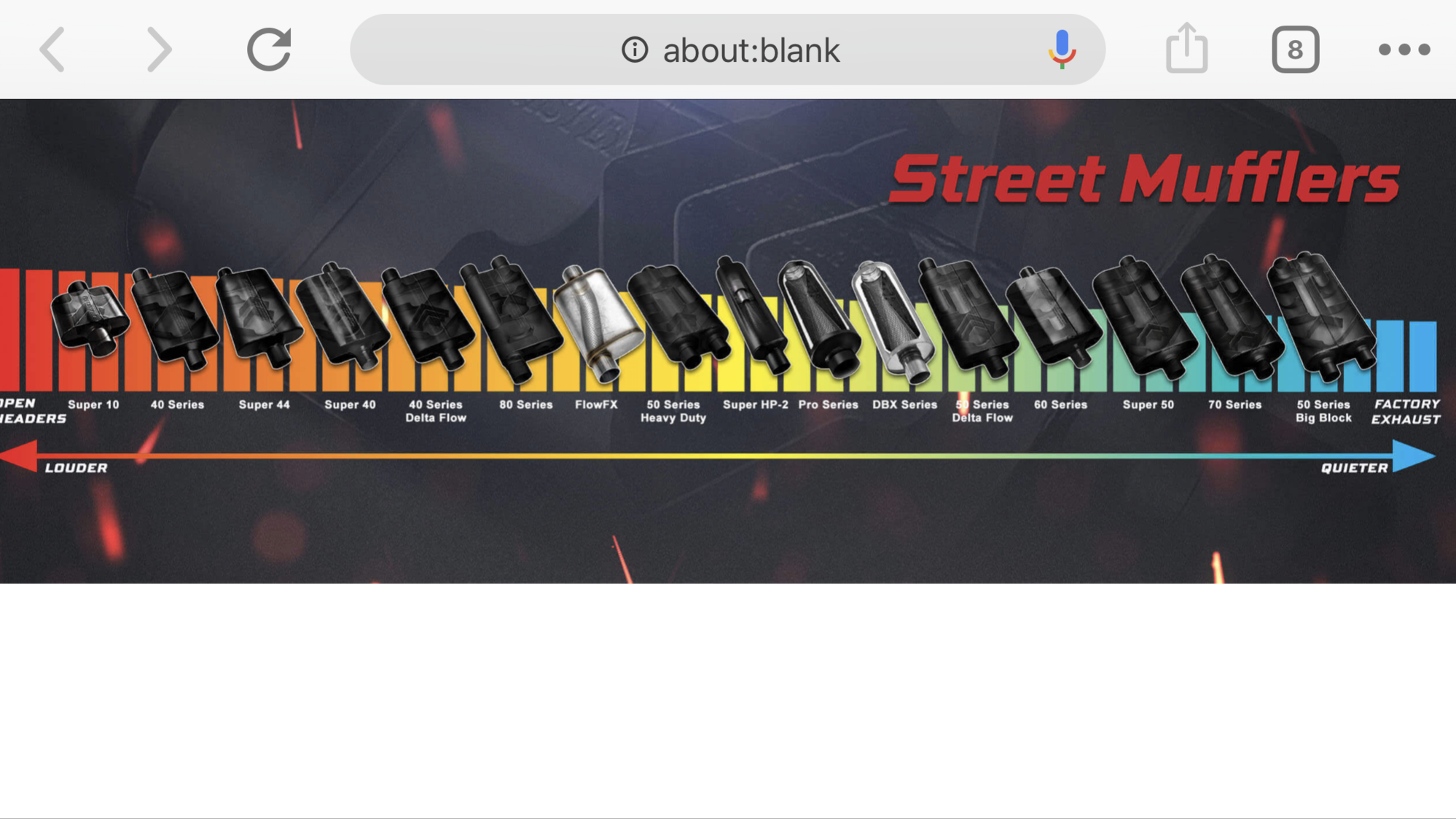

Yeah I confirmed it’s a 40’s series which is their 2nd loudest out of 16! I am looking at the 50’s series between the delta flow or super 50. The delta is the 12th quietest and the super is the 14th quietest out of 16. I spoke with them (holley) and they said either one will be wayyy quieter than the 40, with the 50 delta being a touch louder.
The 50 series HD your looking at is in the middle as far as sound at 8 out of 16.
FWIW, I have a Super 50/ 50 SUV (whatever they're calling it now), just put it on last year. For something flowmaster says has a "mild" sound it was pretty damn loud. Probably not as loud as a 40 series but loud. This guy's video does a good job of illustrating the sound level:
I had to add a section of spiral insert to bring the volume down to more acceptable levels but right now it's perfect.
