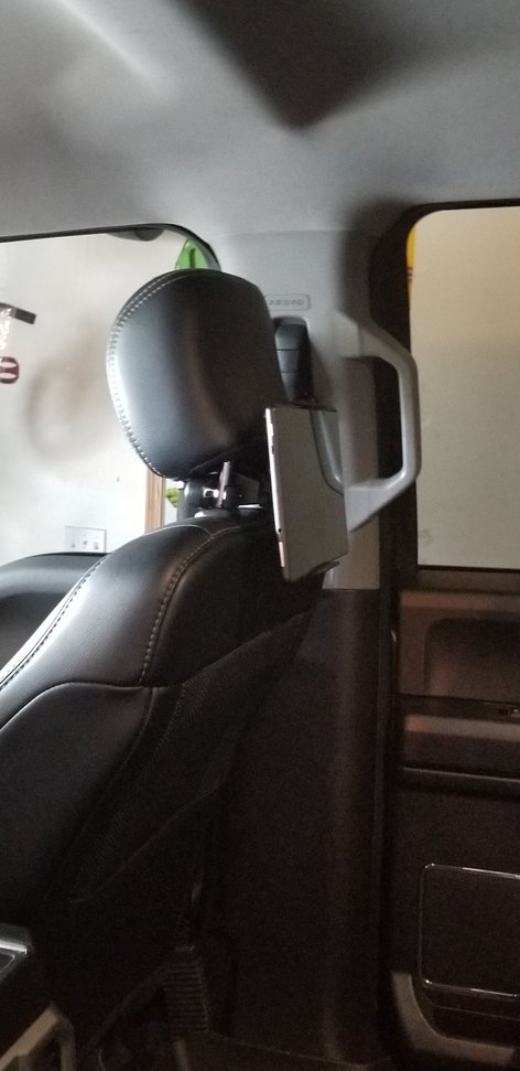

There's are the mounts I got for the 10 Fire tablets. They screw on to the posts vs clamp.

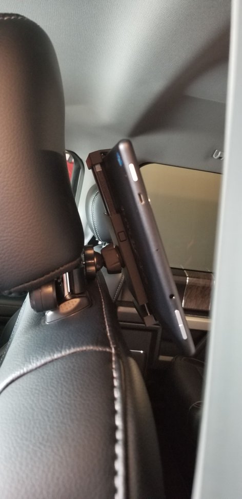

Side view how far they stick out
Both installed and pwr wire connected. Got the 90° connections vs regular to increase life and make it smaller. I have 3 boys.... If I can find a way for them not to break things ...I will.
Side profile
Pwr cord ran down back of seat under headrest post. And under the center console
Pwr cord running to center console. Checked seat movent. We're good.

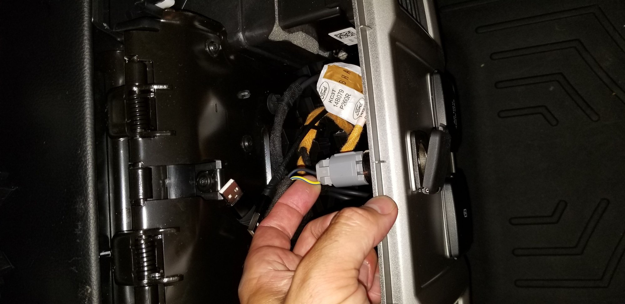

Pulled rear cupholders. I wanted a keyed power source so the tablets werent drawing power while truck was off. The top 12v socket was the ticket.
I'll be using a dual USB charger that's wired so all I have left is wiring it up and plugging the tablet USBs in.

EWeezY,
How did you get the cup holds off?
Thanks in advance.
Old Jul 20, 2019 | 09:37 PM
EWeezY's Avatar
EWeezY
Joined: Mar 2018
Posts: 90
Originally Posted by 05 superdutyal
EWeezY,
Thanks in advance.
Pull up. Very easy
