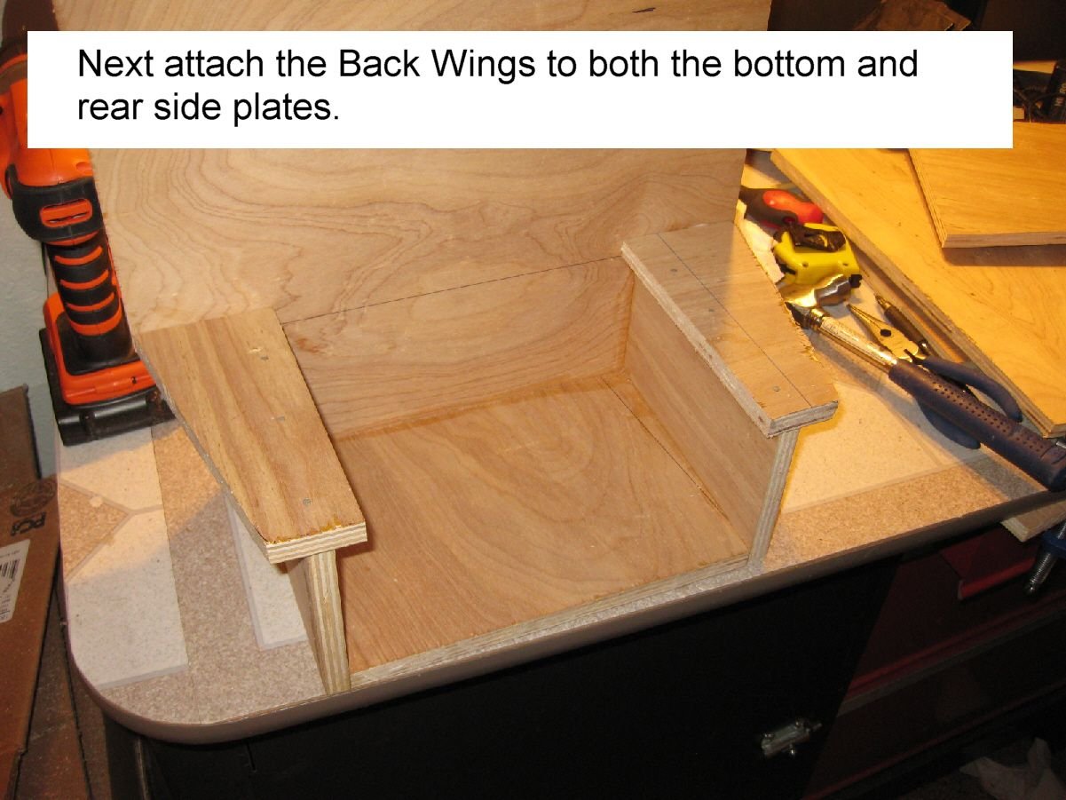

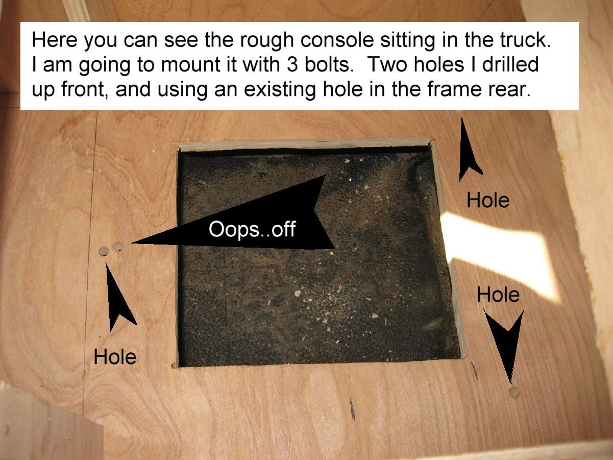

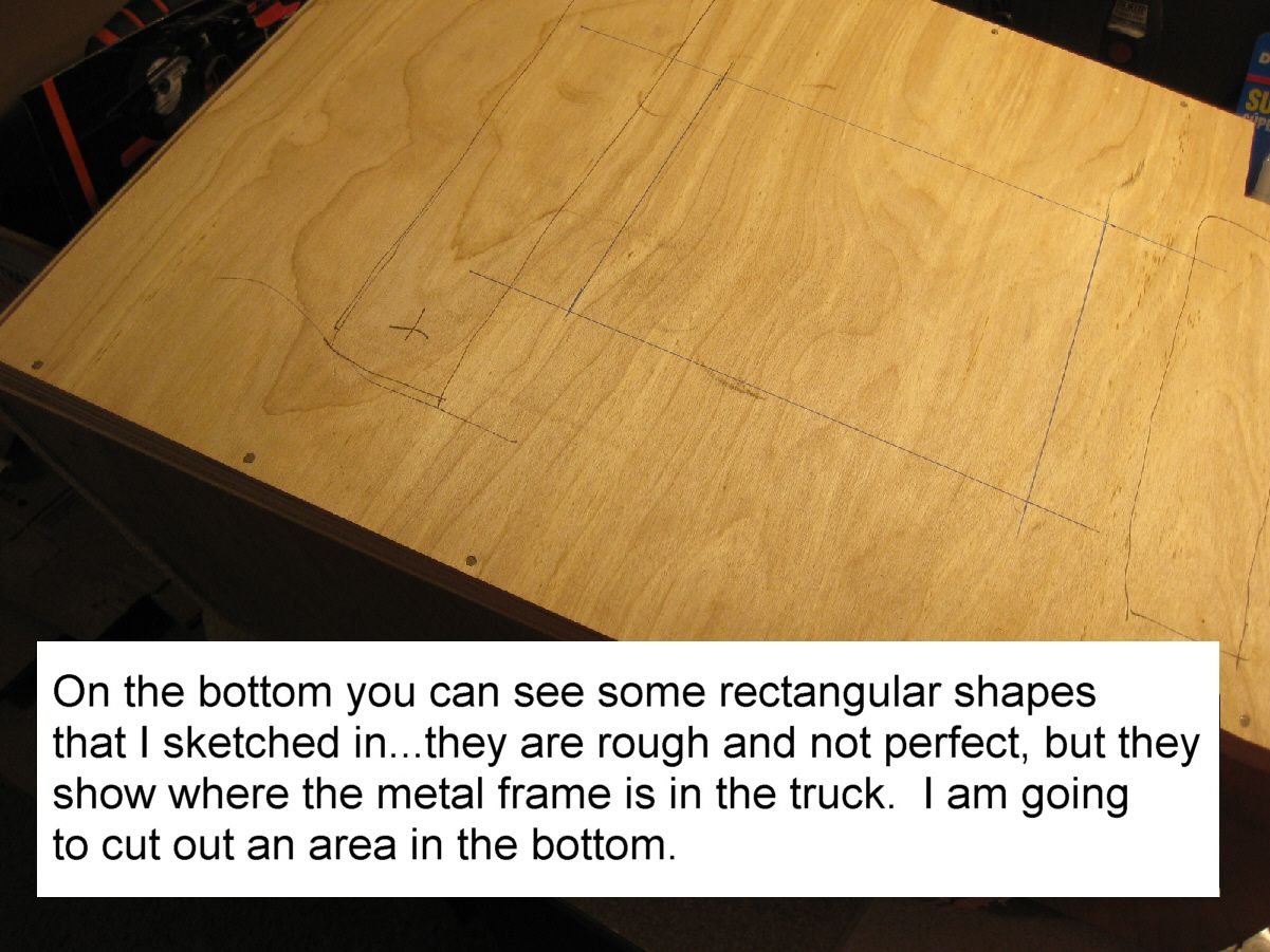

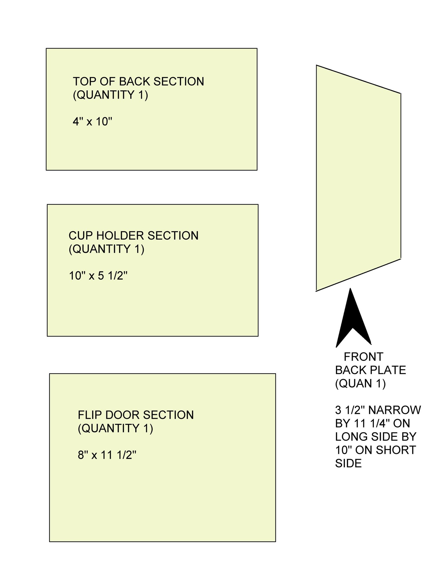

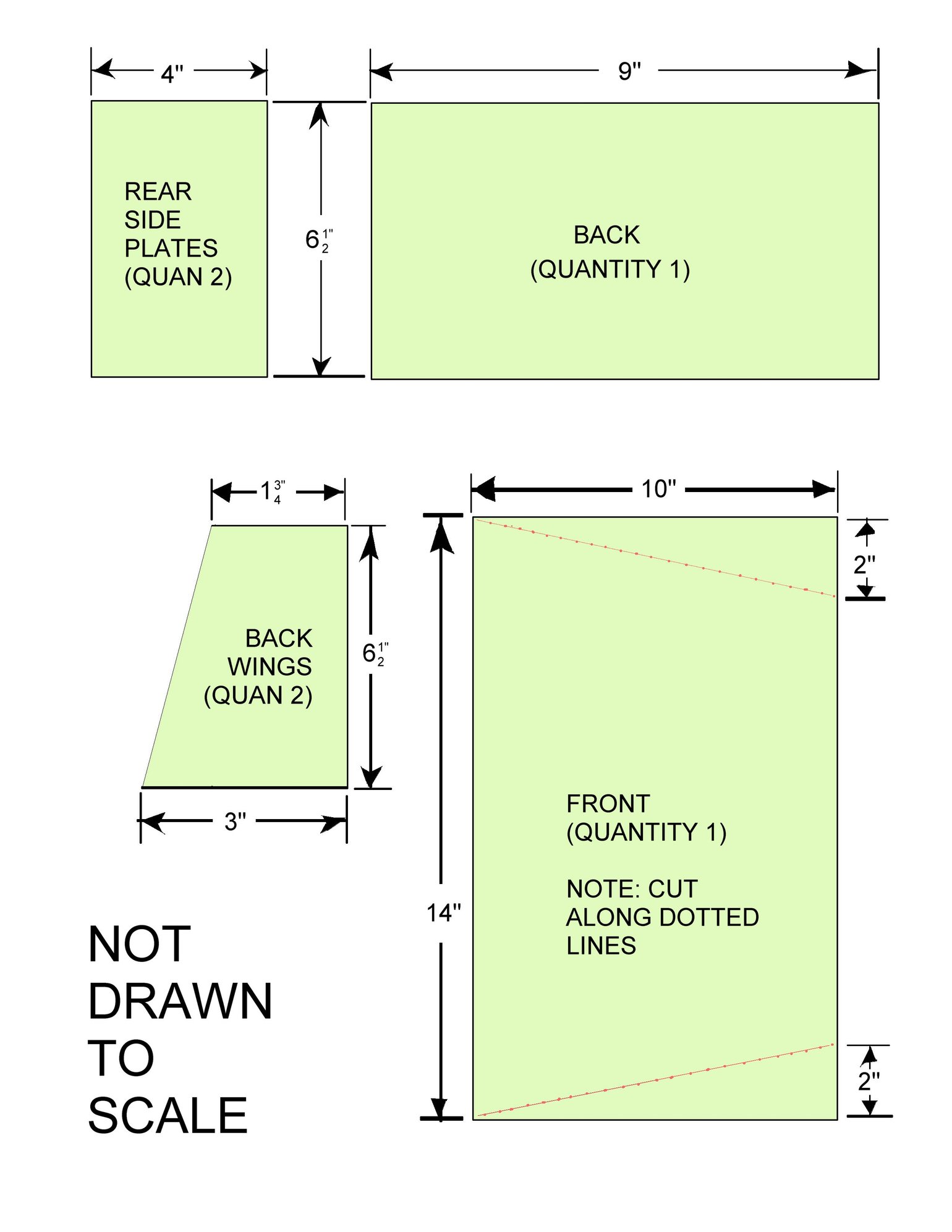

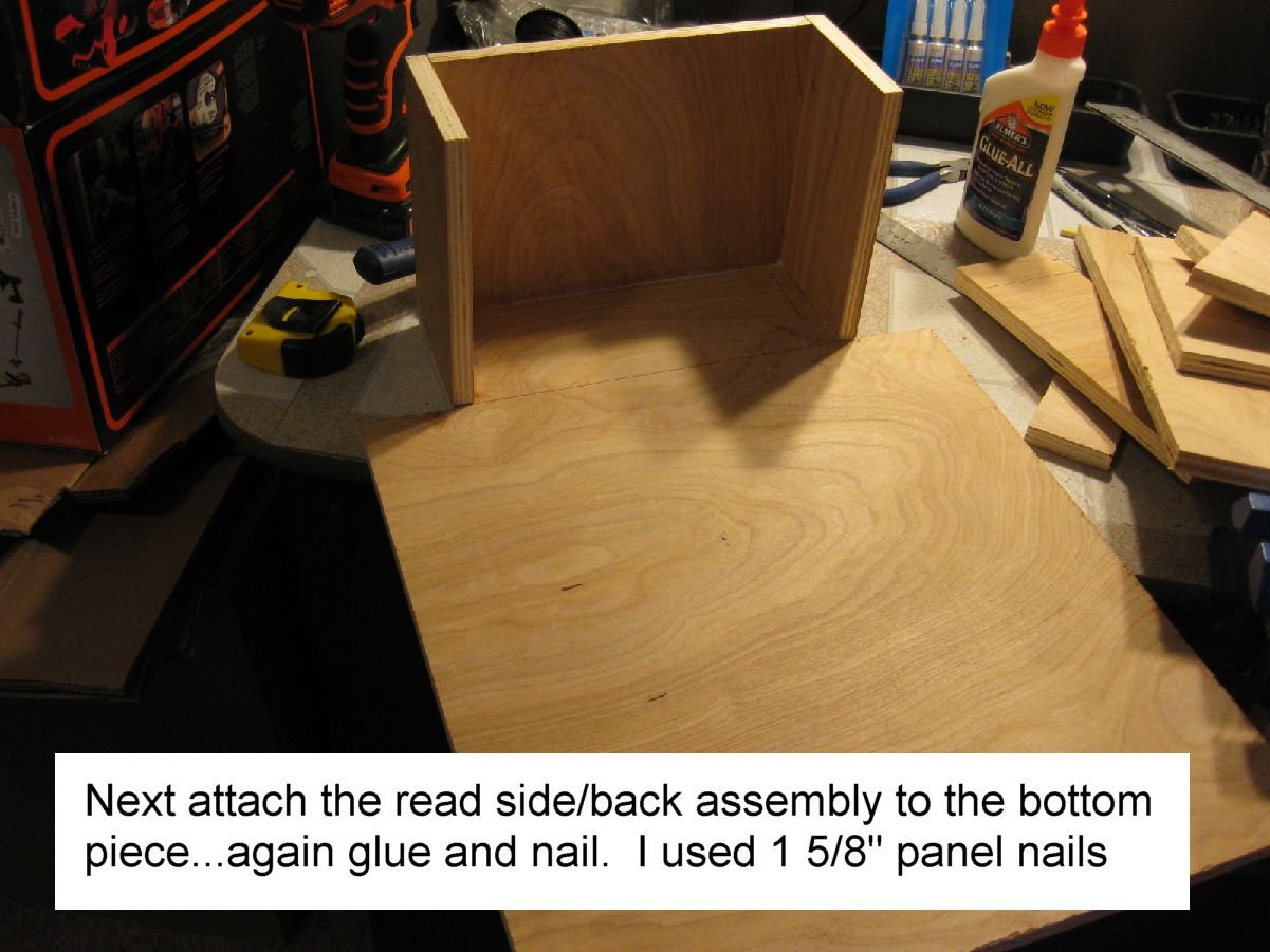

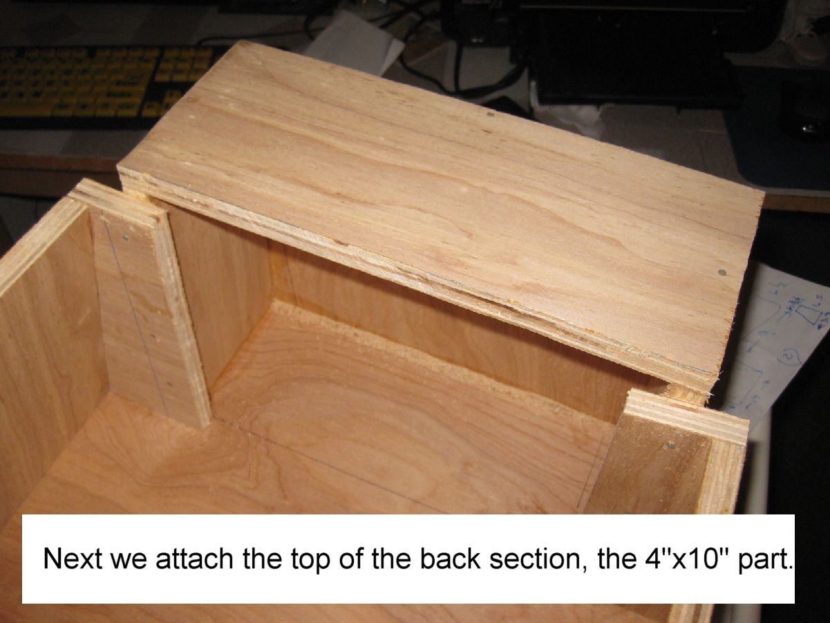

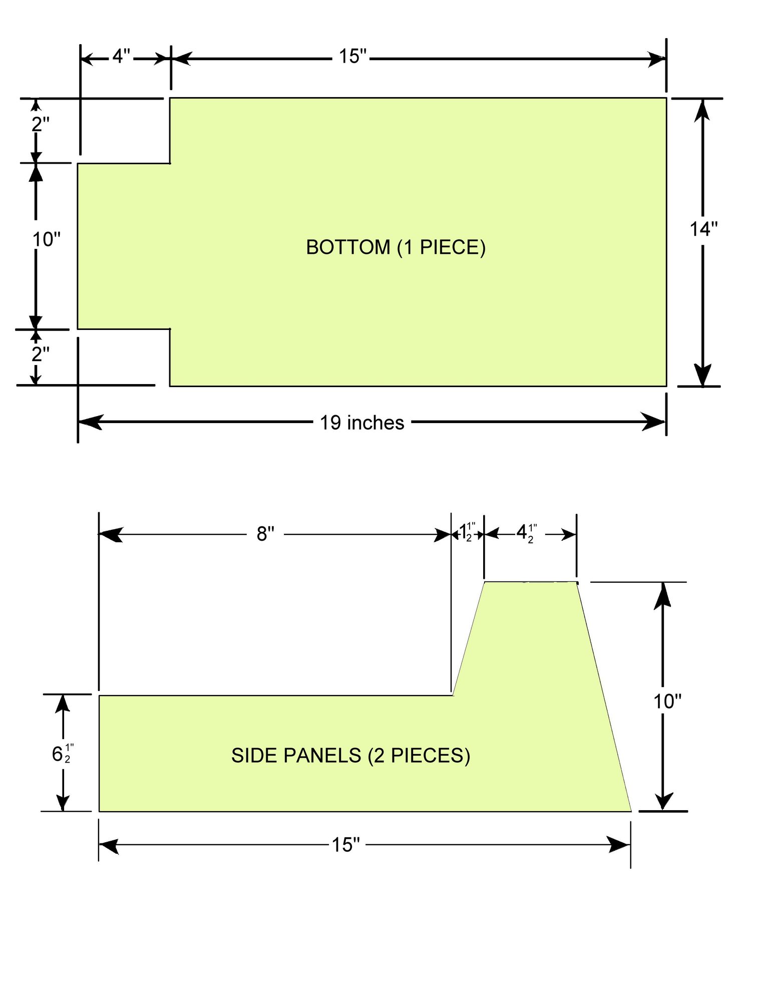

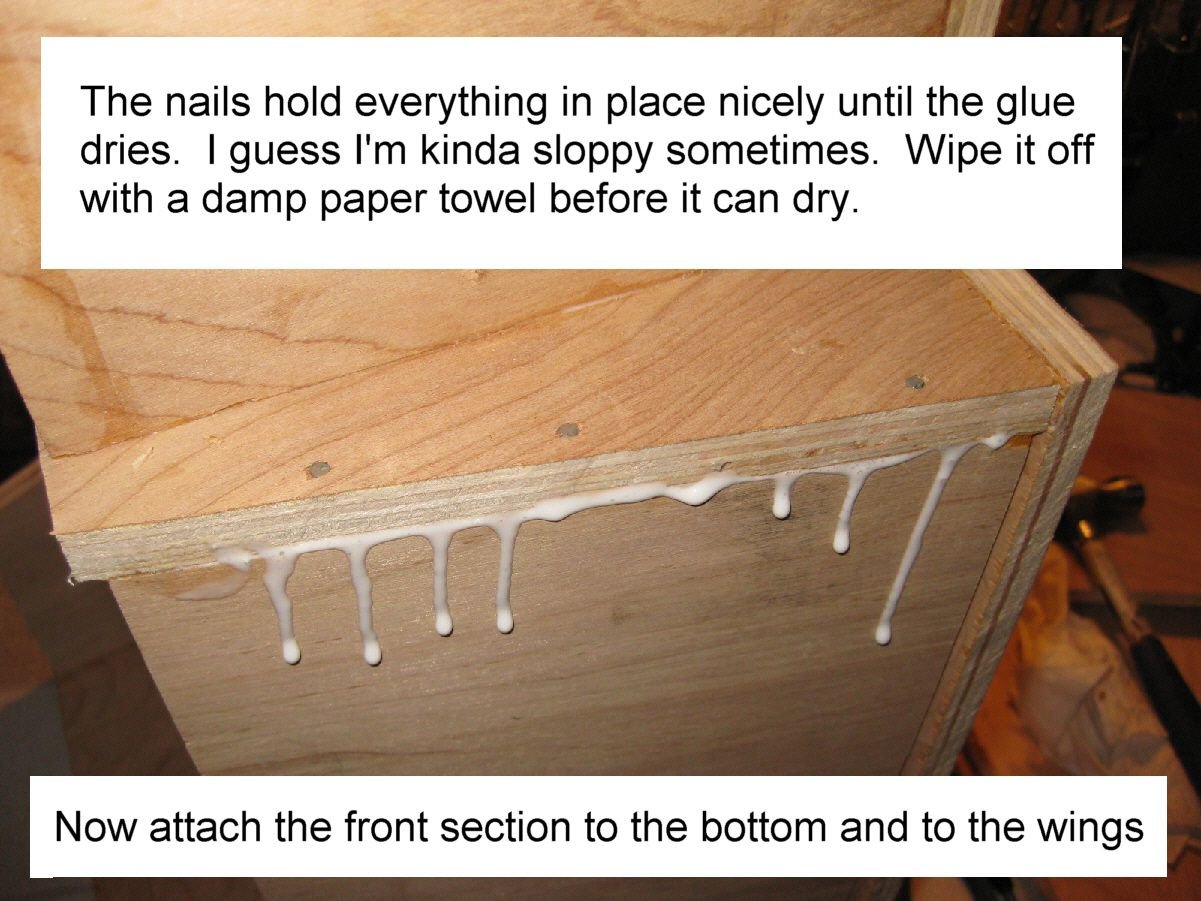

With that all said, here are the plans and the steps I performed to build this console to date. It's not complete yet, but I will post the final pictures once it is done.

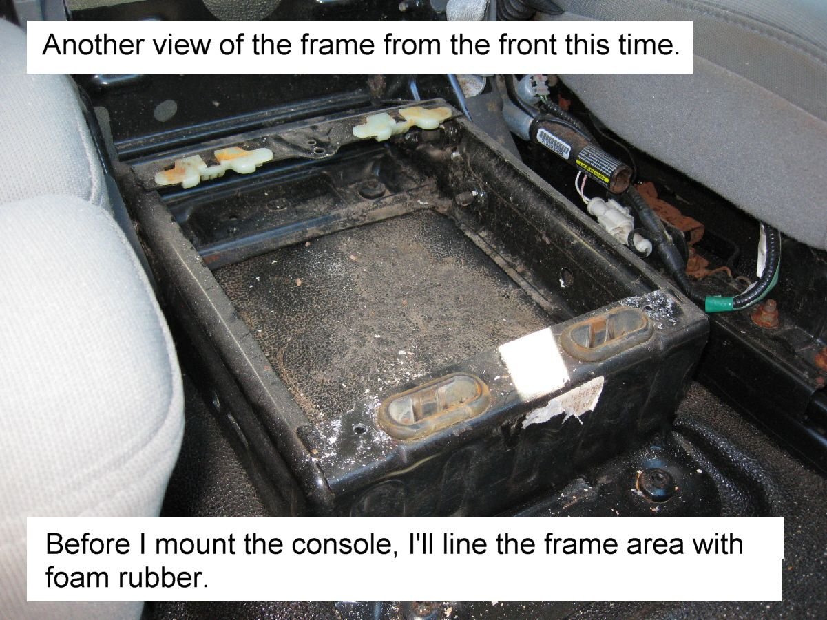

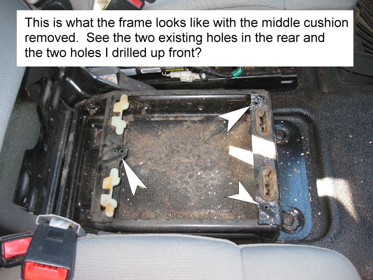

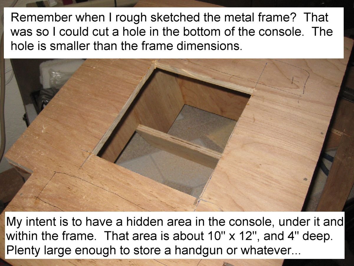

Well that's it so far. I just got through rounding all the edges so when I glue the vinyl on it won't tear. I also cut foam rubber and glued it in place in the metal frame in the truck so my "hidden" pistol won't rattle around. I also just got through running a power wire from my radio to the console under the rubber floor mat so I can hook up my accent lights. I chose the radio because I wanted it to be a switched connection.

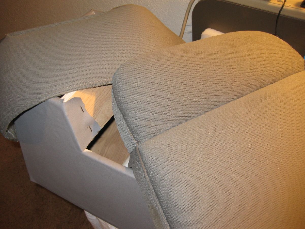

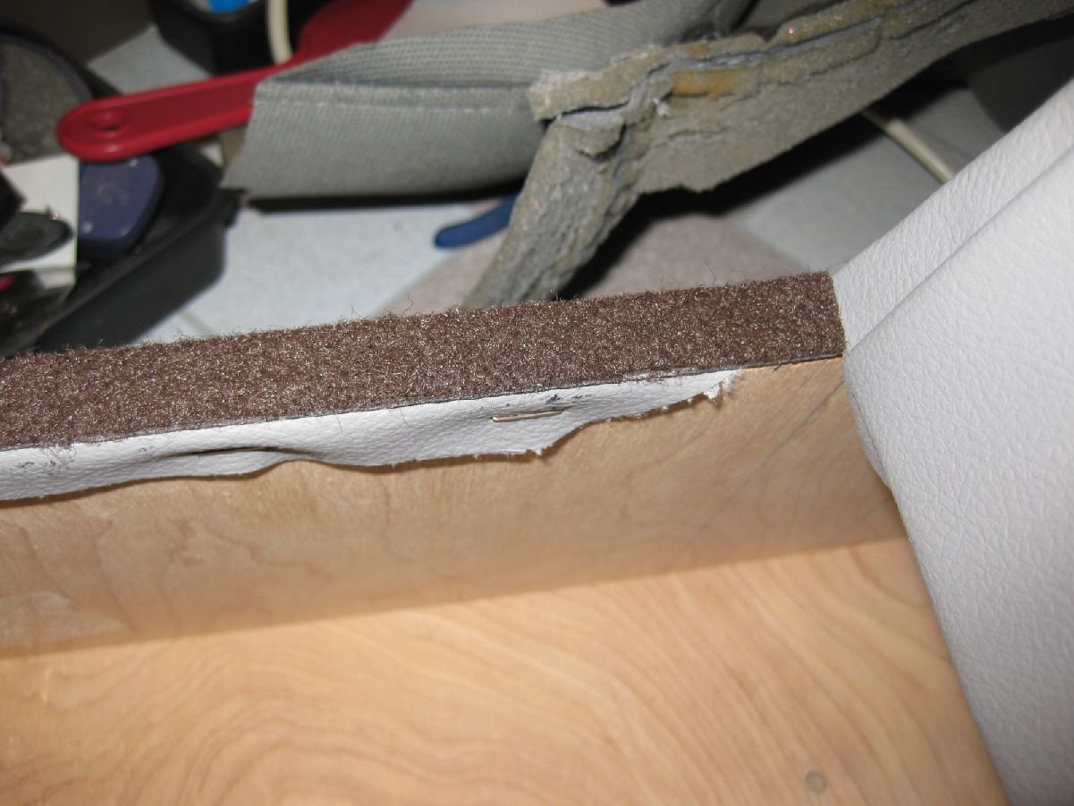

Since I never will use the seat again, I pulled the covering off the cushion and you can see it next to the vinyl. I plan on using that material to cover the hinged door to kind of integrate my console with the rest of my cab.
In this picture, I have smeared glue all over the wood and have tacked the vinyl in place with staples...you can see the glue tracks and such under the vinyl...kind of ugly.
The key is to use a big spreader and smooth the vinyl down, forcing the extra glue to the edge and cleaning it up. After I did this, the console looked really smooth and flat.
This picture just shows how I covered the back area. I just folded some edges down and stapled it in place after glue again. When you cover your own, it is almost impossible to do it without seams...wish they had a spray on gray vinyl...then it would be perfect...but still it is okay.

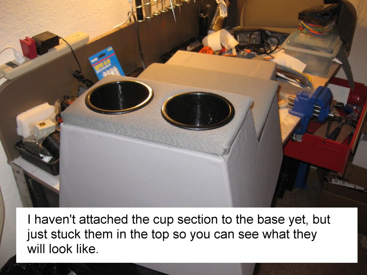

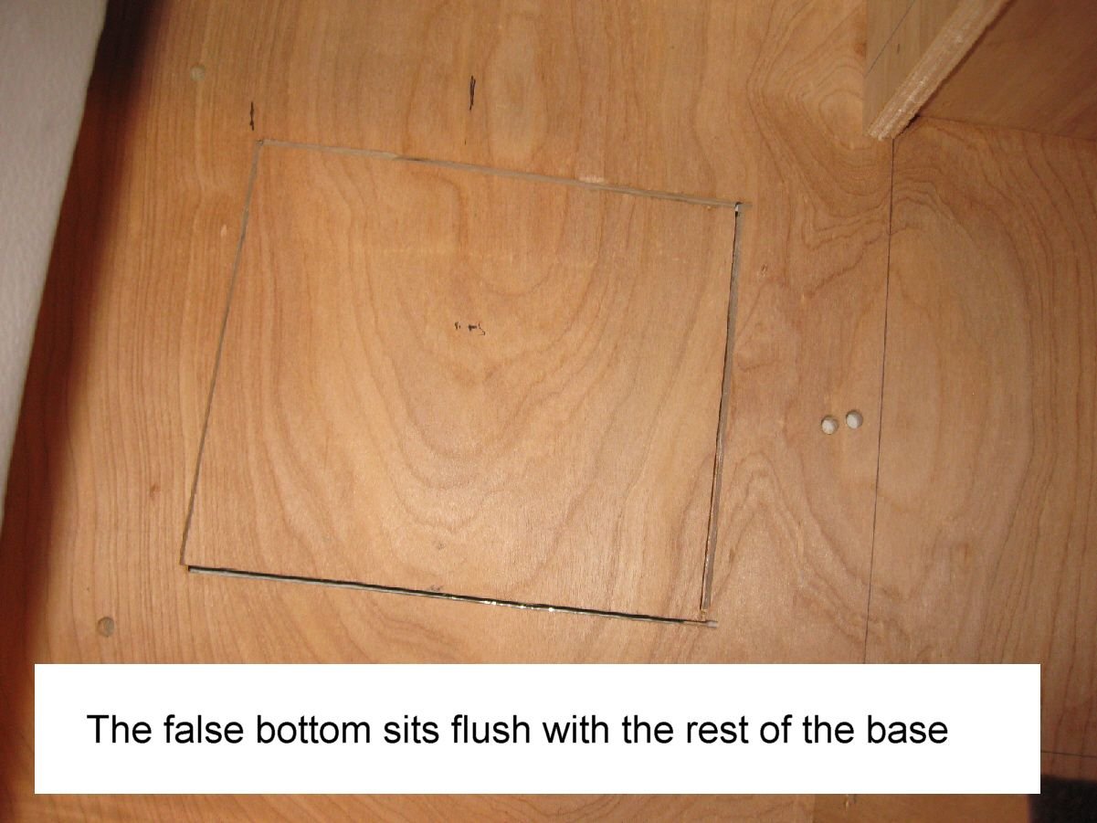

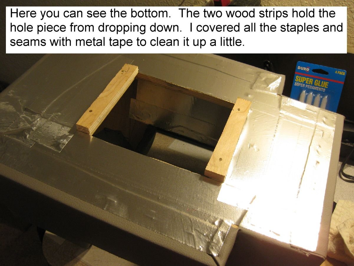

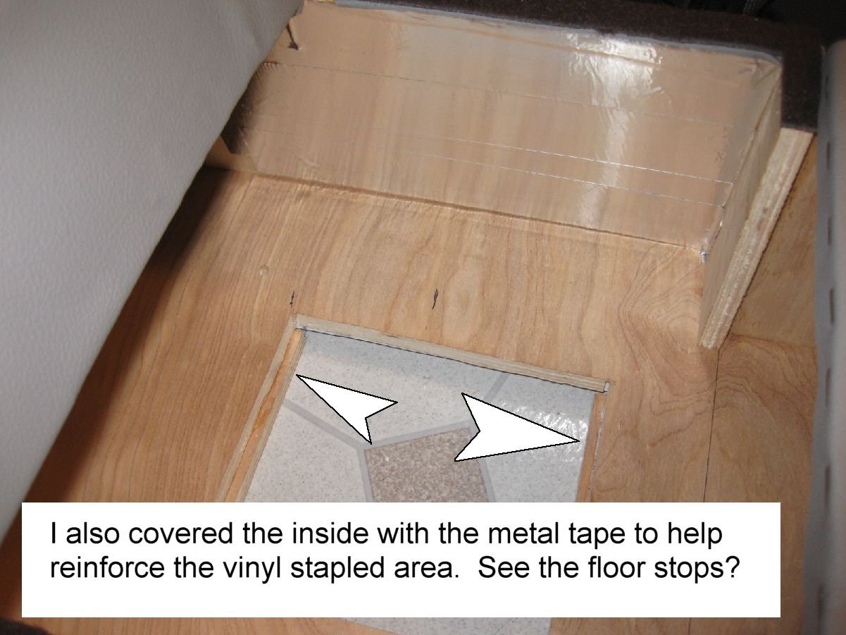

Okay, got the cup holders today, bought a 4 inch black piano hinge and mounted the lid. Cut the wood holes for the holders and finished that area off. Also put on the wooden stops to keep the false floor from dropping through.
I still need to permanently attach the cup holder assembly to the console and am still awaiting the recessed LED accent lights to install and hook up. Here are the pictures...after this I will post one final pic when I am all done showing the console in my F-150.

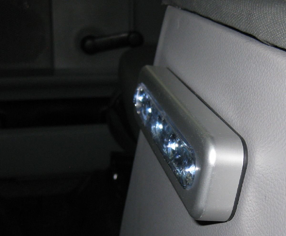

The lights are meant to run on 3 AAA batteries in series...which is about 5V DC. So I had to use an adapter, 12V --> 5V under the cup holder. They turn on when the truck starts, they turn off when I turn off the truck. I thought about installing a switch...but didn't want to mess with more drilling in my console creation.
