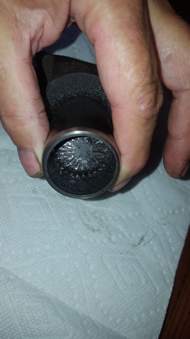

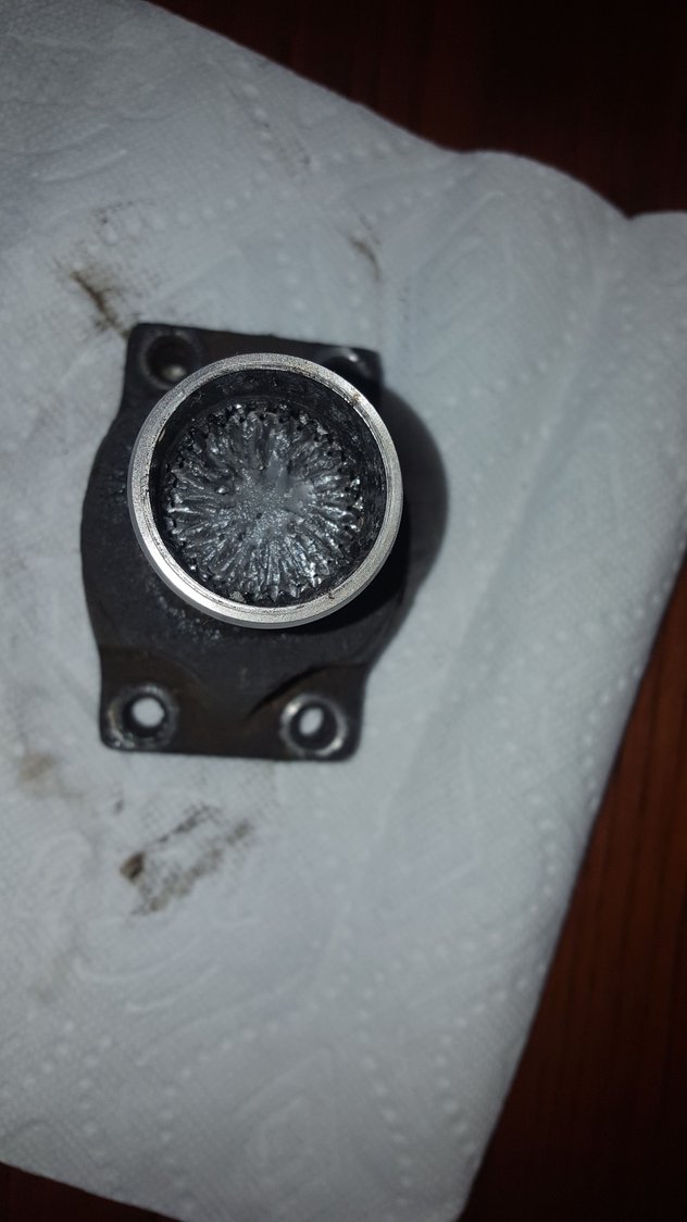

Welllll….just got back from pulling things apart - everything was in good condition...EXCEPT....when we unhooked the front U-joint, the yoke pulled out of the tailpiece. Yup - tailshaft broke off cleaner than clean!
Question - can that shaft be replaced without tearing into the transmission itself? How hard of a job is it? I have a broken down USMC vet, with a bad back, bum shoulder, fake knees, and deaf in one ear (me), and an Amish mechanic.....
Pictures? I'm still not convinced the shaft is broken.
Does the rear driveshaft have a slip joint, or it rigid end to end? What you've described sounds more like a slip joint at the transmission.

I will get a photo, but I am POSITIVE the shaft is broken! The nut is still attached to broken shaft in the yoke, and the yoke is sitting on the dining room table, being stared at by my wife......

Yoke
broken splined shaft inside yoke
another look at broken shaft
This is the yoke that slides into the tailpiece at the rear of the transmission.
Oh sure, but let's define "broken"...
