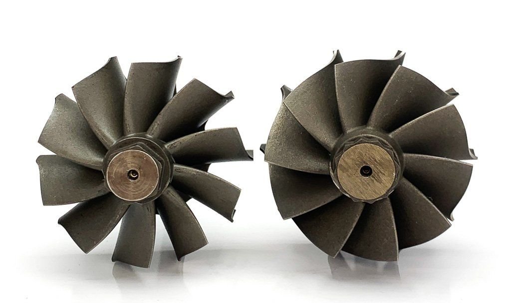

Looking to rebuild our turbo while it’s out. Was thinking of the following but wanted to get some opinions.
KC s300 wheel with the RR billet compressor turbine.
360 degree bearing kit
misc seals
I can get all this from riff raf for approximately $500.
What do you guys think of that? Are there other combos that you think would be better? Looking to keep the stock housing and stuff. Not trying to go crazy with it but I wanted to upgrade it. Plans are to put on an intercooler, add stage 1/tunes to go with the T500 we added. Not making a racer but just something that has a little more giddy up.

I was in your position about 6 months ago. I tow alot, about 13000 pounds of camper and jeep every other weekend in the summer. I have a banks intercooler and baby swamps injectors. The truck towed great however in the summer you really had to watch the EGT gauge. On a long hill with the stock turbo and 1.0 housing 1100-1200 was easy to hit. Not wanting to go crazy with turbo upgrades, and having to reseal my intake plenums I decided to give the KC kit a try.
My first impressions driving around town unloaded were Meh at best. boost was lower and there was not visible gains. The difference showed when I hooked up the trailer. EGT's towing on the east coast are around 950 degrees to 1000 when really pushing hard ( pulling hills with the trailer at 70 ) I didnt notice any difference in spool up time, and overall boost is a tad lower than the factory wheel. you may be thinking how does this help me if boost is lower, its all about volume of air.
I recently got back from a cross country trip ( connecticut to cali and back 6000 miles in 2 weeks)The kc wheel in my opinion made all the difference. climbing the eisenhower tunnel fully loaded I was able to do 40 with 22 pounds of boost most of the way, egt's were still 1100 degrees by the top; however I was able to hold it much longer
Long and short if your not towing alot, you wont see any real benefit

KC 300 wheel on exhaust side is wider and blades are deeper.
This is going to drive the compressor more consistently.
TJLongworth, what compressor wheel do you have?
