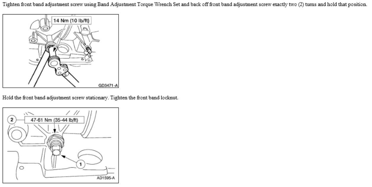

I am not sure about those types of scan apps or tools, just personally never had a need for them. The scanners we use at the shop are for the professional auto service industry and do all kinds of diagnostic things including lab scope and programming.. I do have a Autel handheld scanner that I was told does retrieve transmission codes and I have found that it does retrieve some but it also fails to list them all. LIke if I scan a vehicle with the Autel and get one code I will go back and use the big Snap on scanner and find three, so I never fully trust it and I paid almost 300 for it.
To check the adjustment of the OD band you will have to hold the inner adjustment bolt still and loosen the outer 3/4 jamb nut about a turn. Then hold the jamb nut still and turn in on the adjustment bolt, it should tighten up around two turns, if it keep turning in after three turns the band is probably broken. If it does tighten down back it off two turns and then tighten the jamb nut down while holding the adjustment bolt still.
A torque wrench is preferred but not necessary just dont over tighten the adjustment bolt, use common sense.
Here is a diagram that I found to show location and the procedure. This is located on the driver side of the transmission, the front adjustment bolt is for the OD band which is responsible for 2nd and 5th gears, the adjustment bolt towards the back is for the intermediate band that is responsible for 3rd gear.
