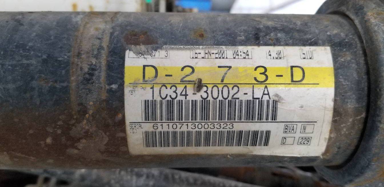

I had mine up on a lift last night to change the oil, so I took a good look around on the axle trying to find numbers and found nothing. I did find a tag on the diff cover but couldn't read the numbers very well. But I found a paper tag on the back of the axle tube. I punched the number into google and it came up with another forum and they said it was a D50.
The numbers I ran were the 1C34-3002-LA
I also found that the d60 wasn't installed in the F250's until '03.
I've been trying to find out which axle I have as well as I need to replace the inner seals. Mine has a slow leak.
