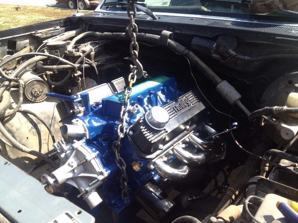

fresh built 302 so pretty
That’s the best picture I have of them
