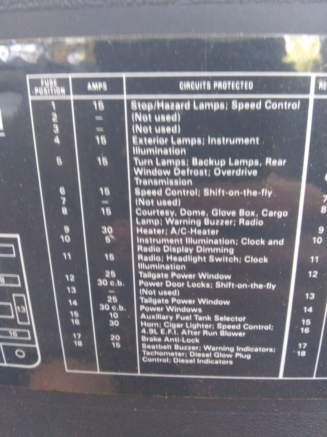

Fuse #8 is for your dome, cargo lights and warning buzzer
Fuse #11 is your radio Fuse and should be 15 amps
But anyway you may need to either trace the radio wires back to the source and correct anything that is not right or abandon them altogether and start over. Physically run new 12 volt hot (through a fuse) and a new ground to the metal frame of the truck.

Byronbgs, connected aftermarket radio to wires out of harness for original radio. Did poke around with a volt meter, one was constant hot, one was switched. Thought I had the right ground. Fuse number 8 and 11 are both related to radio.

This is the fuse panel diagram on the truck and the connections I used when setting up radio.
Constant 12V+Green/Yellow
Switched 12V+Yellow/Black
GroundRed or Black
IlluminationBlue/Red
Dimmern/a
Antenna Triggern/a
AntennaRight Front
Front Speakers6" Doors
Left Front (+)Orange/Green
Left Front (-)Black/White
Right Front (+)White/Green
Right Front (-)Black/White
Rear Speakers6" x 9" Rear Corners
Left Rear (+)Pink/Green
Left Rear (-)Pink/Blue
Right Rear (+)Pink/Blue
Right Rear (-)Green/Orange
