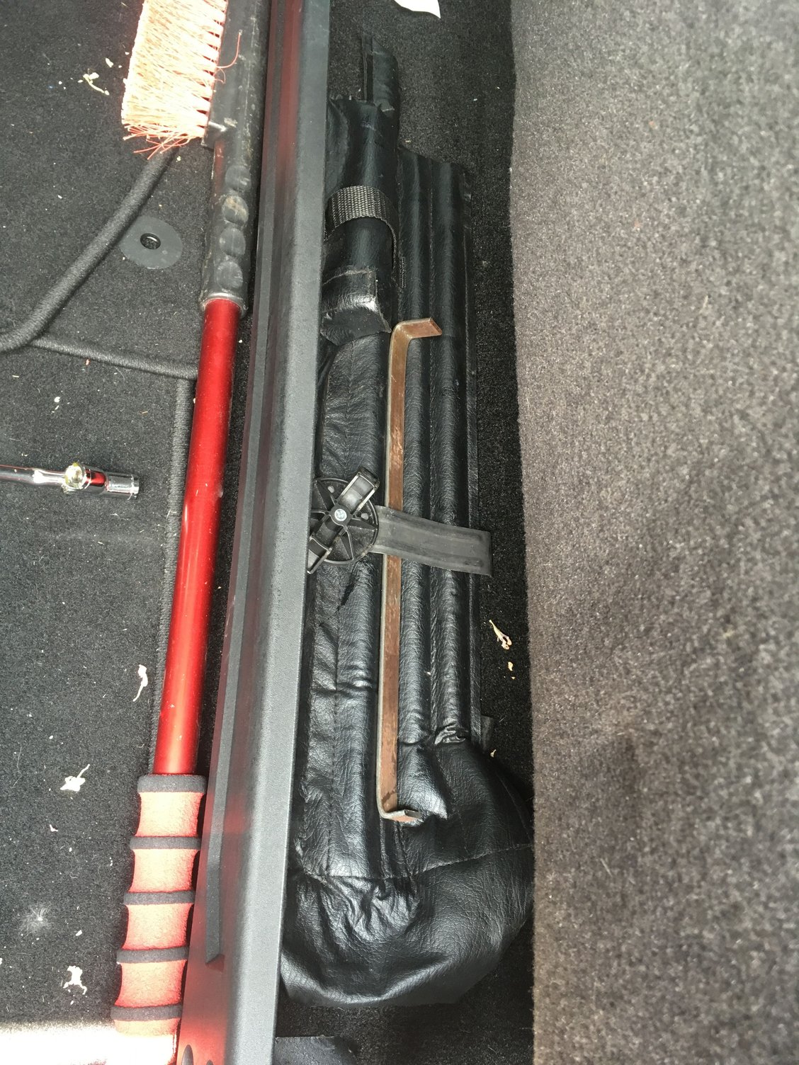

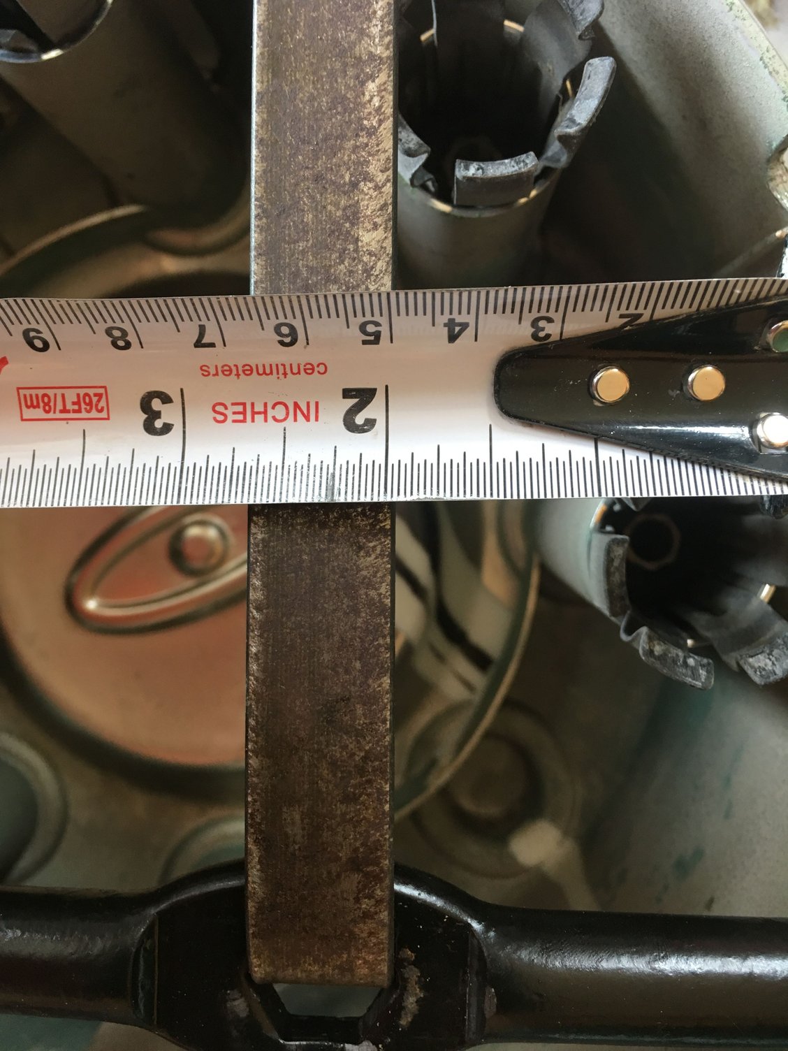

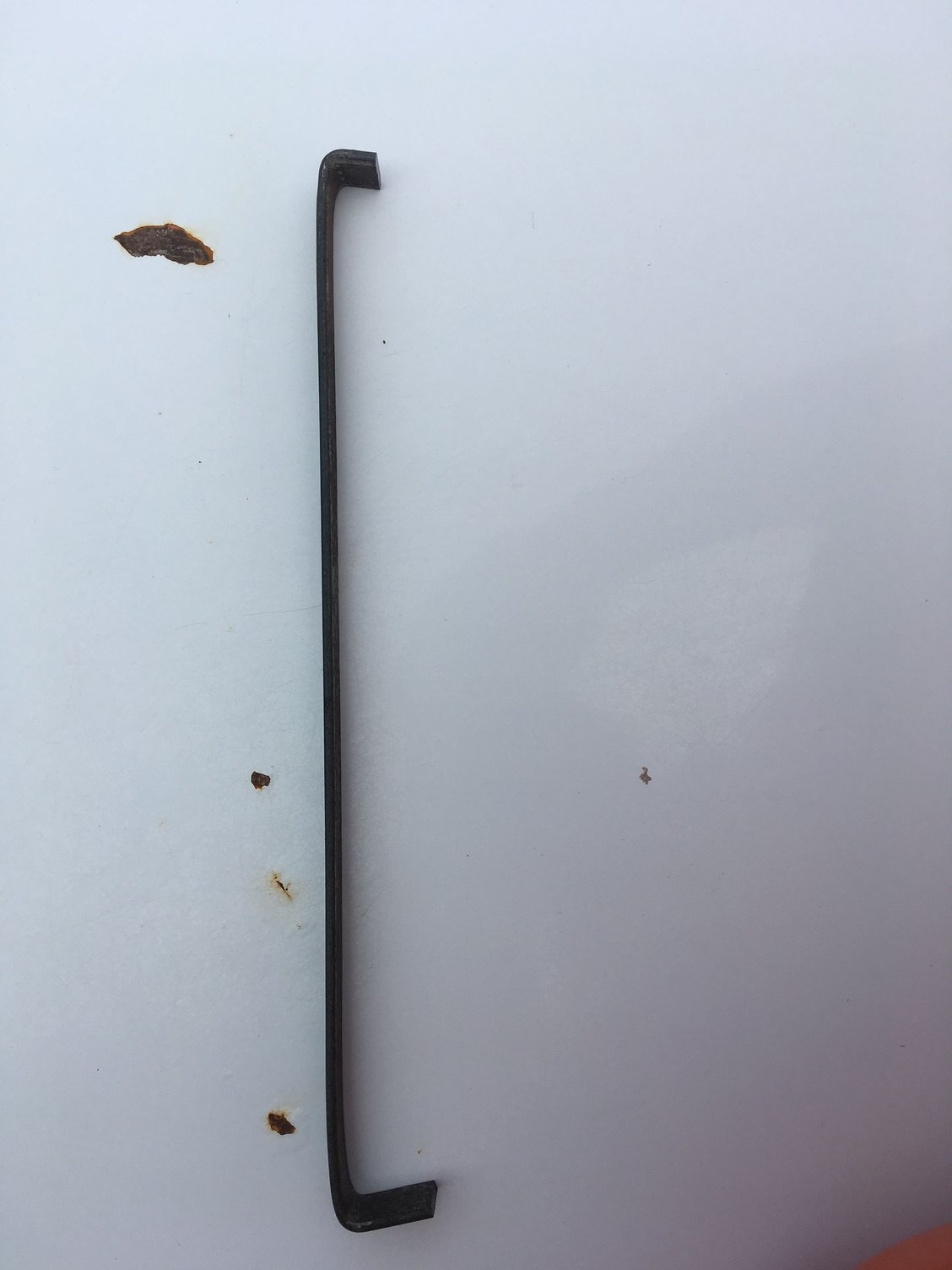

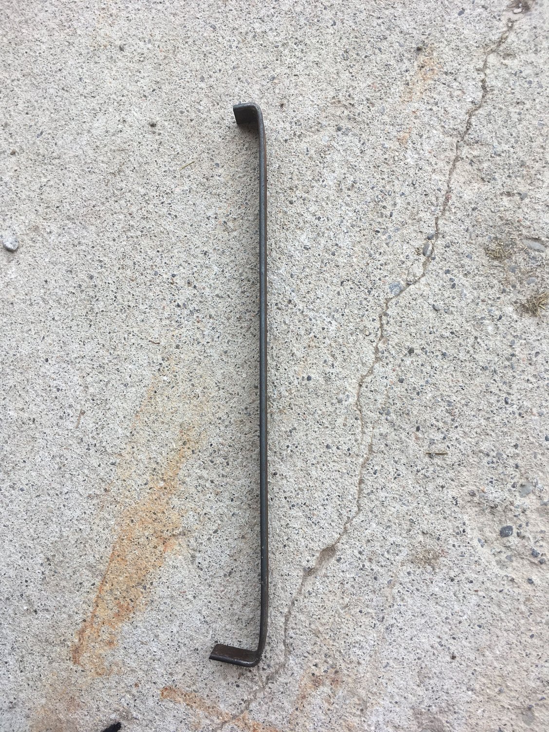

Hi guys After seeing the tire shop struggle to remove the center caps on my dually I became worried that if I had a flat tire on the rear that I wouldn’t be able to get the center caps off. So after reading several threads on the subject I came up with my own solution. It’s from a piece of 3/4” left over flat stock that I got from Lowe’s at one time. I bent the ends in a vice with a claw hammer. The 3/4 fits perfectly in the tire iron and the caps. One warning though don’t use the tire iron on its flat side, it will bend the tire iron from the pressure so use it sideways.
Piece I had was about 14 “ long before the bends

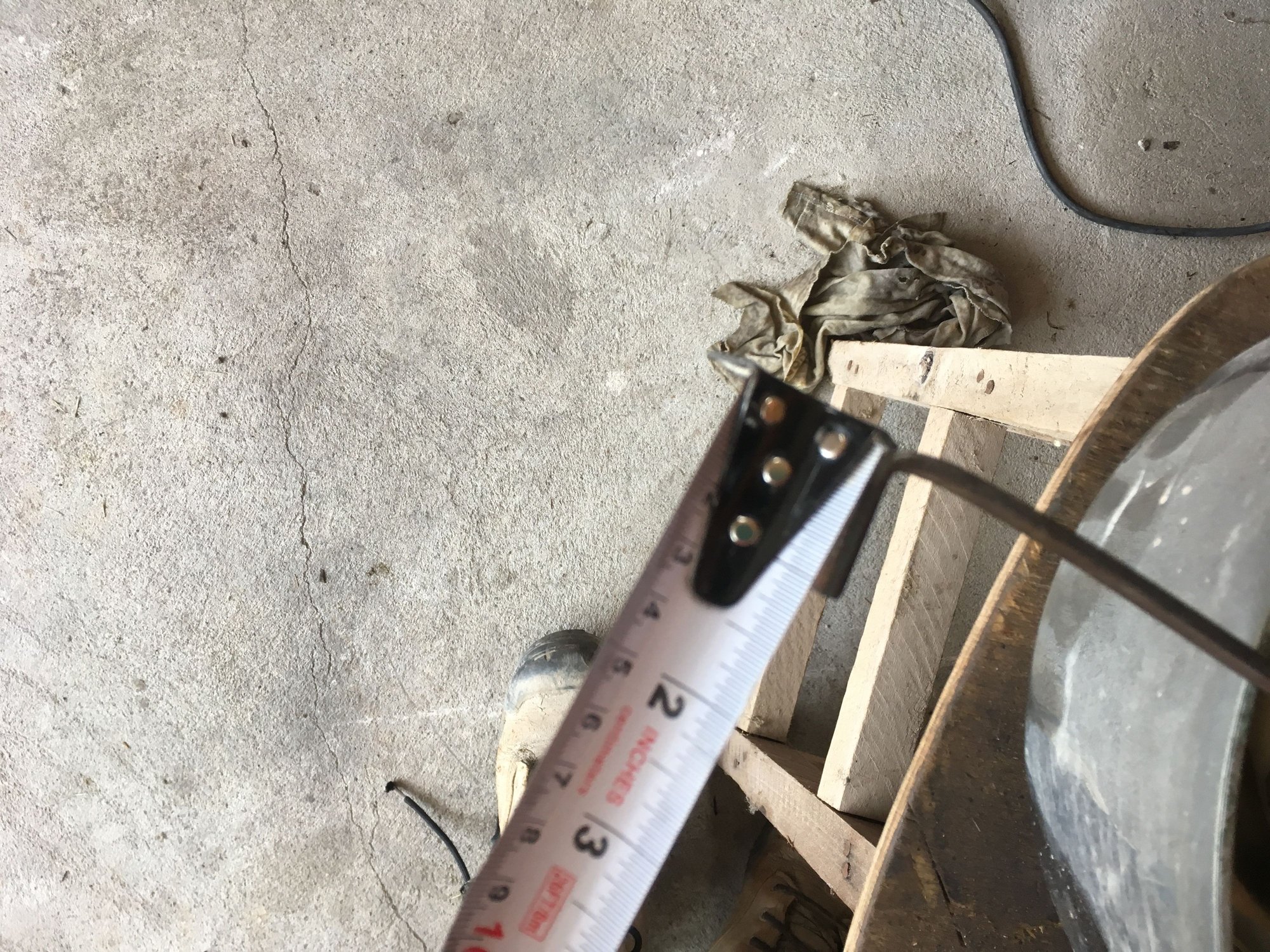

The hook that goes through the iron is about an inch long

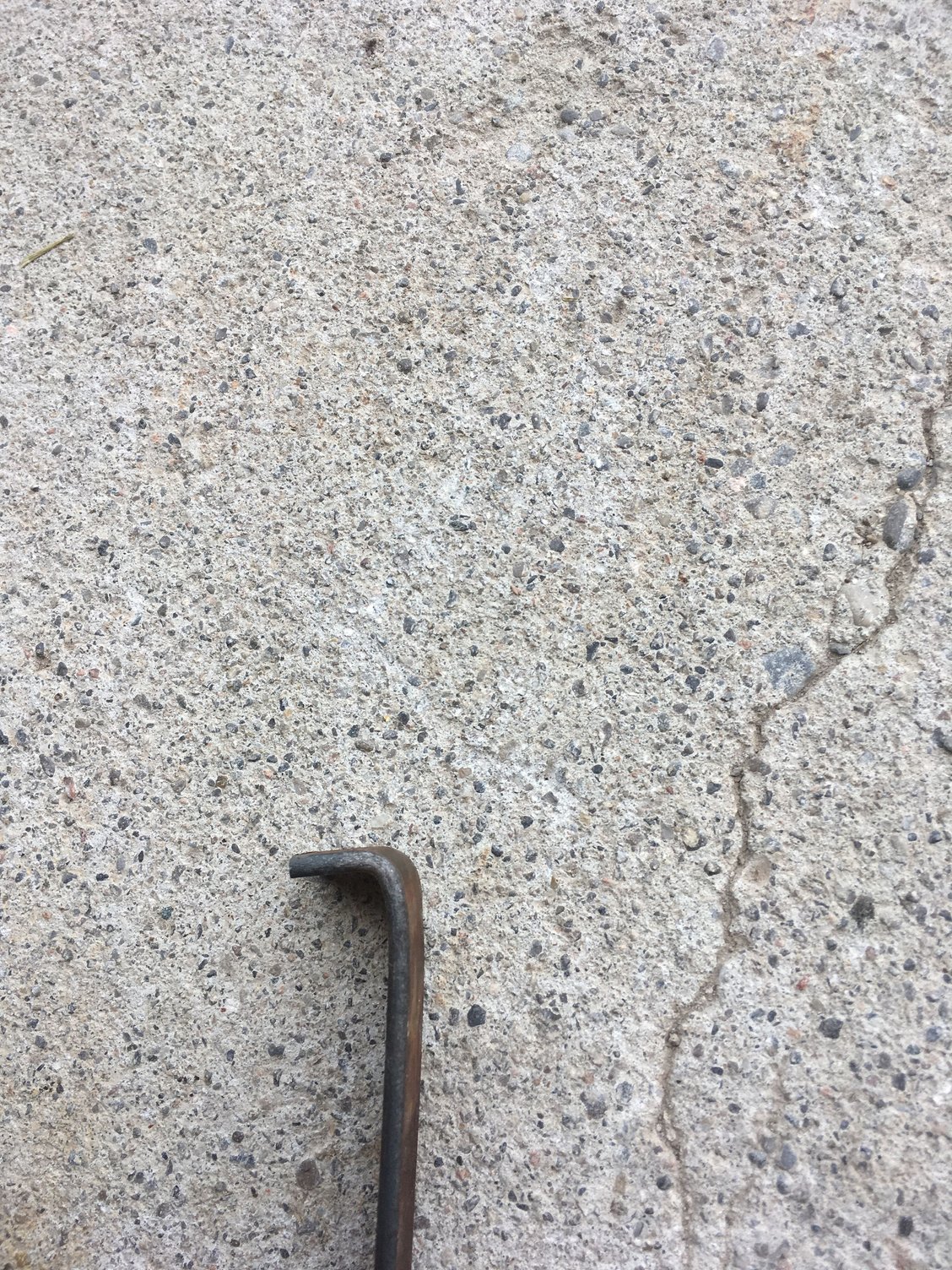

The short hook that goes through the cap is about 5/8” long
It’s 3/4 stock from Lowe’s or HD
Make sure the long hook goes sideways through the tire iron
Don’t use it flat or it will bend the iron
This is the method I used
Lean the hook side of the iron on the tire and pull on the socket end with both hands and it will come off easily with a good tug

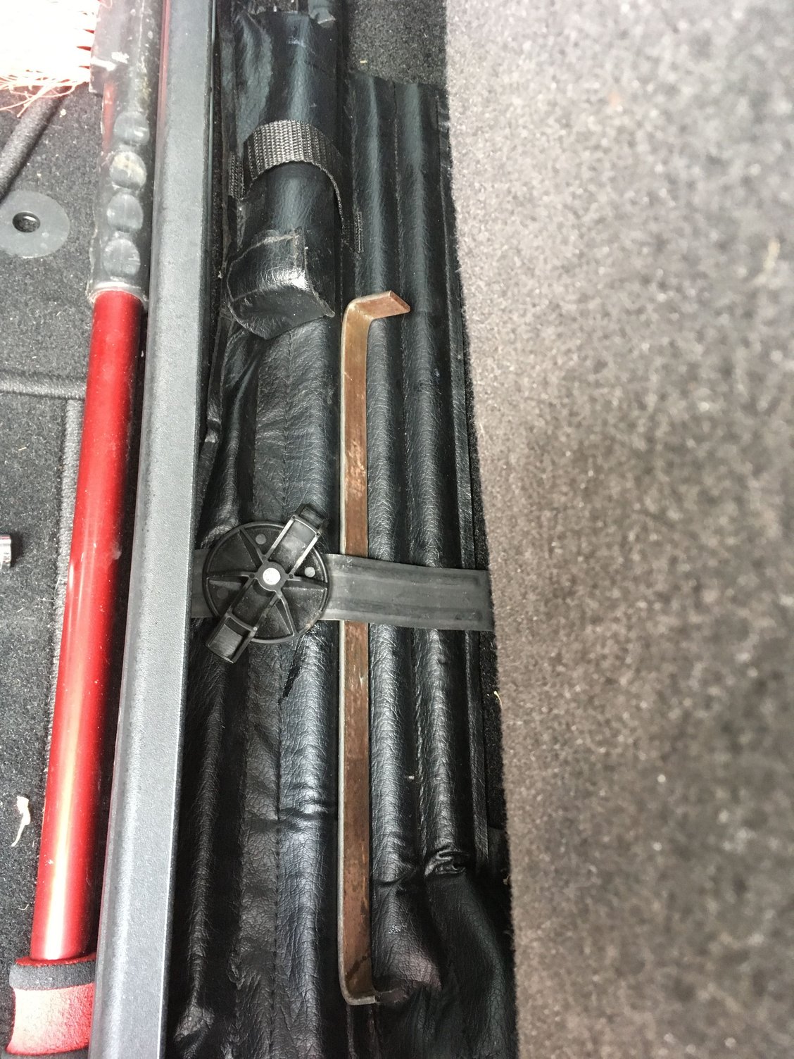

It stows with the rest of the tools
Stores well I may paint it and cover it with a rag to prevent the sharp edges digging into anything

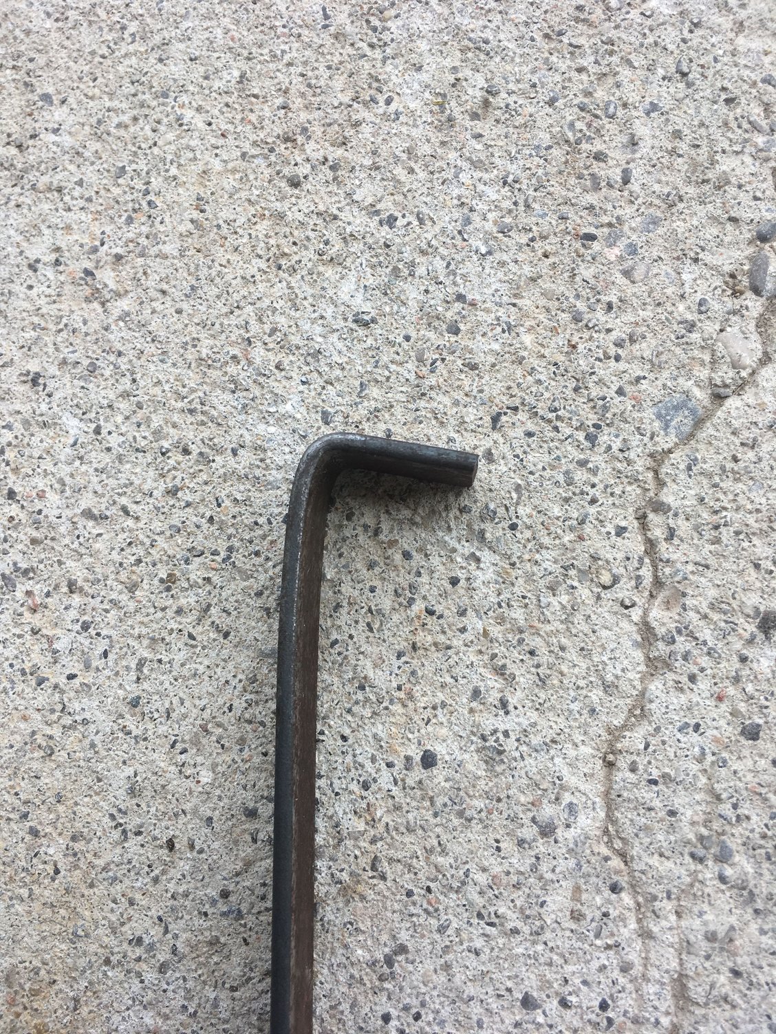

Another view of the long hook side
3/4” flat stock fits nicely in the cutouts.
Short hook

Very nice. And thank you for the pics.
I use a ratchet strap & the lug bar. Its a little safer for not slipping and scratching the center caps.

Where was this idea last week when I struggled for hours to get the center caps off? Ended up using a 4x4 and a ratchet strap to get mine off. I'll be headed to the hardware store today to get some steel. Your idea is much better! Thanks for posting!

Glad I could help! although a bit late. It only took about 30 minutes to make it.

I read on line somewhere about using a 2x4 to get the cap off. I used a 4' piece of 2x4. Just put the end down in between the cap and rim and lever against the cap. It pops right off. Easy and cheap.
