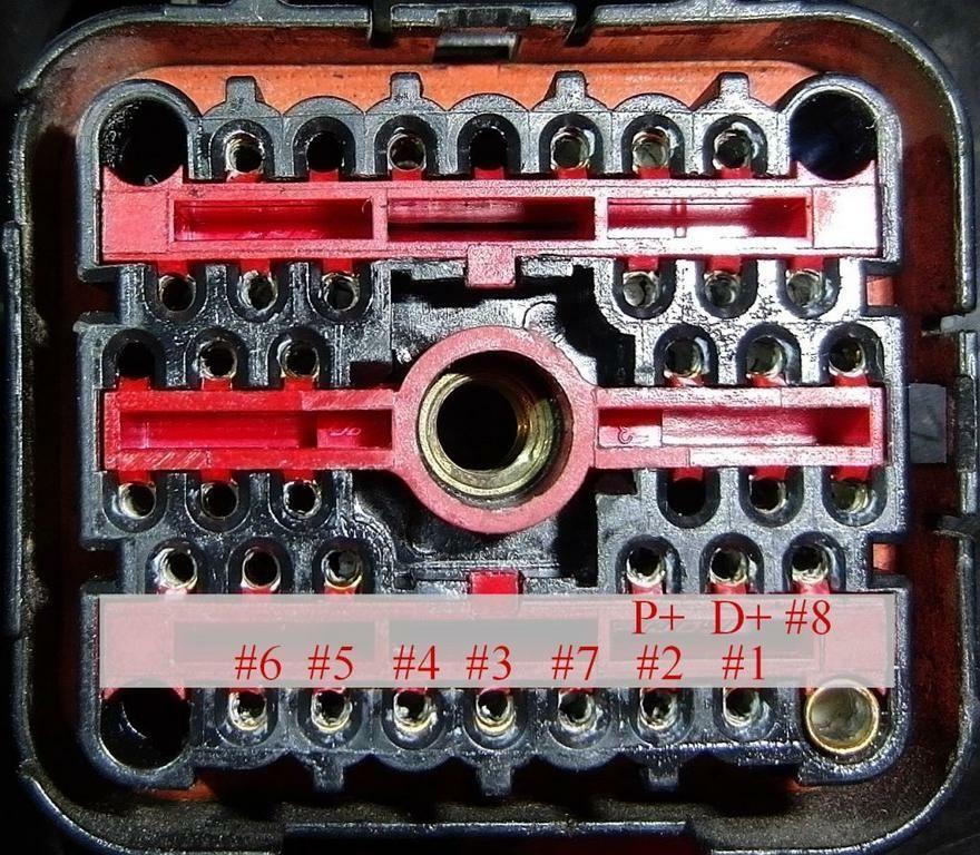

I decided to see if there were other tests to run while I waited and found a resistance test for the IDM circuit so I grabbed my multimeter and unplugged the IDM. I found A LOT of what I'm assuming to be dielectric grease in the plug...so much so that I grabbed my shopvac to pull it out of the pin slots. Numbers below.
Pin 23 & 22 = 5.2 ohms
Pin 23 & 7 = 5.2 ohms
Pin 23 & 19 = 0.23M ohms
Pin 23 & 9 = 5.2 ohms
Pin 24 & 6 = 4.8 ohms
Pin 24 & 21 = 61K ohms
Pin 24 & 8 = 4.8 ohms
Pin 24 & 20 = 7.7 ohms
Pin 23 & 26 = "O.L"
Pin 24 & 26 = "O.L"
Pin 23 & 18 = "O.L"
Pin 24 & 18 = "O.L"
So it looks like none of my numbers are in the range specified (2.8 - 3.6 ohms). So with the 4.8 and 5.2 ohm average I guess we'll call it, seems like the UVCH on each side has a bad connections? Possibly the reason the plug to the IDM was loaded with grease? The high value on injector #7 i'm assuming could just be from a loose connection on the solenoid connector?
For injector #3 and #6, does a high resistance like that indicate a bad solenoid? And if so, injector replacement? I'm assuming if the solenoid is bad then I need to pull them either way.

I thought you only need the standard license and it comes with it automatically. Just to avoid throwing money away and since you already have the idm unplugged. Check the ohms again at the 42 pin connector, if they're significantly different from the 42 pin connector to the valve covers then you can narrow down where its happening. Then check them at the uvch again before you go diving into valve covers....not that it's hard, I just hope you don't get good at it.
If still bad at uvch, then pull valve covers, inspect uvch and check the injectors themselves by unplugging the uvch. This could be as simple as 50 cent mod, or replacing uvchs.
I'd bet on just bad connections, but if you decide to replace solenoids, while you've got the solenoids off, check the clearance of the armature plates on the injectors to see how much clearance there is under the armature(should be around .004)
D+ == driver's side common. P+ == passenger side common
The UVCH is something like GP, GP, I, I, G, I, I, GP, GP
GP== Glow plug
I == Injector
G==Ground
I had an IDM go out with the same result, but mine was corroded and looked as though it had sat in a puddle of water for a while so it was a lot easier to figure out why. In your case, its good to make sure the connections are solid so you don't risk burning another idm out.
