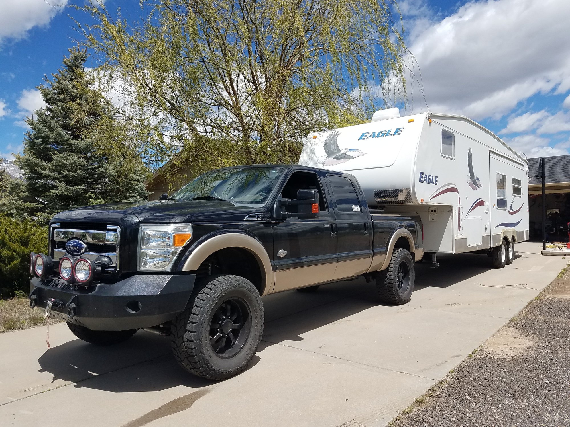

I am towing constantly with my truck. I have a 6 inch lift on 37" tires. I also have a 5th wheel. It most definitely can be done safely. I do have an adjustable 5'r hitch, and also have adjustable spring hangers on the 5th wheel. I did not flip the axles like most do to accommodate a lift, I simply utilized a different mounting hole for the leaf springs. It's a huge myth, that lifts kill any towing capability, I have driven lifted trucks over 30 years.

6" lift on 37's can be done easily.

Bone cover your eyes! It's a truck that looks nothing like it did on the dealer lot! The humanity!!!

Good looking set up there, Travis. Those tires really do not look like 37s at all. Wow...

I stand corrected LOL
Oh the Humanity
