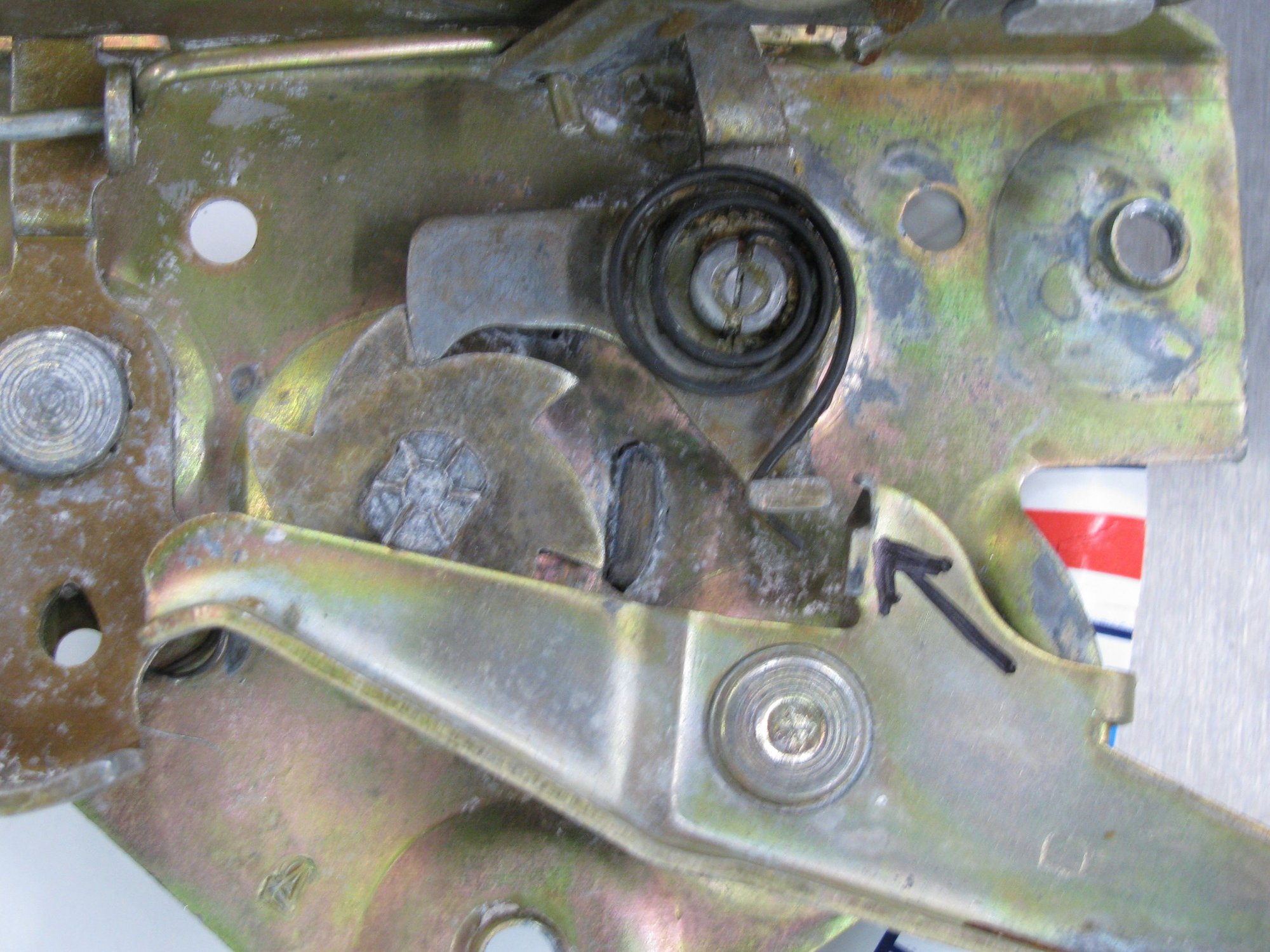

It's hard to tell in your pictures but the picture I'm posting may be your problem. Where the arrow is pointing is a bad wear point. If the wear is excessive like the one in this picture you will run out of travel in the button before it disengages the pall. Also worn to the point that this one is you cannot unlock the door with the key. You can weld that worn spot up then dress it off and get it working again.
Good eye, REP's for that one.
