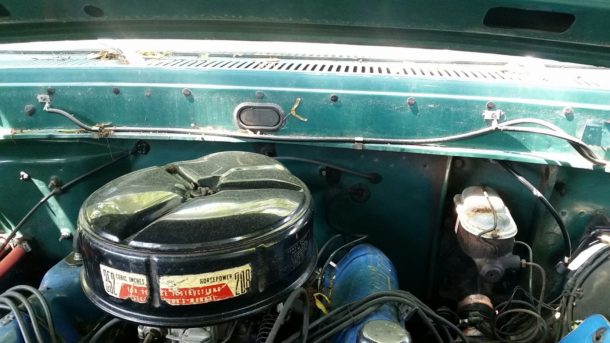

There should be two holes in the cowl, right behind the hood that the squirters fit into and come up between the slots in the cowl.
Similar to this:
Granted these aren't it, but similar:
My guess is maybe the washer was still an option back then? My '69 F100 has washers. My '67 F100 had them too. I know my '64 Galaxie doesn't have squirters.

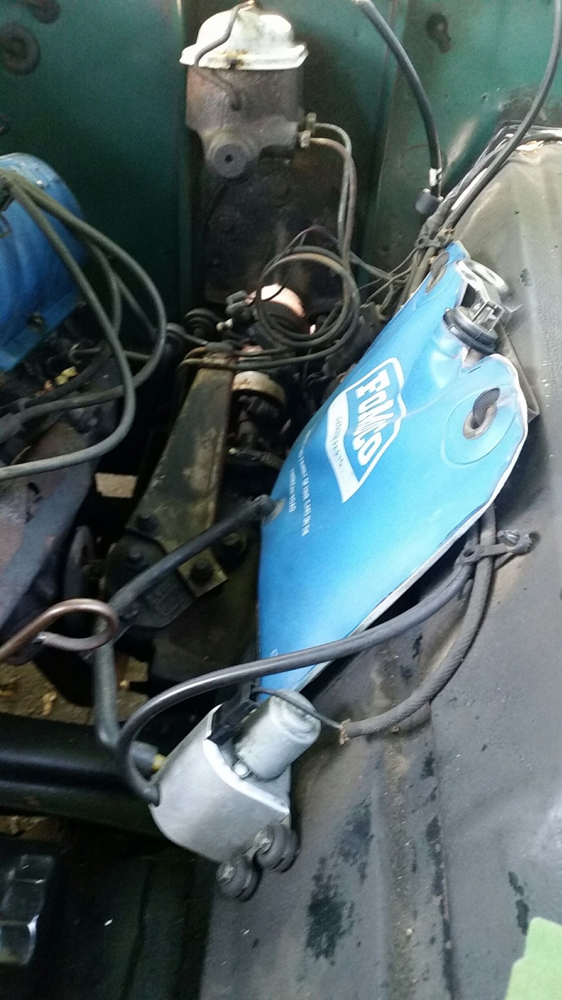

Here are some pics that might help from my 67 F100. All original except washer bag cap and hoses

my 67 had the external motor, bag long gone. replaced it with a 72 setup with the plastic tank and motor built in. had it from a parts truck
works good and everything in one unit. just a thought

This illustration is interesting ND. My 67 F100, built in Canada, does not have the nozzles in the hood as per the illustration, but rather in the face of the cowl as per my photos and similar to Freightrain's pictures. Do you think maybe different assembly plants had a different configuration?

Canada may have been different, or your truck has a dealer installed kit.
In 1967, the US Gov't mandated that light trucks had to have a left hand outside mirror, backup lamps, lap seat belts, heater/defroster, 2 speed windshield wipers and windshield washers as standard equipment.
But Canada may not have had any such requirements.
