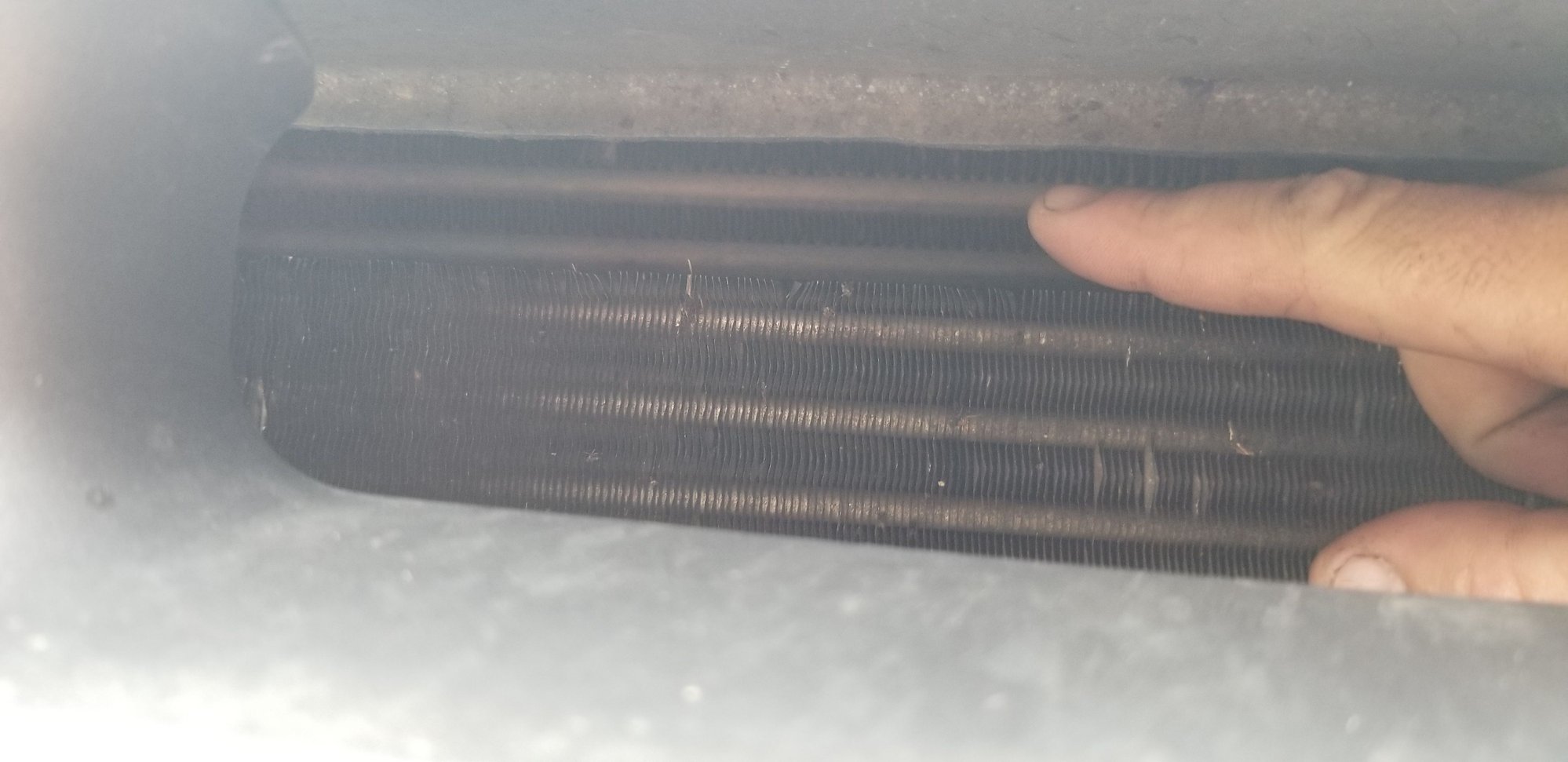

Here is what I was talking about in the earlier post. You can see how much intercooler is exposed once the flap is trimmed off. Took about 10 minutes to remove and trim it with scissors.

^^^.that portion of the cooler, now exposed to direct flying objects from the road?
Not really. It is the upper most part of the intercooler tucked behind the grill.
