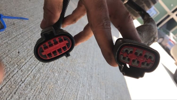

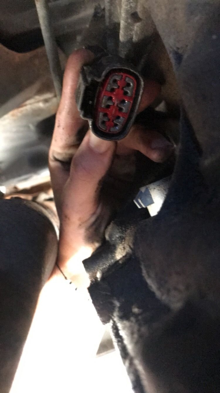

Connections...
What i believed was the solenoid pack connector.
Old Jul 10, 2019 | 07:46 AM
Lucas Frink's Avatar
Lucas Frink
Joined: Jun 2019
Posts: 20
The one on the right is the MLPS connection. The one on the left was what i assumed was the Solenoid pack connector...
Old Jul 10, 2019 | 08:15 AM
Redark1's Avatar
Redark1
Joined: Mar 2017
Posts: 228
From: Albuquerque
if i remember right the one in the last picture on the right is the solenoid pack connector. there both on the same harness too.

Yeah!
Thats what I assumed but the connection isn't the right one! Wouldn't plug in. So do i need to replace the solenoid pack or the connector

the MLPS should match the connector.. with that said if its an older connecter and newer model MLPS then change the connector to match.

Ford changed the solenoid pack electrically in 1995. They moved the solenoid protection diodes from the solenoid pack to the computer (PCM). They also redesigned the connector to be more resistant to contamination. If the existing solenoid pack connector will not plug into the solenoid pack then someone has either installed an older style solenoid pack or older transmission. You need the correct solenoid pack to match the connector and PCM in the Bronco.
