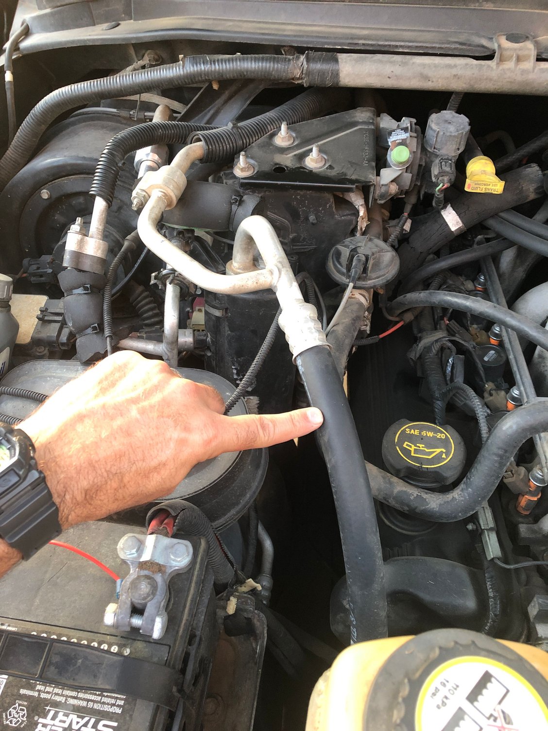

Hello everyone, I need some help identifying a part number for this hose. On my AC unit I am leaking from the bottom of this hose where it attaches to the compressor. The shop would not give me the part number for this hose but told me that there were only Ford OEM house is available at $340 apiece

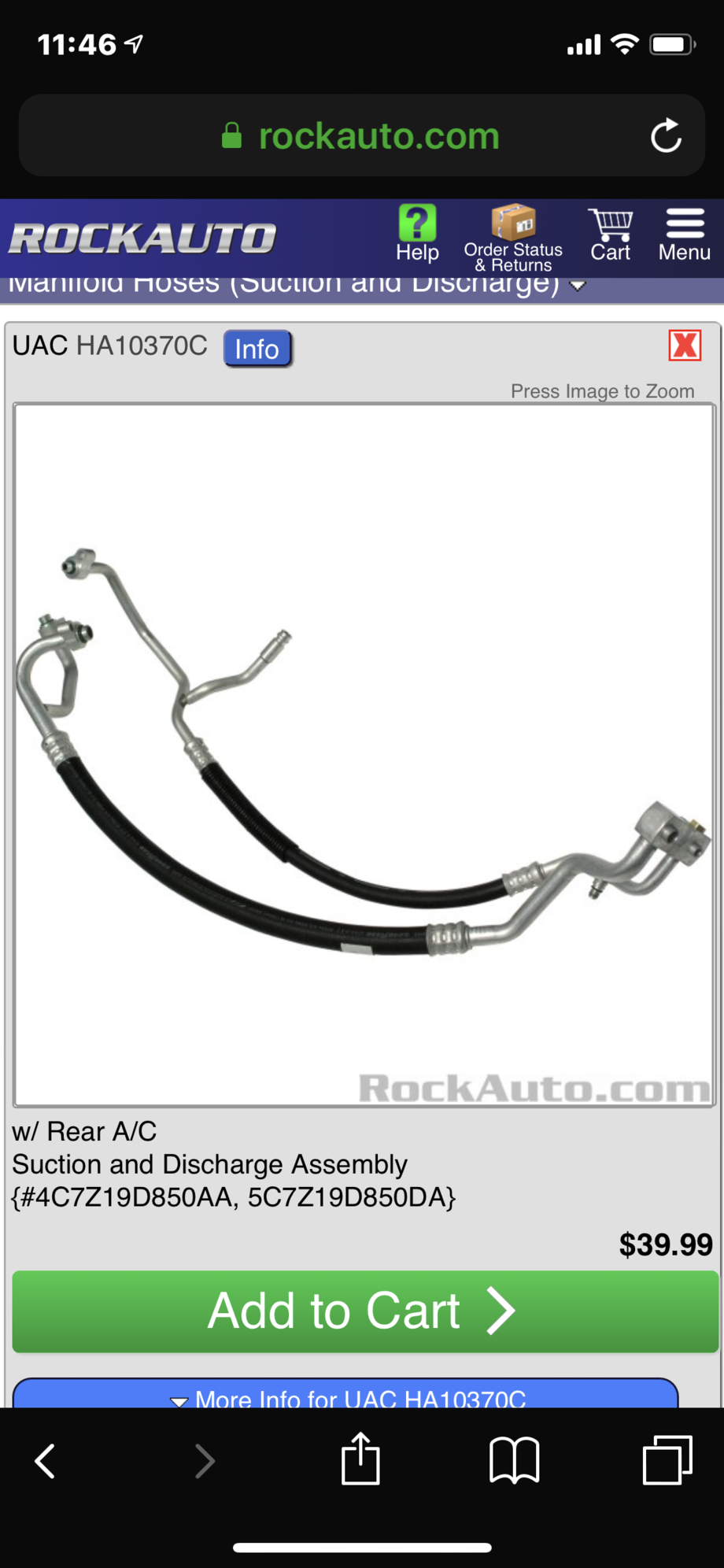

https://www.rockauto.com/en/catalog/...rant+hose,6900
Rockauto has what you need. Looks like about $35 average across the manufacturers. I'd go with the Four Seasons 56048.

Is it leaking where the end fitting (manifold) is crimped to the rubber hose, or is it leaking between the end fitting (manifold) plate and the compressor?

The garage said it is leaking from the rubber part of the hose itself near the compressor. I showed him the one that was suggested above and he told me it wasn’t correct. I just cannot imagine this one hose being OEM specific? Should I just buy the one that have seen suggested and have another shop install it?

I see the problem here. I looked it up under my 2001 truck and not YOUR 2001 truck...with the V10.
Here is the correct info from Rockauto.
Four Seasons 55908 ($52.99) or Motorcraft YF3091 ($85.79)
My bad...but Rockauto still has what you need.

Will do that for sure! What is the best way to get to the bottom of the compressor? Do I have to remove the wheel well?

Yes just below where my hand is pointing to the hose is where the compressor is located. Just no good way to get to it without taking the wheel well off. Unless there is a trick I am missing.
