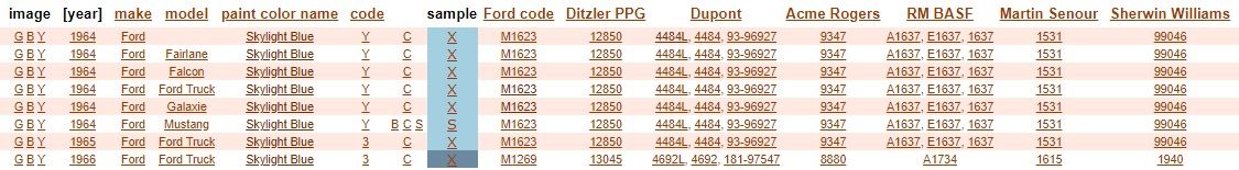

Mearntain, I'm not sure what you mean by correct. It looks like 1964 Skylight Blue to me, but is it indeed original paint on the outside? Who knows. Does it matter? If you want to keep the patina then it does to you, I'm sure. How do you tell? If you can't but you know of a good body shop take it there and have them take a good look at it and see if they can decide if it is original or not. Usually there are signs like a bit of overspray onto some rubber or trim parts or tape lines in the door jamb area. If not, it could be original paint. I will say again, and not trying to be rude, but that picture you show of your truck the paint is oxidized pretty badly. I'd call it "chalky" looking. It happens a lot to the older paints when they are subjected to years of outdoor living. But, if it matches the interior and if the interior for sure has not been painted (again, without really good pictures of certain spots of the interior it can be hard to tell from a computer screen) then it has to be correct, doesn't it?
I'm not sure if my links work but here is a screen shot of that web site. You can see the 1966 choice at the bottom is the darker color much like your gas tank repaint, while all of the years above it are the lighter shade. Same Ford color name of Skylight Blue. Ford just changed it up. It's what they did.
One other thing to note. Ford originally used Dupont or Ditzler paints. Acrylic Enamels and Lacquers. Ditzler was purchased by PPG. Most auto paints are now Acrylic Urethanes or Polyurethanes. So, the formulas are not the same at all as what they were. They have all been converted to the newer formulas as closely as possible, but it does cause some variations compared to back in the day.

Everything point you make is a valid one. The truck is definitely dirty in the picture, and in my opinion, the pictures dont do much justice. In person, it seems much more like different shades of blue, moreso than just one being a faded paint job vs new paint job.
I know it doesnt truly matter in the grand scheme of things, but my ideal end goal with this truck is to put it back 100% to how it was when it left the factory shop floor. That's the whole reason I want to ensure that I get the "correct" color. Yea, I'd be the only one to truly know, but it would certainly bother me if I spent a ton on a paint job just to find out that it was redone 2 shades too dark or vice versa.
Sherwin William's gave me the closest match so far using that screenshot you posted, but it was still slightly off. But it was a lot closer to where I could justify that one as faded paint vs new paint.
To elaborate some, the skylight blue purchased from AutomotiveTouchup was sold to me as a 1964 skylight blue, and that color was definitely different that sherwin William's 1964 skylight blue (Glacier blue in their system, which to my understanding is what they were called when it was on a mercury, and skylight blue when it was on a ford).

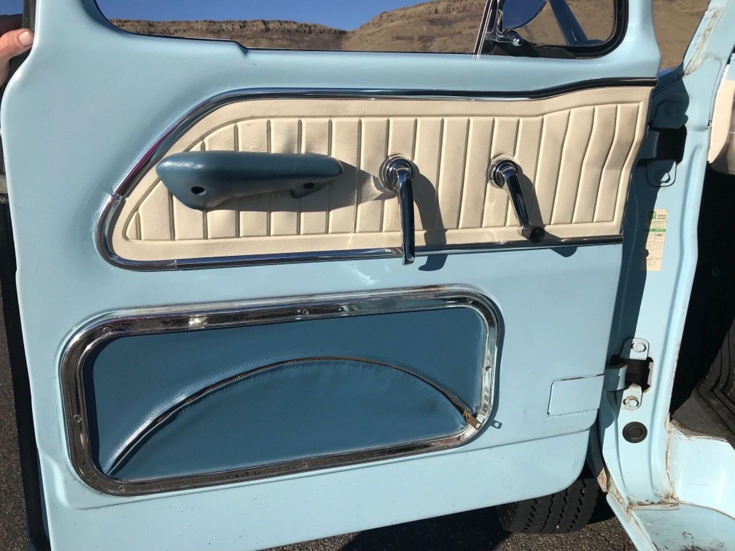

Here's a picture of the inside of the door of an original paint 1964 Skylight Blue truck.
