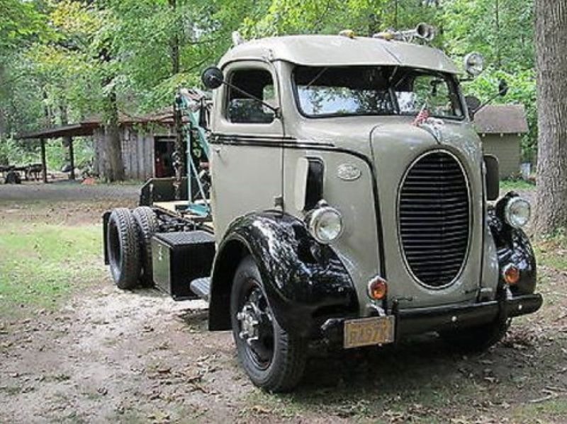

Here's a very cool older hauler---not a COE but I think there are a few of those here on FTE too---if I ever find those posts I'll link them too.
Stake Bed Restoration
Also found this image:
That ^^^ was discovered here: COE's
Hope to see more of this project as it develops.
