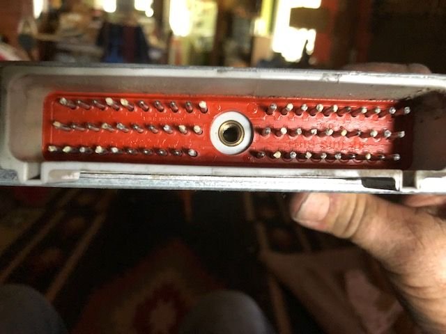

This although is not my PCM array. Mine has four rows of pins. This plug I could find, mine I could not.

I will get a pic of the PCM and plug when I remove them,
Thanks for your help.

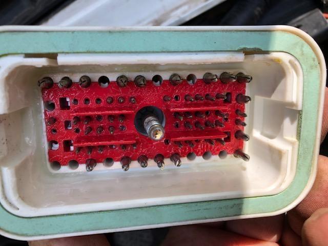

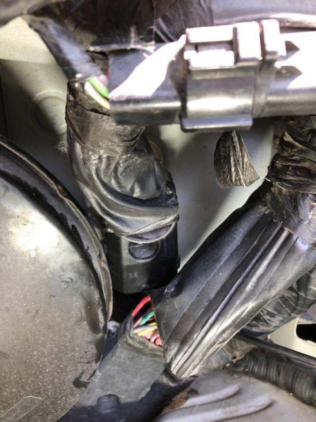

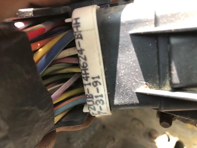

PCM, TCM?
Old Jun 29, 2019 | 12:55 PM
Van Johnson's Avatar
Van Johnson
Joined: Jun 2019
Posts: 13
OK, so now color me confused. Let alone can't I find a picture or diagram of my PCM, but apparently I have 2 modules that look alike.
Top one has a white plug, bottom a black.
Is this a PCM and a TCM?
If so, which is which and it isn't obvious to me how to extract either.
It occurs to me that maybe I don't even have the right animal. Maybe these are just plugs.
I'm going out to see if I can find something else...

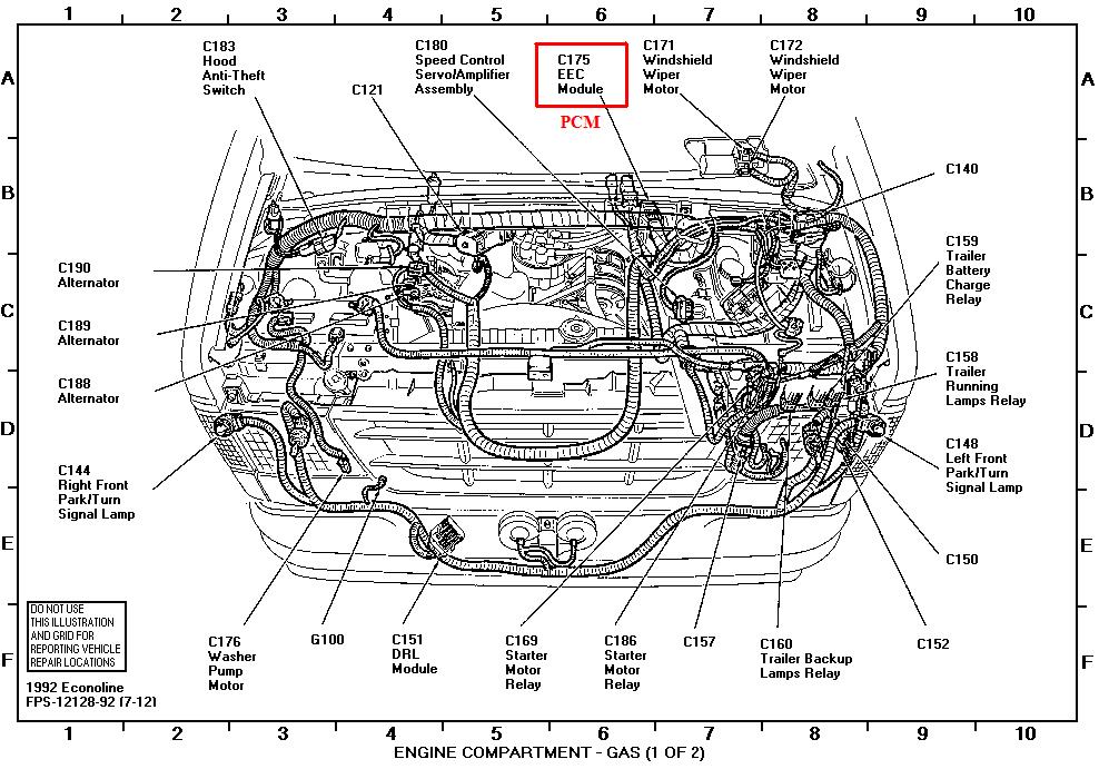

EEC/PCM/ECM location:
Old Jun 29, 2019 | 01:47 PM
Van Johnson
Joined: Jun 2019
Posts: 13
OK, color me stupid.
Opened the hood and looked right at it. Never saw it before (it's a van, hard to see anything easily).
I guess my only option is replacement. I could try cleaning it up and plugging it back in...
Think I'll just order another. They're not too costly.
Thanks again!
