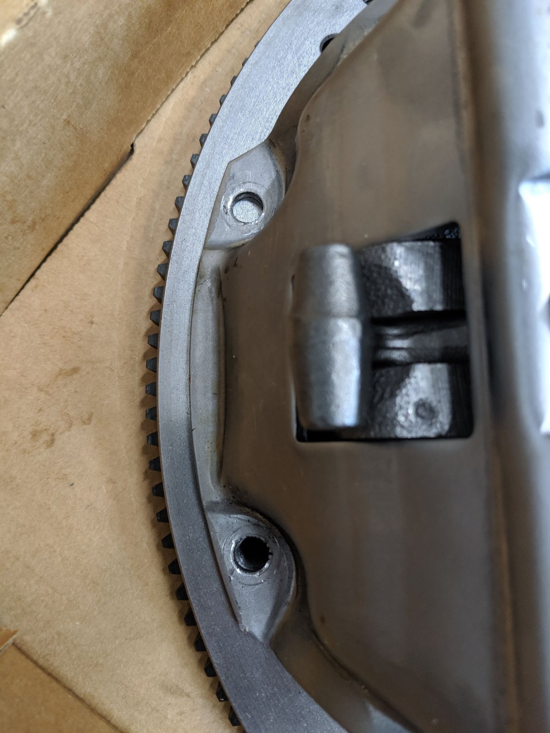

I removed a C5AE-6380H and purchased a part number EOTZ-6375A as that is all I could find. Number of teeth etc made it seem like it would fit, however the bolt pattern for the pressure plate is off. The pressure plate fits over one bolt hole but on the flywheel but there is no second pressure plate hole that lines up. Only 3 of the 6 holes match up. Anyone know what the correct flywheel part number is for a 300 with an 11".

That flywheel is probably drilled for the borg and beck pattern, your pressure plate is the long style.
Ok, makes sense. You happen to know a part number or where I can get the correct flywheel? Thanks for the help.

Found one here that for a 10 inch disk, #'s are FOTF-BA C6AE-6380-6 its drilled and tapped for both styles.
