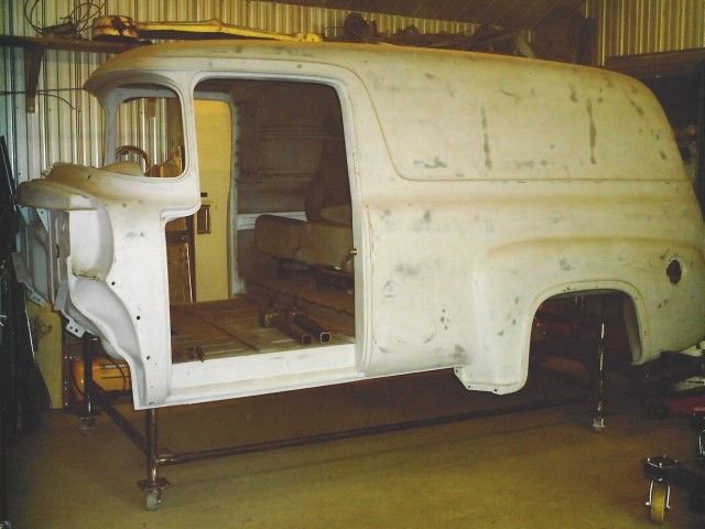

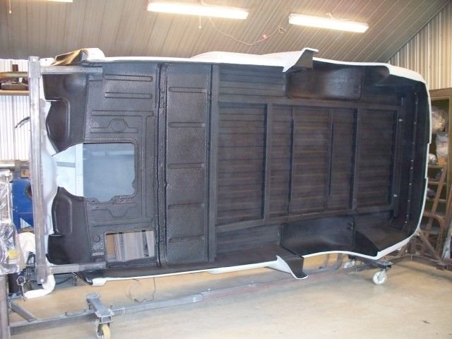

Can't tell you the weight but a friend and myself lifted a pickup cab with glass and doors attached when my back was in better shape, I wouldn't attempt that now, I used an engine hoist to first lift the front of my panel up high enough to put it up on a cross bar supported with jack stands , then used the hoist again to lift the back end then rolled the frame from under it. I made a frame from some steel tubing I had to put under the panels body so both could be worked on..
I thought I had pics of it when I lifted it off the frame but having trouble finding them but here's a pic of the body on the roller frame I made. I also made a rotisserie that I used for both body and frame..
My guess on body weight would be 700-800 pounds
