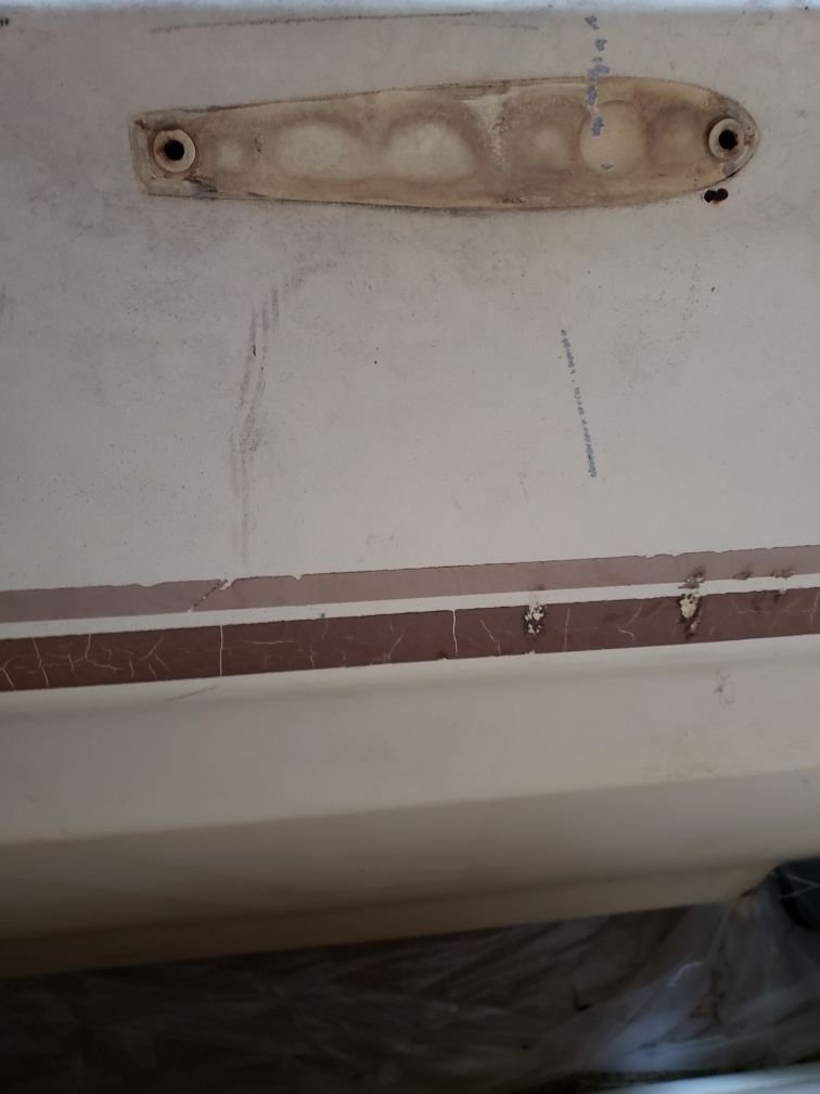

Here is a picture the holes for the side mirror of the original drivers side door.
Back home, the DMV person made me hang the original door on the vehicle before they would authorize the VIN check.
When I did that, I tried attaching the side mirror to the door, and I found it could not marry up with the door due to the metal grommets, and I heard a constant rattle from the side mirror mount.
Should there be metal grommets in the door?
I had read in other threads that when the trucks were delivered to the dealership, they had no side mirrors mounted, and it was the dealership that had to cut the holes and mount the style of mirror that the customer or dealership wanted the vehicle to have. Would the grommets have been original?
These metal grommets are not in the door tight, so even if you tighten the bolt/nut that holds the mirror, the grommet still rubs against the door metal it spans.
Is there a way to cut the grommets out without damaging the door?
Bottom two holes, and upper right hole have metal grommets. Top left hole has no grommet.

Take the door panel off. You can grab the back of the grommet with a set of vice grips. Then you can either: 1. tighten the bolt completely or 2. drill out the "grommet" like a rivet.

Drill them out and replace them with new nut inserts. You can buy them at any hardware store. Make sure you get the nut that goes with it. So you can install them. I have a tool that works great for those.

X2 on they are rive-nut or commonly called nut-serts. X2 on that tool posted above, drill out and replace.

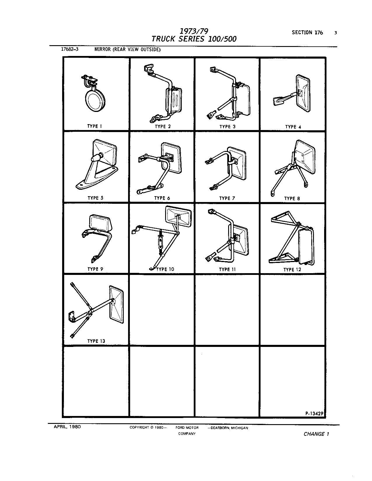

Any idea why someone would put grommets in?
Grommets came in the mirror kits.
What Ford vehicle that uses the same doors as the pickups did not have passenger side mirrors?
Originally, ALL of them!
Doors are the same: 1973/79 F100/350 & 1978/79 Bronco.
The only standard equipment mirror (except Camper Specials) was the left hand Passenger Car type (TYPE 5 in pic), but no outside mirrors were installed by FoMoCo.
The dealers installed all the outside mirrors. The Passenger Car type was placed inside the cab at final assembly, but most people did not want it. Most were THROWN AWAY, I kid you not!
TYPE 3 or 8 came with the Camper Special package. But people could have the dealers install other mirrors. The TYPE 3's stuck out well past the cab and could not be repositioned.
TYPE 8 (introduced 1975) mirror head could be flipped over than pushed out giving a more expansive view (as pictured).
