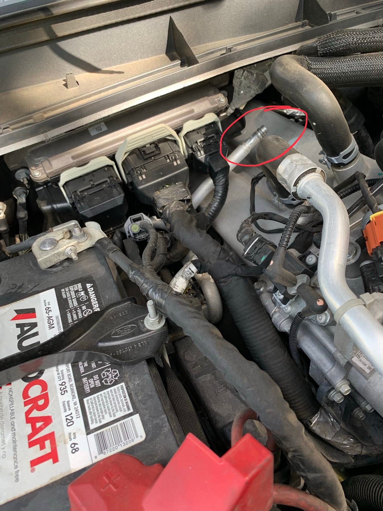

My a/c is losing Freon, looked just to see what I could find (even though I have no clue what I’m looking for &#128514 and saw this. Didn’t know if it was supposed to be open or have something on it. Any help would be greatly appreciated!!

I have to be honest and tell you it’s time for you to stop popping the hood and bring to the mechanic hahah , that’s the low pressure side of the ac lines where you would fill / guage test should have a black cap on it but doesn’t , I am assuming if you didn’t know that you prolly are better off just bringing it in , could be a bad o ring , could be a leak in condenser could be many issues but need a a die test and black light to find leak that’s after a proper check of lbs in system and pressure amount

Yea I can build a house with my eyes closed....when it comes to vehicles....not so much lol. But you know, sometimes just popping the hood and looking can fix minor issues lol...
