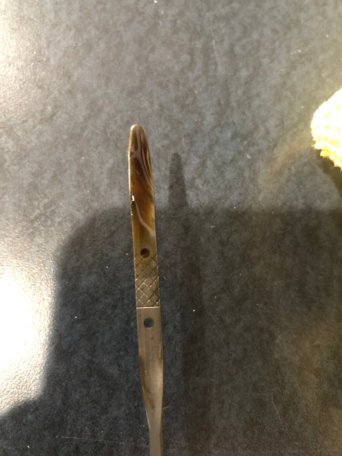

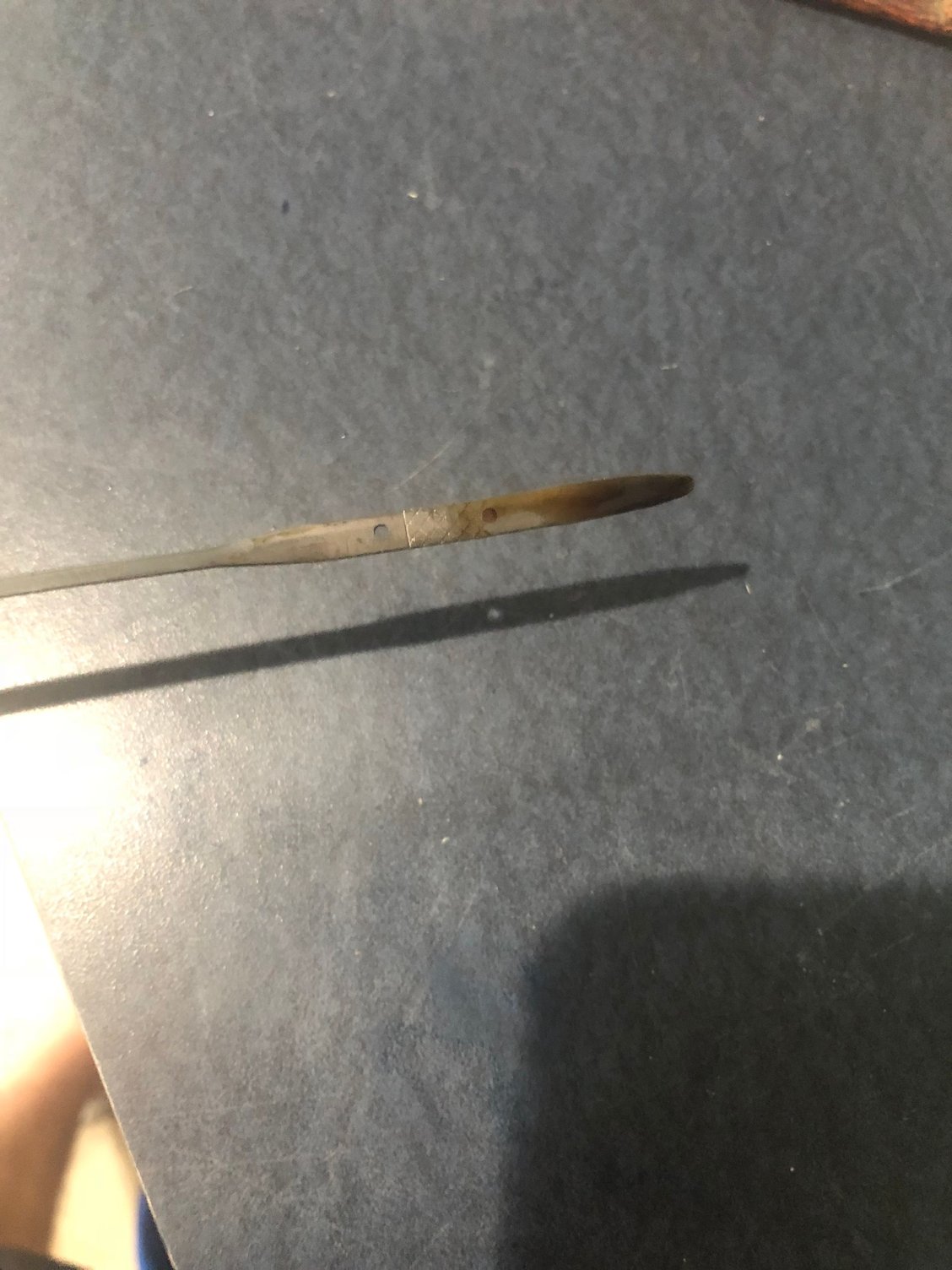

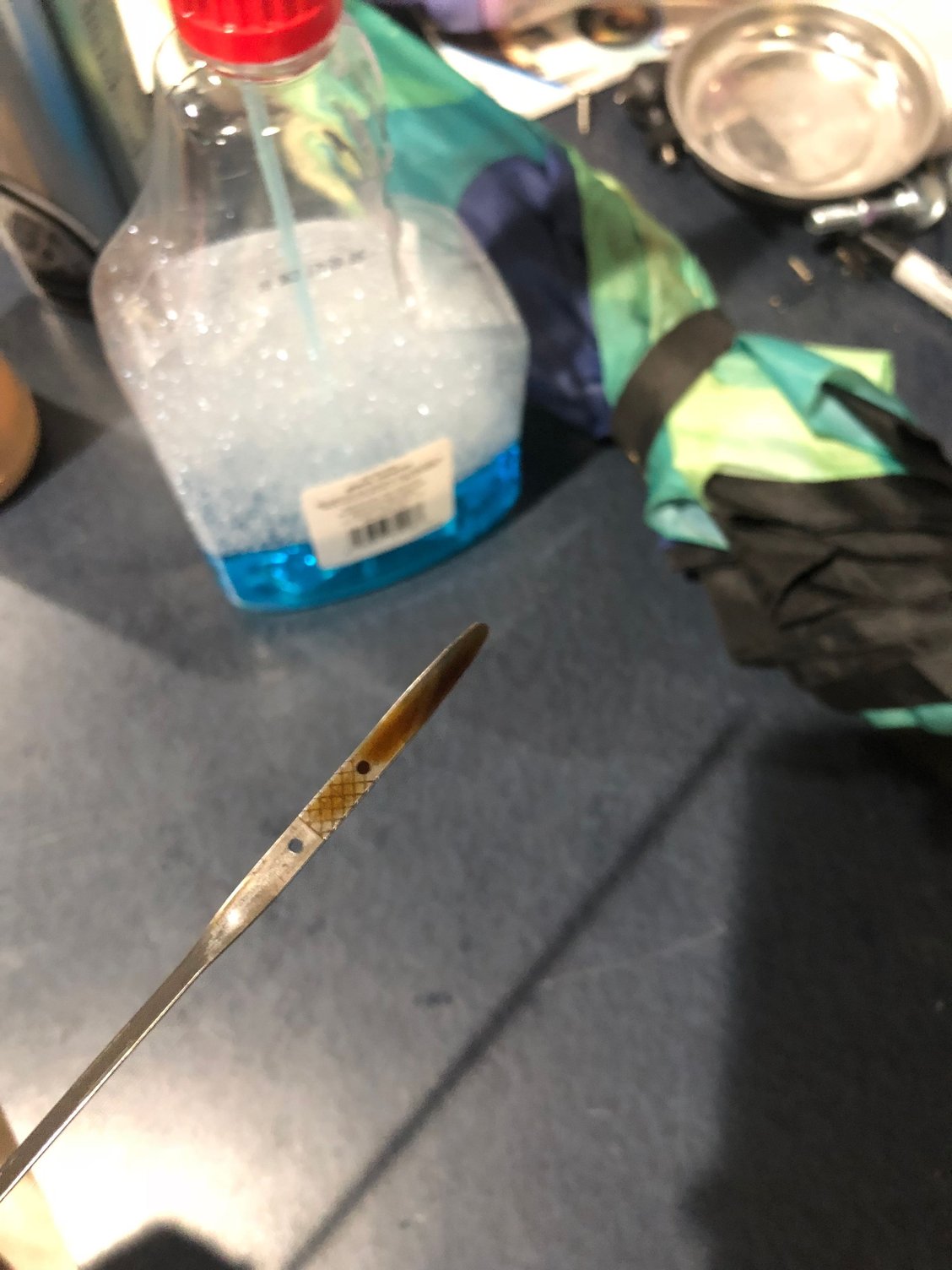

Hi guys. After my fist dealer oil change I found out that they forgot to put mt air filfer back on.. when I got home the service called me to tell me that they have foegoten to install it back. So I did my own oil change but with these new dip sticks with thise two holes I am having hard time reading it.
that is the oil level after the truck has been sitting for about 30 min.
Does that look ok? I have put in 8.8 quarts of oil as recommended by the manual.
Thanks
Short 1/2 quart

Originally Posted by chech
Short 1/2 quart
As dirty as that oil is, I suspect there is quite a bit of mileage on the oil. Mine at 5,000 is hard to read on the stick. That’s why I’m believing it was burned, not shorted. If that’s fresh oil, the OP needs to take it elsewhere for a change. No way new oil should be close to that dirty after a COUPLE thousand miles.
This is my second oil change. First time I changed it was at the dealer at 7,000 miles when it got to 40% oil life. The second time I changed the oil myself at 13,000 miles and now I’ve got 14,448 on the truck. I also thought that the oil was a bit dirty for only having 1,400 miles on it after change. My first oil change I have switched to full syntetic instead of systetic blend. Full SYNTETIC is what Im currently running.

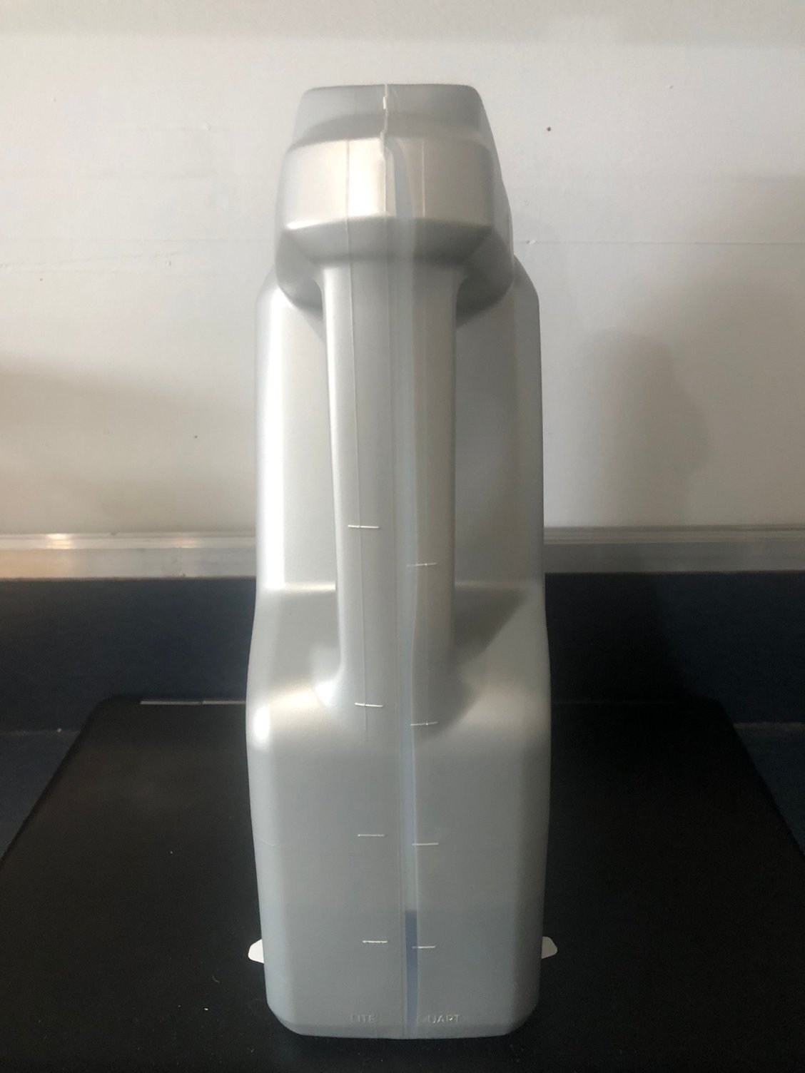

Sounds good. One more question. Lets say I was too clumsy when changing the oil and did not account for the oil filter sucking up half quart of oil or so (but im prety sure I put in the right amohnt) I put in 5 quarts and then this much afterwards
And lets say I dont have any consumption, down the road should I still be worried about oil consumption? If I understand this correctly It ether consumes oil or it doesn’t.. right?

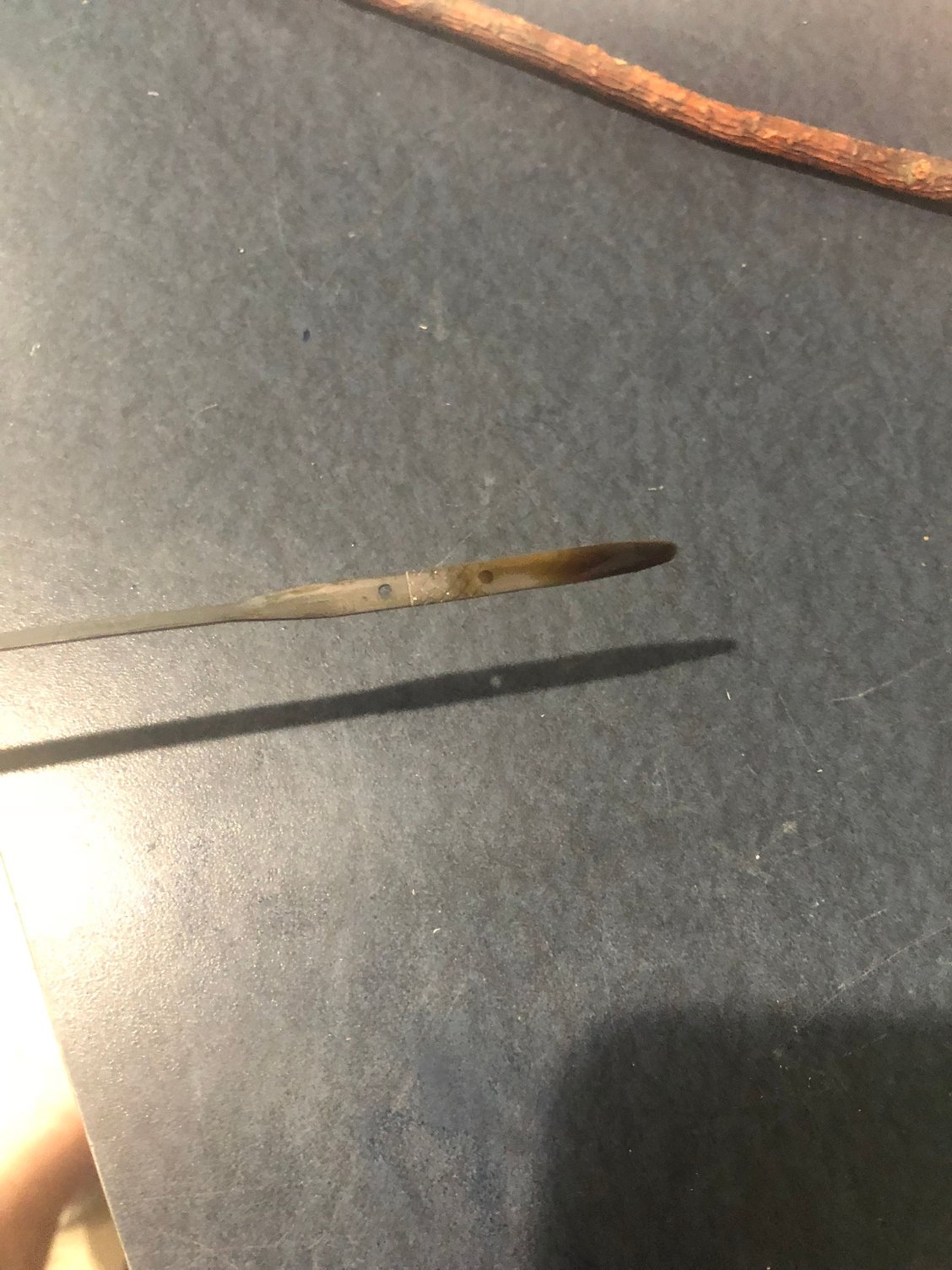

I hate to reply to an old thred but I am happy to say that after 1400 miles my oil level stayed the same as when I opened up this thred.
At 14,500 miles
At 15,900 miles
Since I have another 2500 miles until my oil change I have topped it off and will check at 5500 when it’s time to get it changed.
Topped off.
