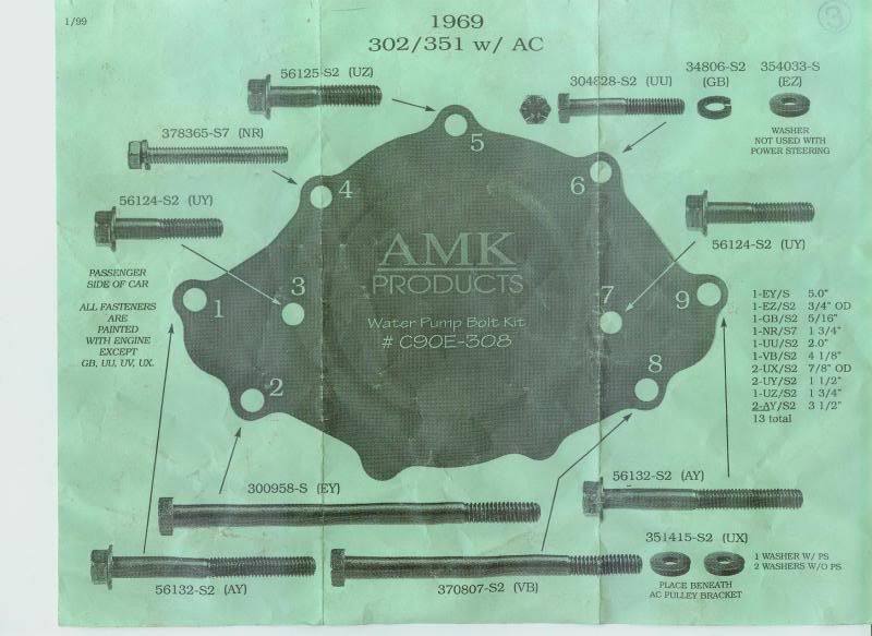

Is there a chart or picture anyone has that shows what bolts go where?? I think I got most figured out except the bottom ones. I also have one extra, but it looks like all the rest!!

This is for a 302 for 79 an up but you didnt say what a motor

That’s exactly what I’m looking for but, I apologize, I have a 1979 351M.

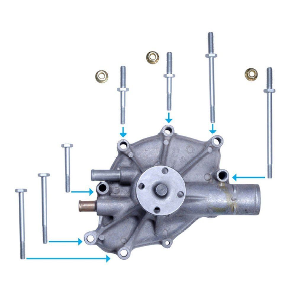

Unsure if its the same then but here is an older link on here that may help https://www.ford-trucks.com/forums/1...ump-bolts.html

Papajohn's set up looks right.

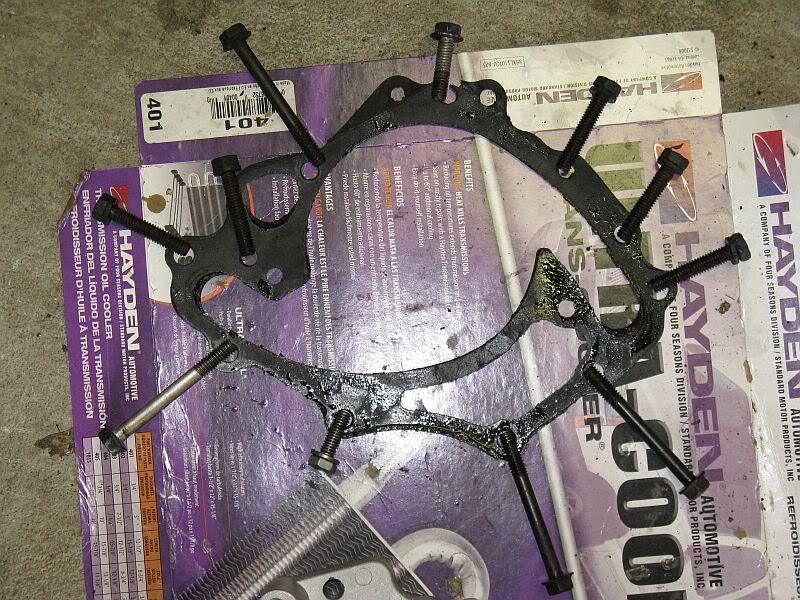

My lab has many nick names. One is "Lug Nut", because he once did just what your son did, except I was working on my transfer case. Now I make a map/diagram, and use a gold or silver Sharpie to mark every fastener before they go in a box or zip loc.

https://www.ford-trucks.com/forums/9...ml#post9197351
https://www.ford-trucks.com/forums/4...-for-351m.html
1nd pic I believe for a 351M 400?
2rd pic I also believe 351M?
Let up know what you get figured out. I always take a piece of cardboard and map it out as far a bolt placement. Like the gasket.
Just remember...I believe a couple just go in/thru the pump and then into thin cover plate behind it.
