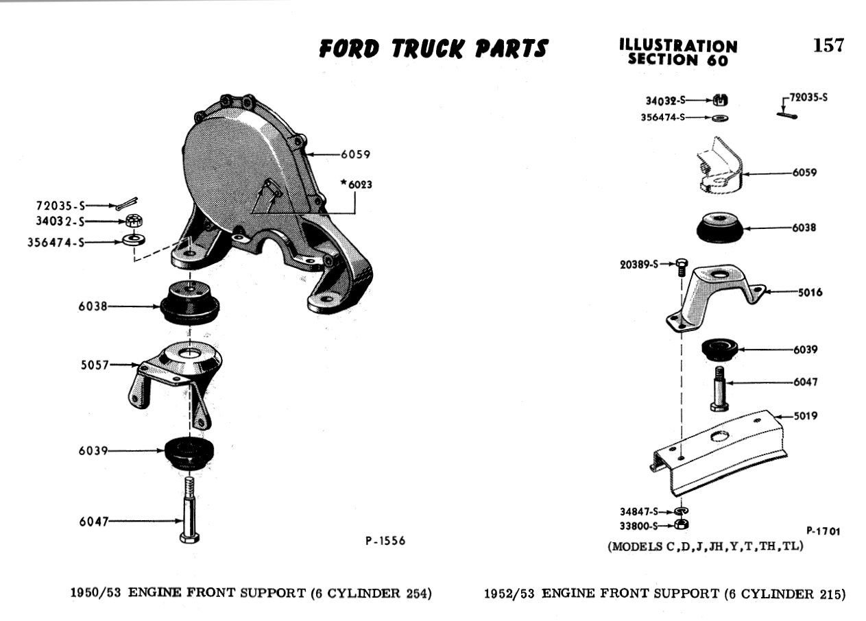

I have a 1952 F-3 when I tore the truck down I had some help, well now I am putting it back together and my help does not remember how it goes back together. I need to find a picture of the motor mounts for a 6cyc ohv so i can get back to work. can anyone help me with this dilemma? or direct me to a location. my shop book is of no help.

Does this help? Stu

Hope this helps:
