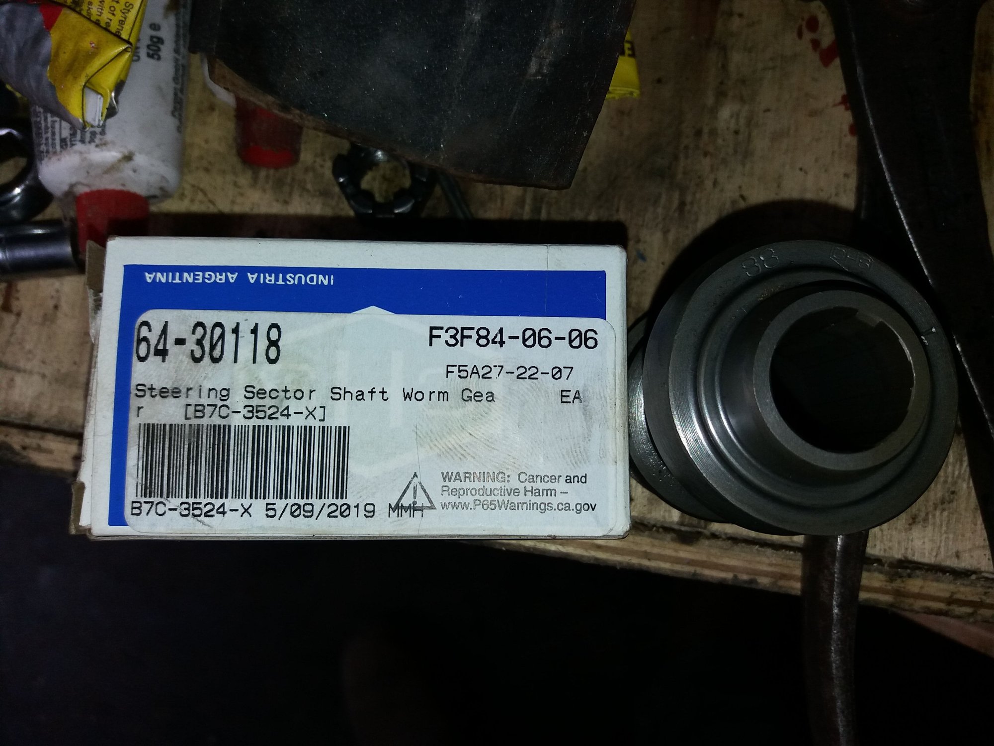

Well I got the parts from Rock Auto the bearings were wrong and the two seals are the same just different brands and called different names.
I guess the bearings were for a power steering box never mind my old ones were good.

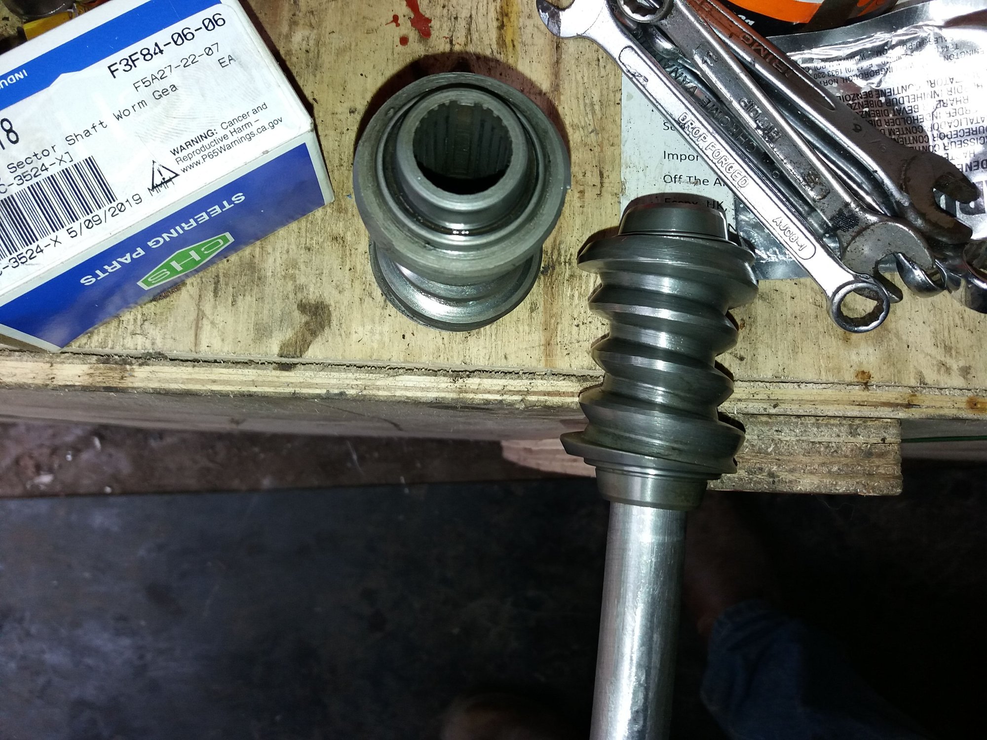

I managed to remove the old gear from the shaft with a press, I dropped a collar down the steering shaft turned the shaft upside down, the collar held the gear and I used a pin to push the shaft downwards through the gear.
I ordered a new gear from Mac's, managed to get my shoebox hood springs and hood bumper kit at the same time.
The new gears are made in Argentina.

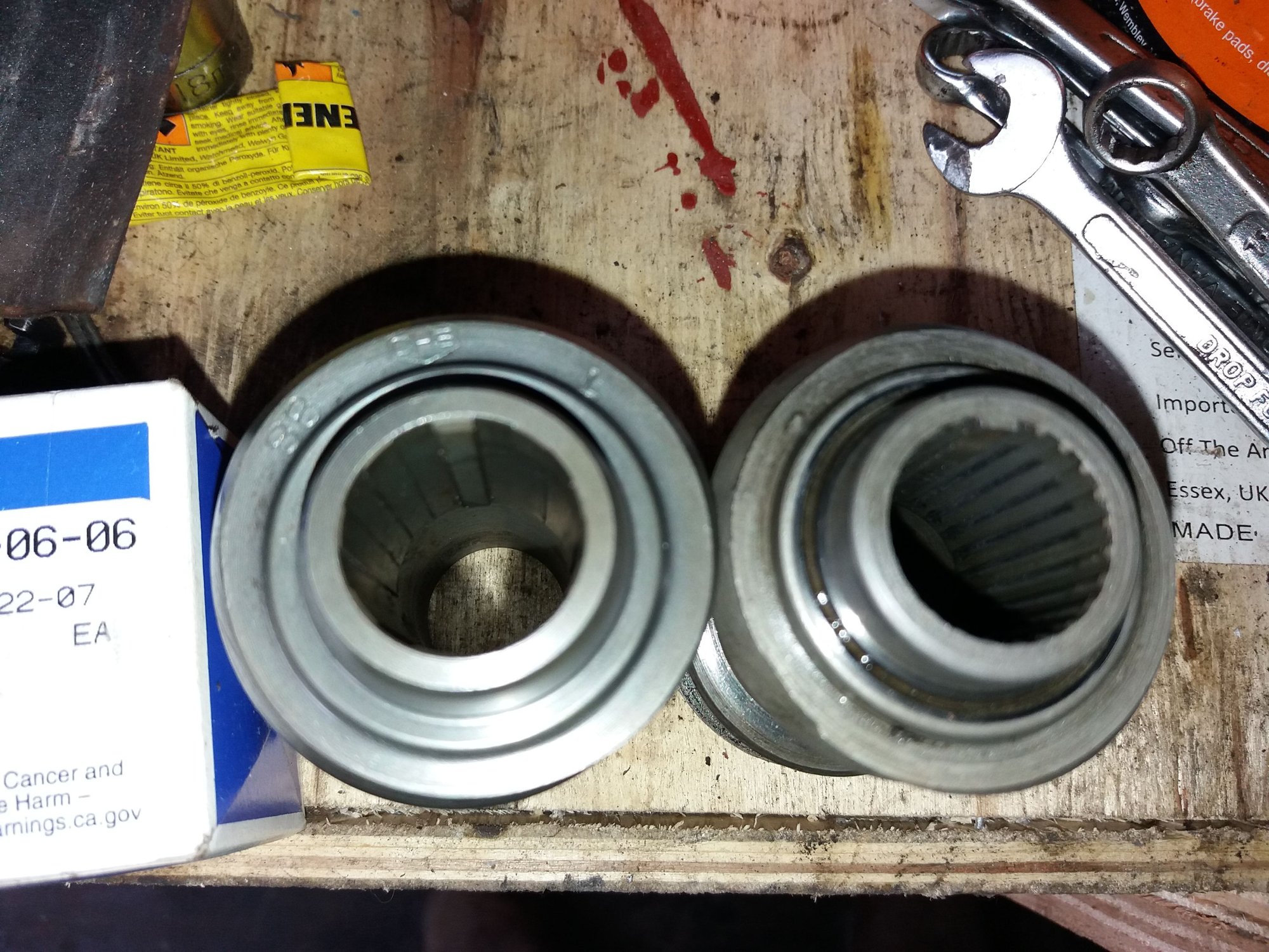

At this point I had a panic attack the inside splines were different in each gear, both gears were marked 88, this was going to be one hell of an interference fit.
I had a mug of coffee whilst I plucked up the courage to fit the new bearing.
The keyway and the splines are only present at the bottom of the gear they run maybe half the way up the inside of the gear, the top half inside is circular maybe a slight taper.
A test fit put the gear on the shaft far enough for the keywayy to locate and the flat splines to start to grip the steering shaft splines.
I wrapped emery paper around the steering shaft and locked it in my vice, I had another coffee.
Three blocks of soft wood on the floor and the steering wheel nut on the thread I lowered the shaft to sit on the blocks, locked it back in the vice.
Another coffee, I read so many threads about this gear change I wanted to take my time.
The time had come I only had a hot air gun for heat so spent 10 minutes heating the gear on an anvil then I picked it up with a rag located the keyway on the shaft and beat it with my copper mallet.......
5 minutes later job done, now its all refittted, the box is back on the truck and the steering is beautiful.
