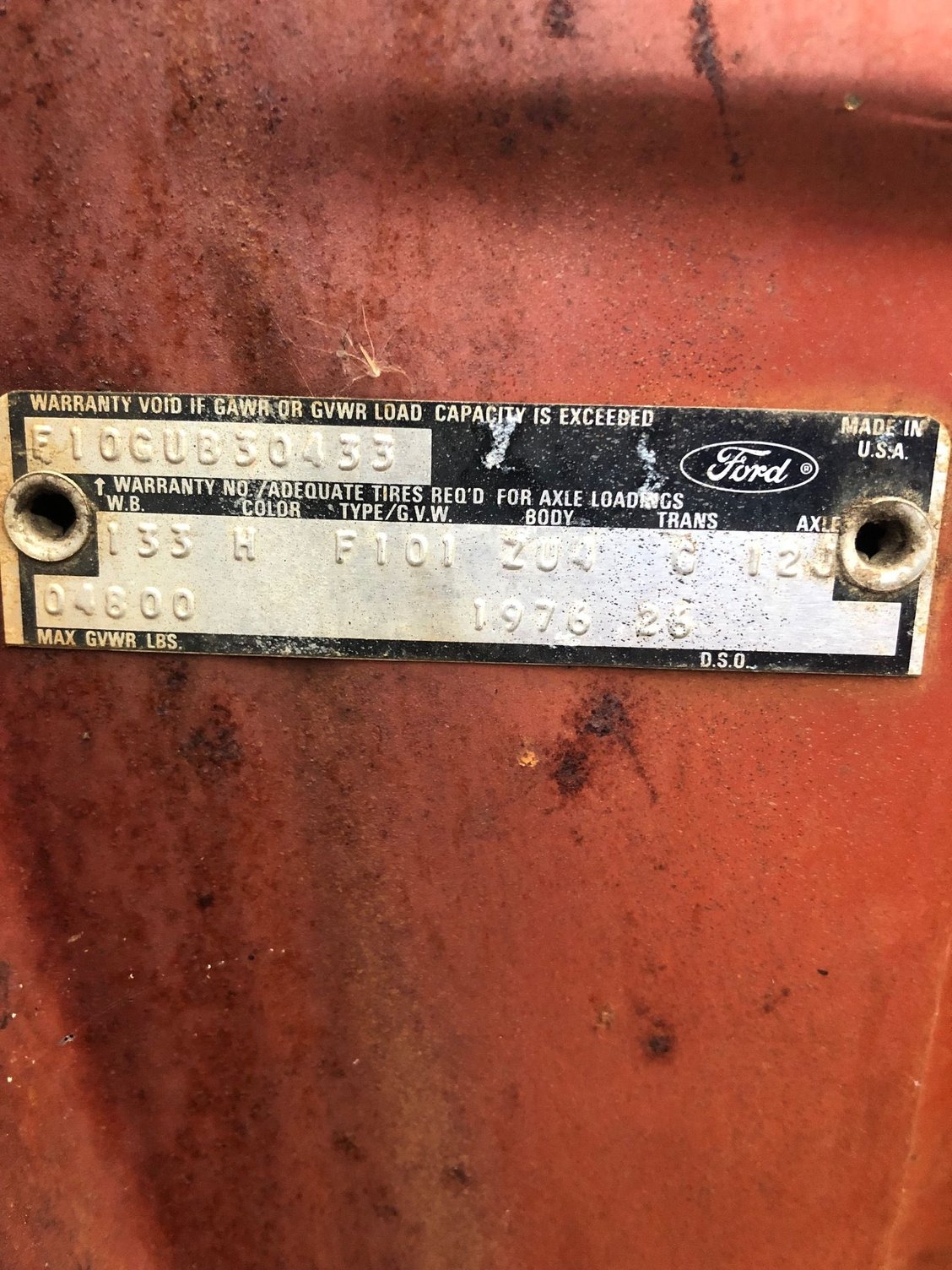

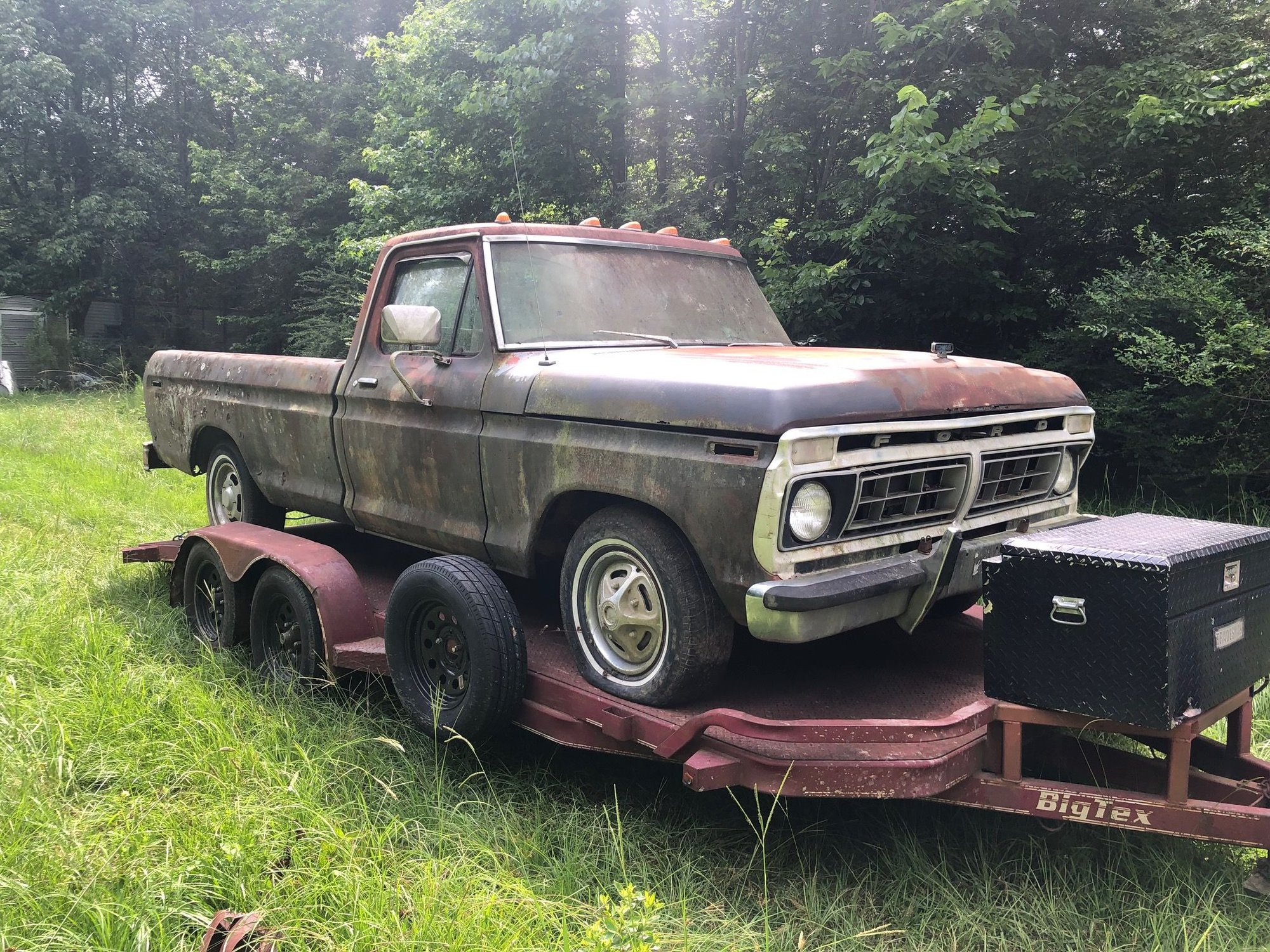

Ok, new here, picked up my new project this past Saturday. Got the short bed Sat morning, it needs a drivers door and bed front panel and some small rust repairs. Found the long bed later the same day after talking to someone "who knew where one like that was for sale". The red short bed has a 302, three speed, no power anything. That's the one I want to build. The long bed, parts truck, has a 302, automatic (c4, I presume), a/c, power brakes and power steering. The only thing I haven't figured out is the gear ratio... deciphering the VIN,as I read it, could be a 3.00 or 3.70. Can anyone tell me from the VIN plate?
Looks like a bunch of great info on this site, I can't wait to get started!
This a project between me and my son..
76 short bed
76 long bed

There should be a tag on the side of the rear differential itself. Might be covered in crud. That's what I'd go by, but I think this is a 3.70
Nice finds!

I like finding the axle tags intact after all these years too. But to make sure we have all the info, is that Axle Code on the warranty plate a "12J" or something else?
I think 12J sounds familiar, so it's probably so. We'll just have to let someone with more knowledge interpret the numbers.

There is a tag on the red short bed axle, and it is covered in crud! Haven't looked at the other axle yet. Both VIN plates do show "12J". According to a website I looked at, it could be a 3.00 or 3.70..
I'll get under them this weekend and pull and clean the tags!

Here is where I was looking, the axle code is 12, they are both 1976...

Man, looks like you are all set.... A project truck AND a parts truck. Same engine and everything.... GREAT FIND!

F10 = F100 2WD Pickup.
G = 302 2V
U = Louisville KY Assembly Plant.
B30433 = 1976.
133" Wheelbase.
H = Medium Copper.
F101 = F100 2WD Pickup, 4800 lbs. GVWR
ZU4: ZU = Tan all Vinyl - 81A Custom // 4 = Styleside Pickup Box.
C = Ford type 3.03 3 Speed Manual all Synchromesh Transmission.
12J: 12 = Ford 9" Rear Axle / 3.70-1 / 3,750 lbs. Rear Axle Capacity or Dana* 44 Rear Axle / 3.00-1 / 2,900 lbs. Rear Axle Capacity // J = Power Steering.
4,800 lbs. Gross Vehicle Weight Rating.
1976.
26 = New Orleans LA Ford District Sales Office, where the original selling dealer ordered the truck from.
*Dana rear axle has an inspection cover, the 9" does not.

Bill, thanks! I didn't see where the decoder separated the axles, Dana vs Ford. Mine is a Ford 9"...
So I've got 3.70 ratio.
