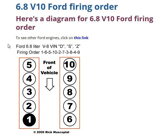

the wires for coils 6 and 7.. did you by mistake put #7 wire on 6.. and #6 wire on 7..??

Not sure about the older V10s, but on my 2008 3V it wouldn't be possible to wire them backwards the way the wires are setup.
Check the clips, as they get older they tend to break and no longer snap on properly. Sometimes you can get them to stick for a short time but they may rattle loose once you get the engine going for a bit.

Thanks, no the coil wires aren't hooked up wrong, and the clips are still good. It seems to only happen when the MAF sensor is plugged in. I need to remove the air intake to get to 6and7. It was running fine before I did the tune up and if I unplug the MAF sensor 6and7 start to fire again. I don't quite understand how the sensor could have gone bad just by unplugging it and plugging it back in.
