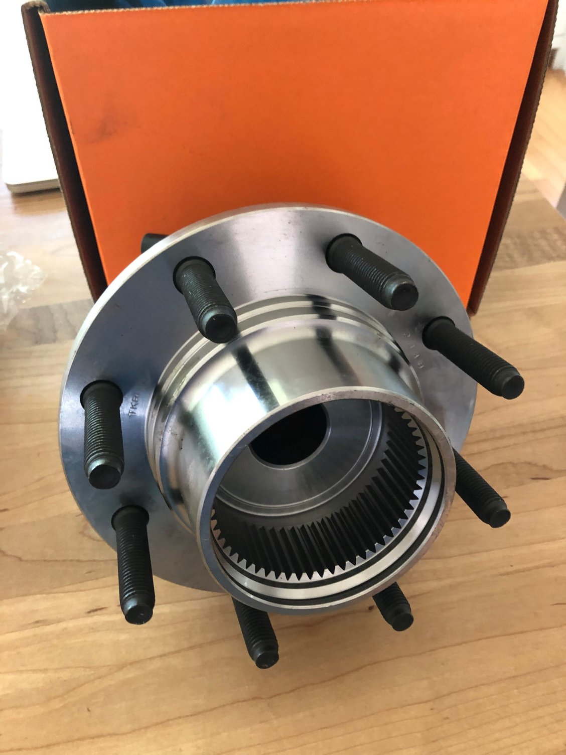

Got some new timken wheel hub assemblies. I didn't realize until I got the new hub all greased and placed on the truck that I ordered course thread as my truck is an 04. BUT it looks like my truck has fine thread studs. For some reason I read the change over order wrong. I thought they went from fine to course when in reality they went from course to fine.
So..... advice? Keep going and get new corse thread wheel nuts for the front of the truck? just have course on front and fine on back.
Not sure if there is any issue with course threads for me as I will only be running this truck as a family hauler with max (someday) 35's on it. Right now still stock wheels and tires.
thoughts?
thanks

~10 months of driving on a mix of coarse and fine threaded front/rear hubs I and haven't felt any ill effects. I just have to remember not to mix up the lug nuts.

Since they are already installed, I would get the matching nuts and carry on!
My '05's rear axle is from an '01 so it has the course threads and the front axle is still the original fine thread, been mis-matched for the past 7 or so years now, no issues at all.

If it bothers you, the studs are easily replaced. On or off of the vehicle.

Hmmm, my 4 studs that go through the knuckle are fine thread and I used the original nuts on the back that were on the truck. Your 4 studs are course thread?
My issue was I ordered the hub with the course thread wheel studs instead of one thread. I have stock wheels so I ended up just getting flange nuts for a 2002 (which came with course thread wheel studs).
