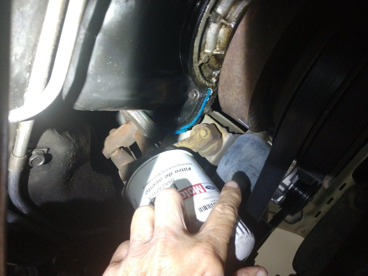

This is from my 91 460. Do you see the hose you are having trouble with in the pic? Sandy

no. the hose is underneath. near the connection point for the bottom rad hose.

This one?

That hose he is talking about must go to the oil cooler. If so, you could remove the oil cooler to put the hose on instead of removing the water pump.

yes. where your finger is pointing. think its related to the oil cooler

With the oil filter out of the way I can't see how there is a problem doing this. I am not doubting you. Just wondering if you got the correct hose or if it is not made correctly. I'm glad you posted this as mine looks like it could blow anytime. Electronic cleaner aka contact cleaner works good getting hoses on and it dries immediately. You need to work quick when you spray it in the hose because of this so spray one side at a time. I need to order a hose so let me know what happens. Sandy
