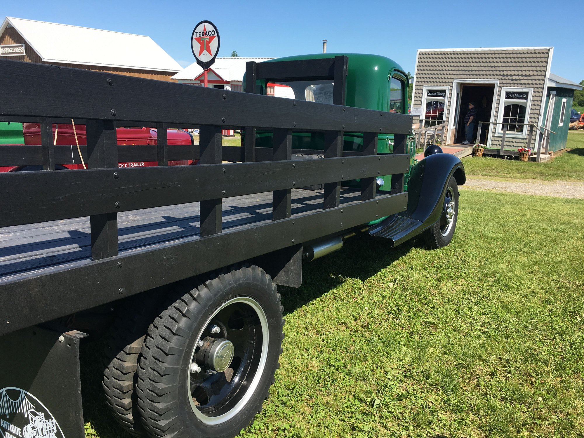

Was at the St. Lawrence County Power Equipment Show today. Saw this 38 Ford. Got some good ideas on how to do my flatbed. He has 4x4 on the rails and 4x4 across those then 1x6 for decking. I currently have 2 2x8 in each rail then was going to put 4x4 across those and use 2x8 for decking. I think I have to use the 2x8 for the rails to get the clearance from tires and bottom of bed. Very nice truck!
