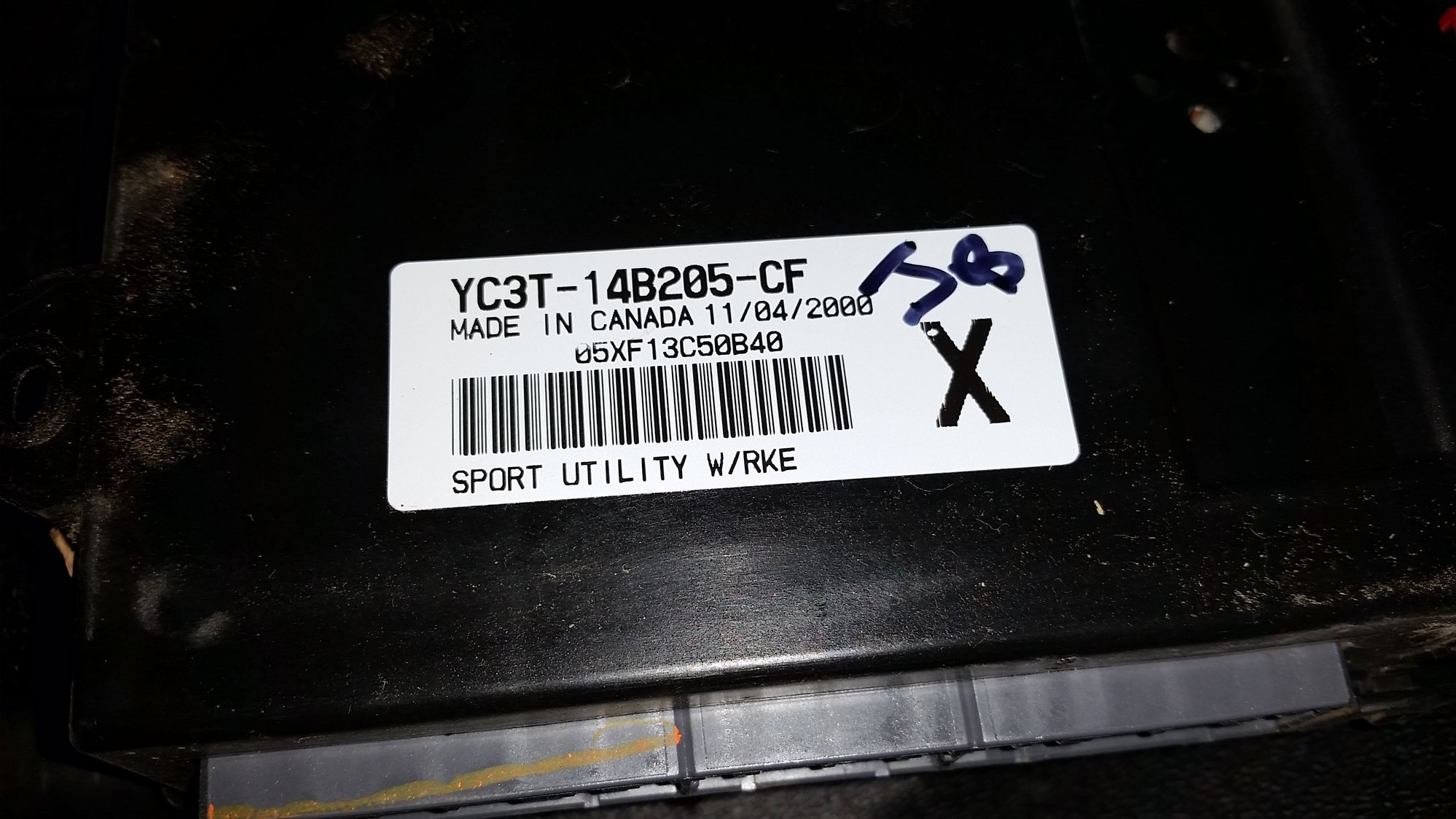

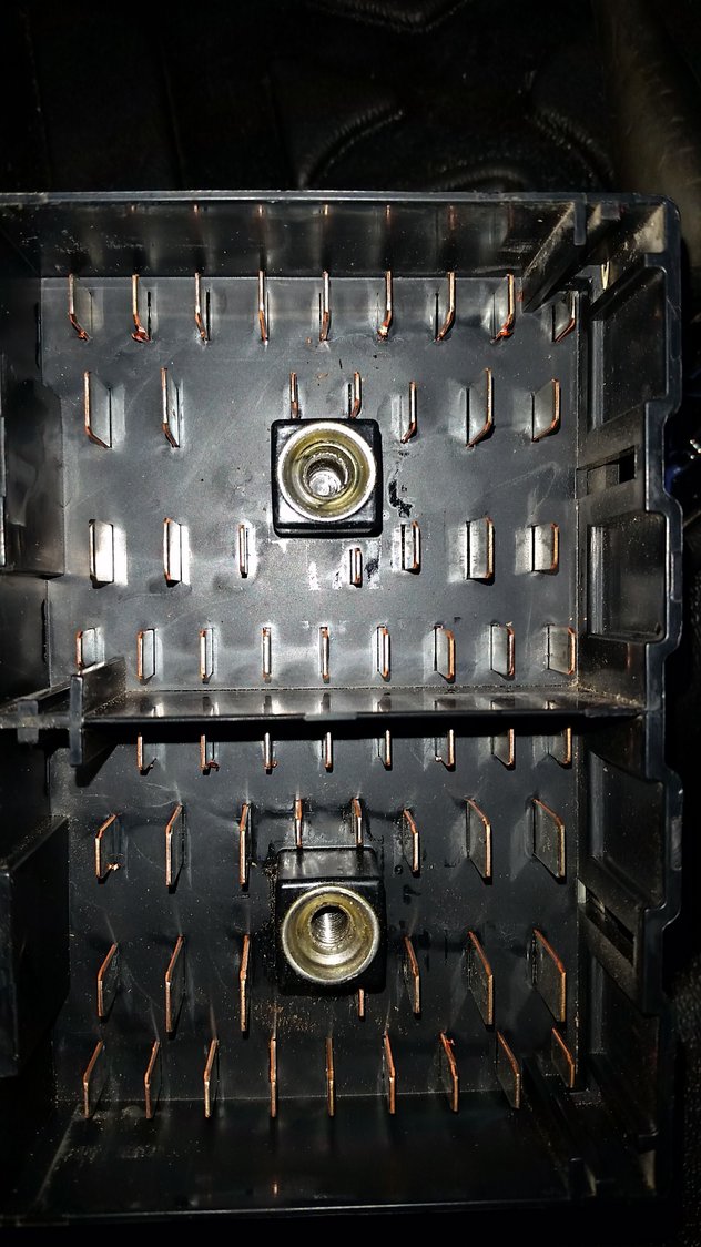

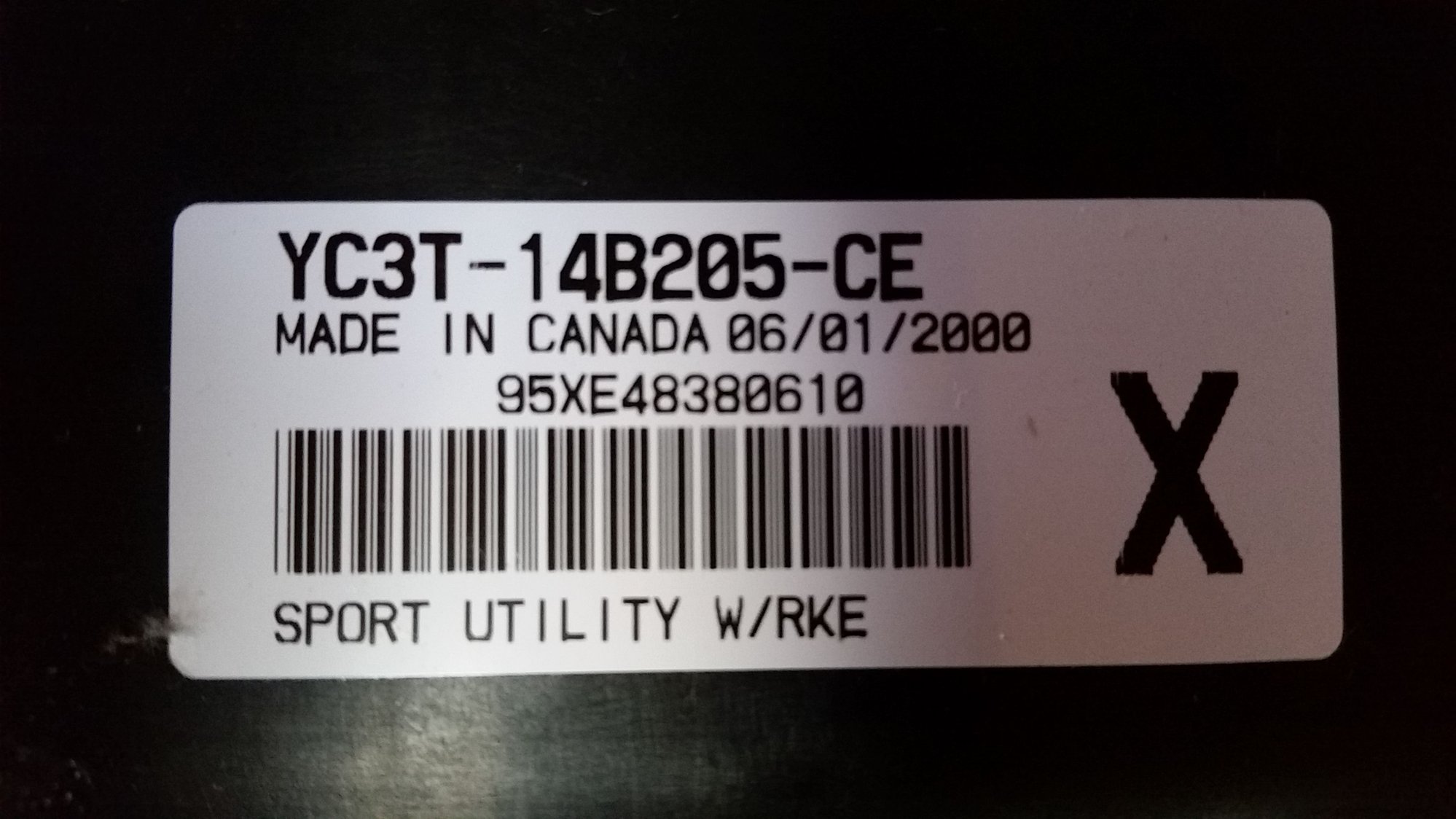

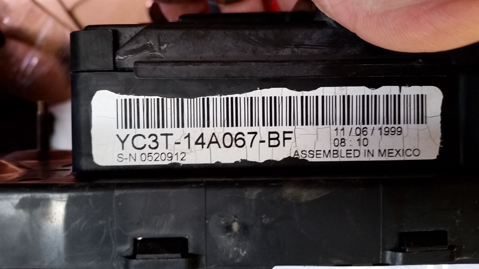

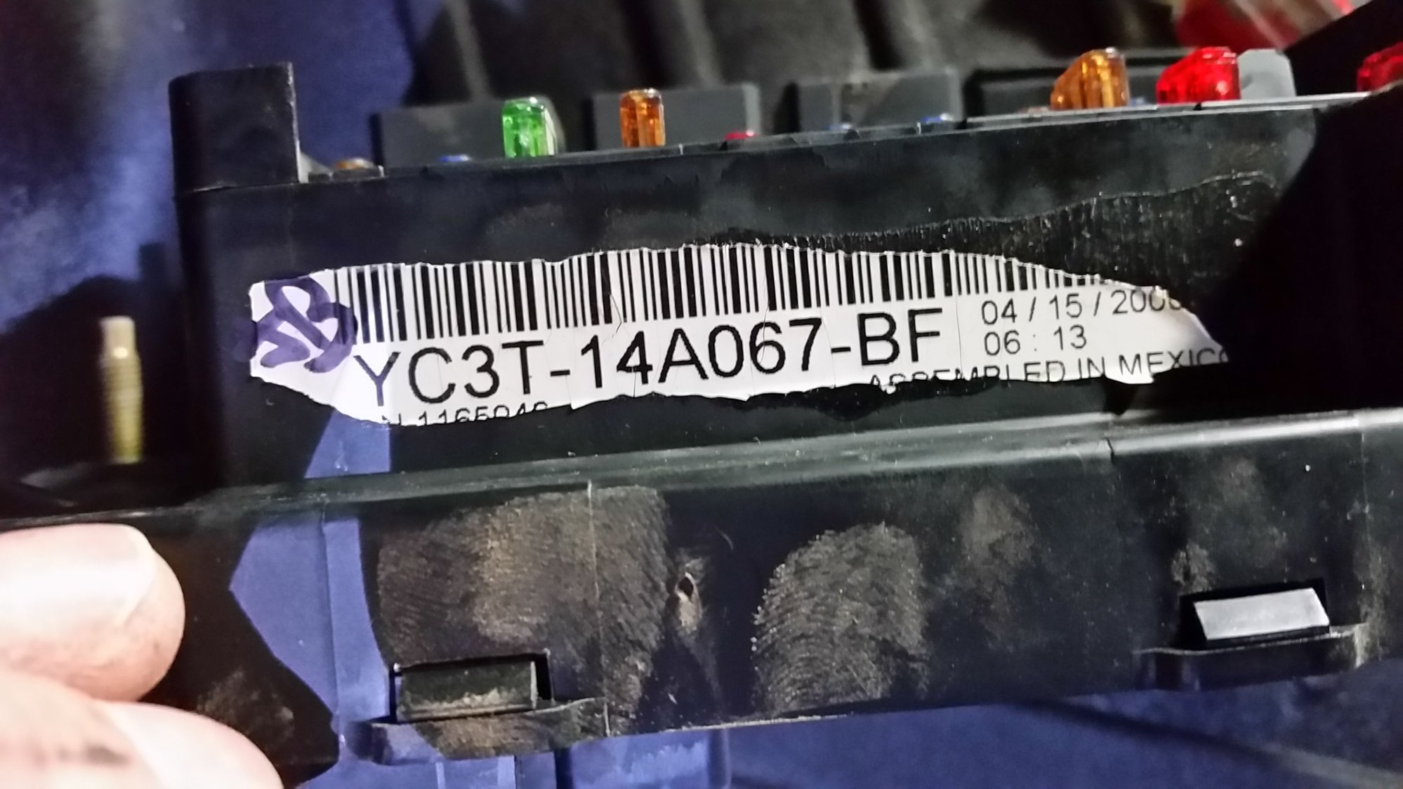

I attached pictures of the GEM and fusebox if anybody is curious.
You have to remove the GEM from the fusebox to read the programming information.
GEM info from my EX
GEM info from junkyard EX
Fusebox from my EX
Fusebox from junkyard EX
Fusebox part number from my EX
Fusebox part number from junkyard EX
