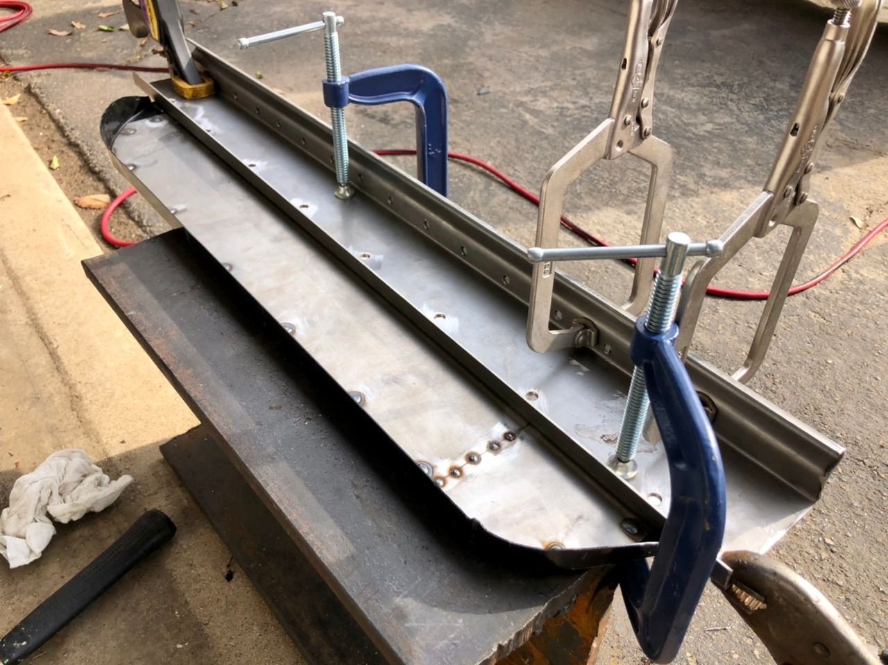

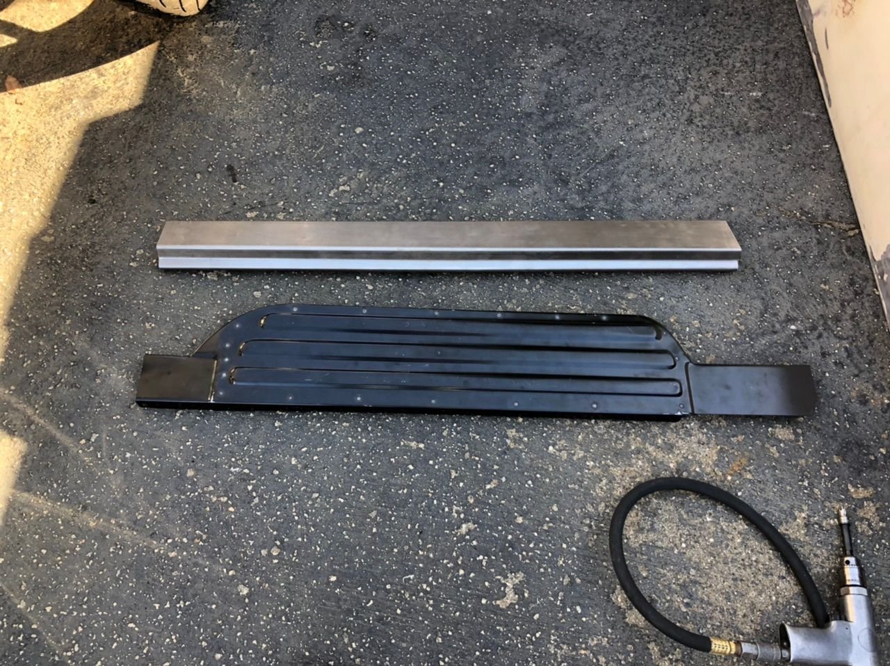

Reviving this thread. These parts are available from Dennis Carpenter.
But beware, the step plate doesn’t exactly fit the contour of the well. Obviously, it’s just a bit more fab work to get it to fit right.
The black part was a bit thin and because of the offset at the ends, there was a small gap when the two pieces were assembled. I decided to fill that gap and reinforce the step with a piece of 16ga.
I’ll add a few more pics tomorrow when I get a bit further along.

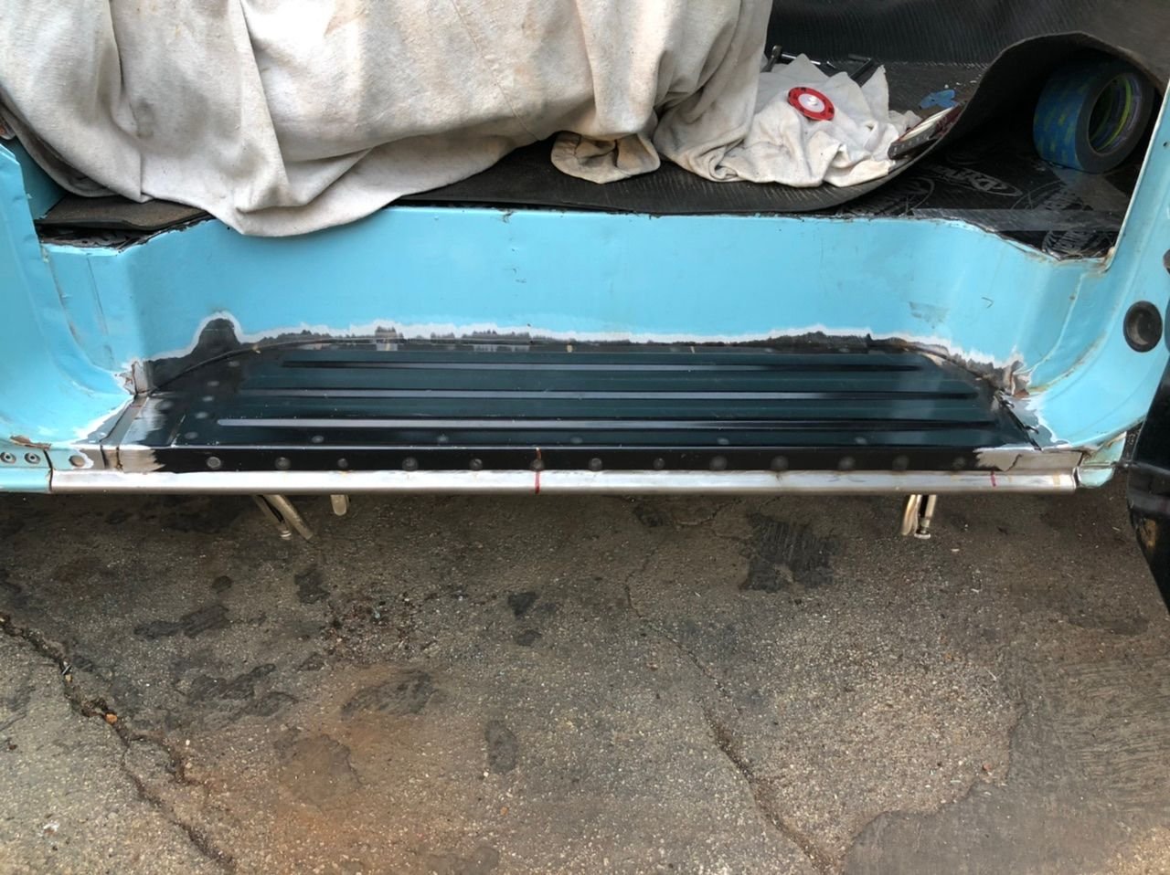

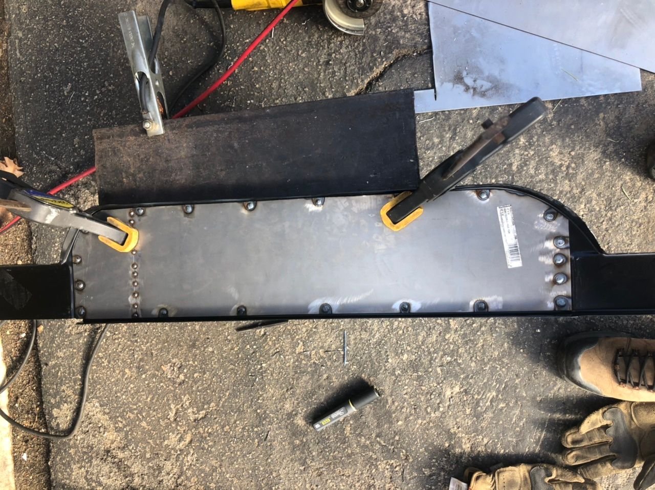

I plug welded the three pieces together today

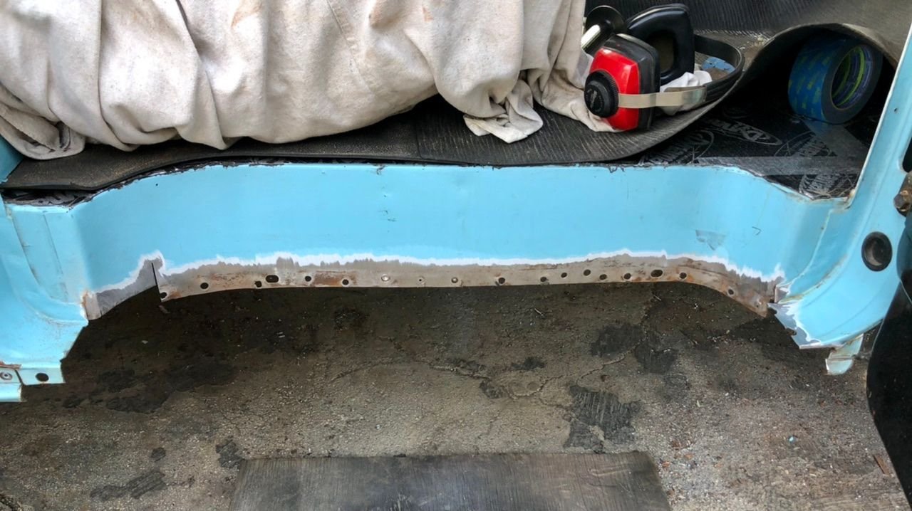

Had to reshape the back part of the well just a little
Not welded in yet but with a little massaging it fits a lot better. I’m going to sandblast it before I weld it in

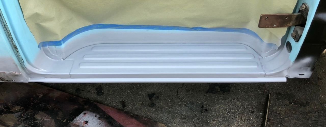

Seam seal tomorrow...
