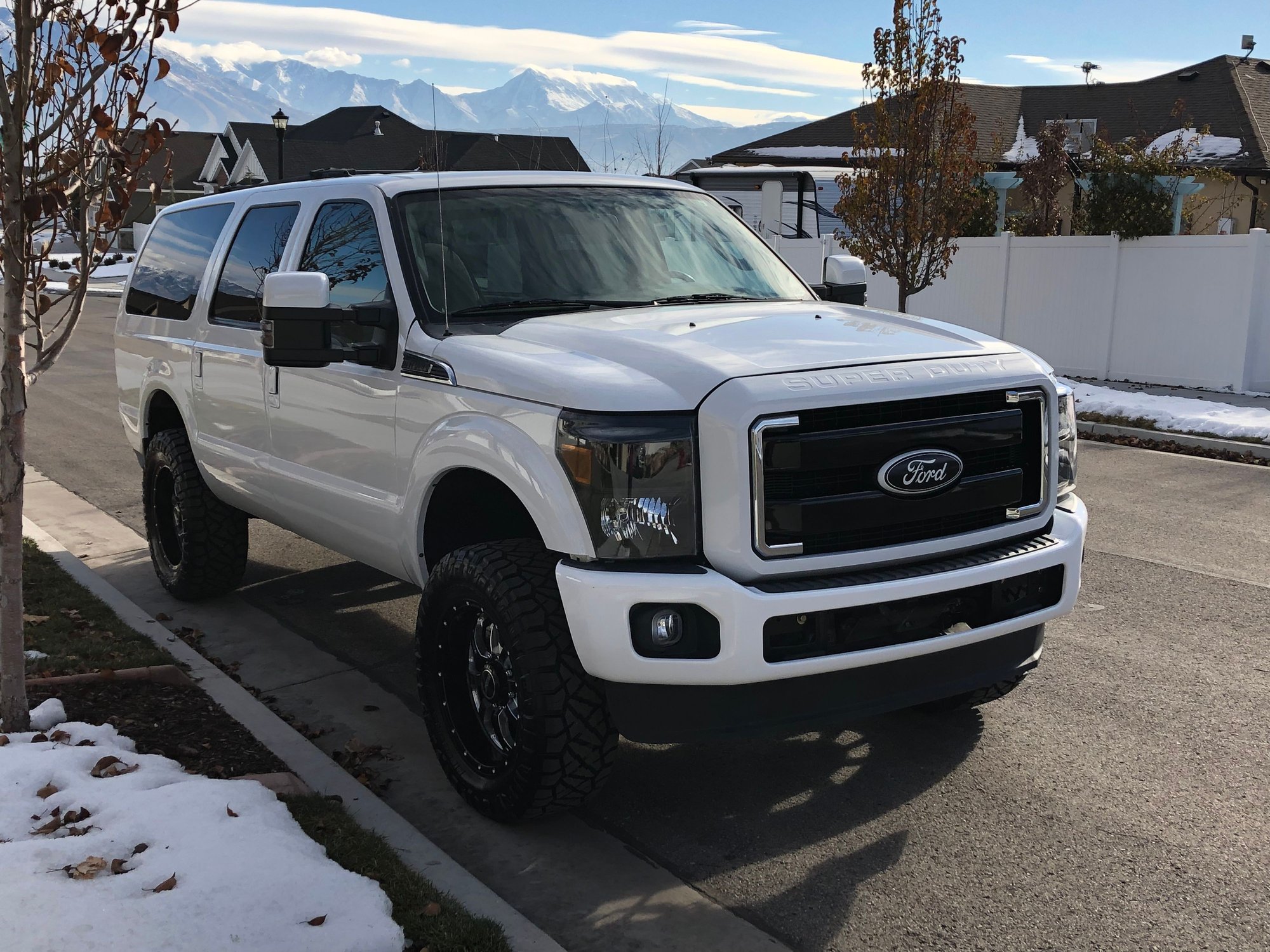

I haven’t tried to clean the radiator yet. One thought I had is I have changed the front end a bit.
Do you think this would be creating more or less air flow?
also I have an EGR delete. Did you mean I have a stronger oil cooler?
