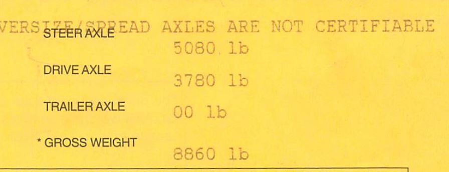

I also use the load and inflation tables, however I add some to allow for uneven side to side loading (at least 10%). From the scale ticket you can see my front axle weighs in at 5,080 with full fuel and 2 passengers. 5080/2=2,540x1.1=2,794 which puts me into the 55PSI column for my 275s. I actually have them at 60 but as soon as I get some chaulk I will fine tune that per Colorado's suggestion. My rear axle weighs in at 3,780 with the camper shell, interior kit, tools and some spare parts/fluids and an ice chest and 2 suitcases. 3,780/2=1,890x1.1=2,079 which puts me in the 40 PSI column, however I keep them at 55 unless towing. I will order some chaulk and experiment with it.
