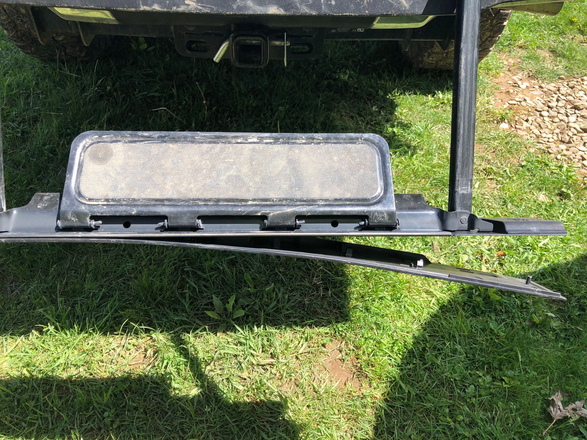

Tailgate step annoyance
Anybody have a permanent solution for this? Pissed me off on my 12 and on my 17 too.

I notice that when I step down off of the step, my soles tend to snag on the lip of the plastic trim that is the "top" of the step. My only solution so far is to be conscious of it when I use the step.
Is that what happened to yours?

I drilled 3 holes and used low profile Nutz and bolts. Done.

Yeah that’s what mine does. Doesn’t seem to even need to snag something - just weird design. I’m going to put a couple small bolts in it. Thanks guys.

Unfortunately my trim is also loose. Not as bad as your but one of the clips does not attach properly anymore. I'll replace it at some point I guess but just going to live with it for now as it may happen again anyway.

Mine is too new to have this occur...yet, but I looked at a parts diagram, it appears that the step is an entire assembly $1085/$716, I do not see where the trim piece is available separately...I will likely install some stainless steel hardware, shouldn't be visible unless the gate is down...
