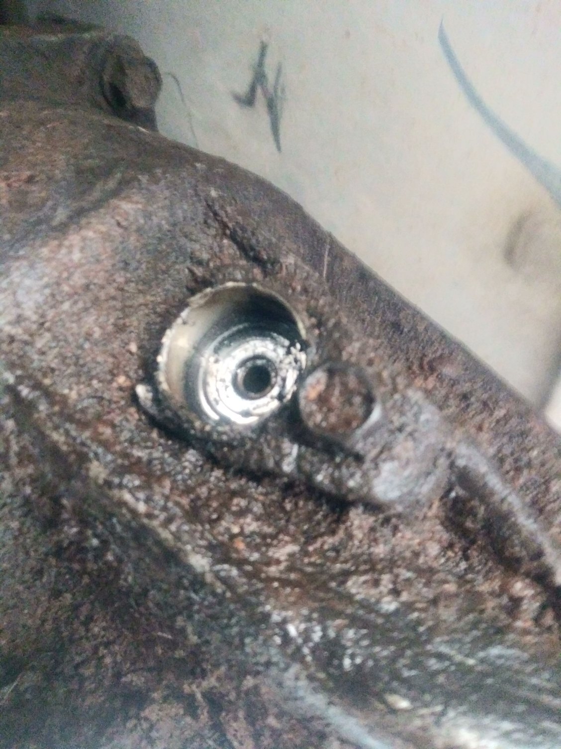

What is this rod called, i need to get another one for my other truck and i also need to order the piece that threads in to the transmission.
Speedo hole
Transmission rod

The piece below slips in with a o-ring to seal. It's retained by a single bolt and a horseshoe shaped retainer that the bolt holds down. You can see the bolt and the u-shaped retainer is still there in the picture. I believe it comes with the cable, pull that piece apart in the picture and see if you have a plastic gear on the other side. You might just need a new cable.
