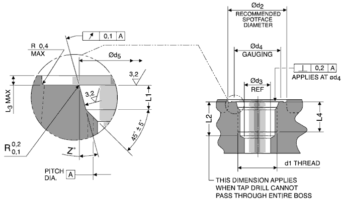

I was just looking at this today, for like the sixth time. A male fitting to connect at the cover isn't an issue. You could even drill and tap for a standard NPT fitting. The problem is the sensor bolt-up female end.
While it's a 12mmx1.5mm straight thread, using an o-ring seal, the issue is how the o-ring is captured. And it's done with a tapered recess that has to be correct not only for the taper but the depth. There are two vendors that sell "Kits", but they leak. They always leak. Because they cobble up a normal straight female 12mm union.
I found the proper tool to bore the fitting, but if I remember correctly it was like $600, and you need a mill.
I have spent hours, probably an entire day, trying to find the proper over the counter fitting, going through Parker, Swagelok, etc.

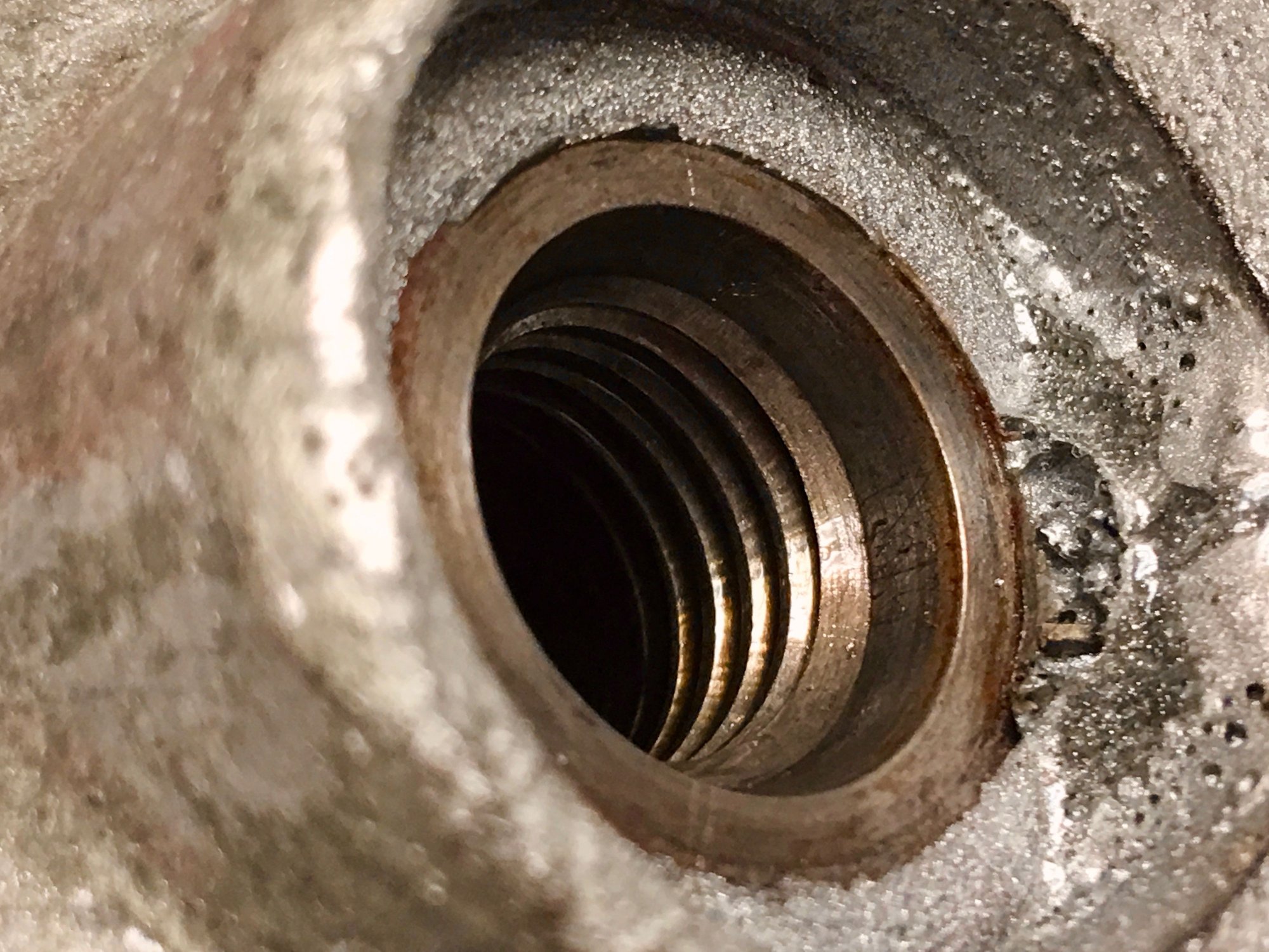

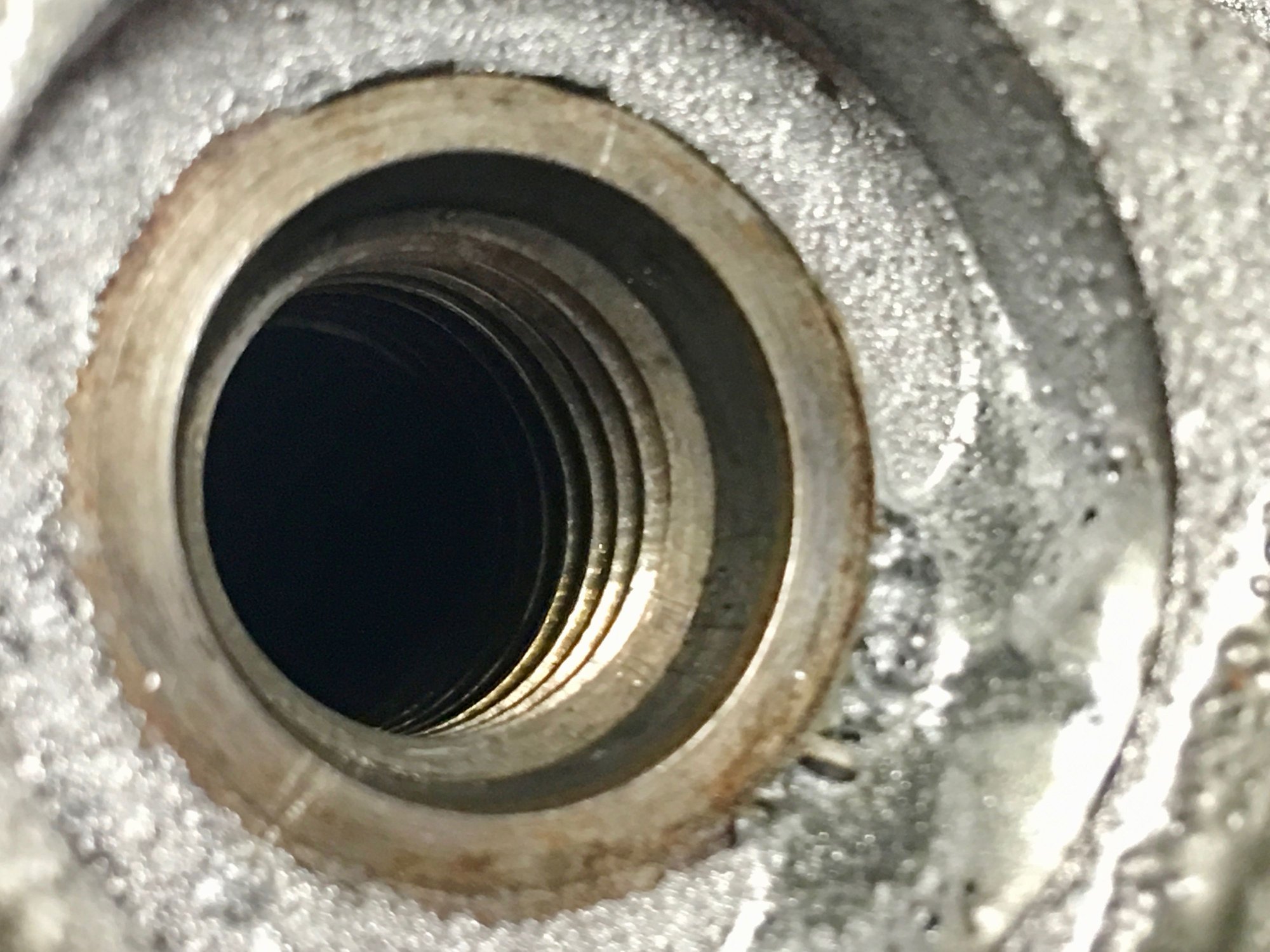

I noticed the recess for the oring in that cover as well today defiantly see your point Jack didnt relize it was tapper cut till you mention it though
There's just to much pressure in the system to not have a taper cut for that oring too bad the aftermarket or dealer have come up with a viable option yet cause I'd gladly pay up to $150 for it

Correct me if wrong
But there is no fitting available to receive and seal that oring on the sensor
I'm guessing all the aftermarket options are not taper cut for that seal therefore they leak
I assume the aftermarket may leak at both connection points the cover and the sensor I could be wrong on that though

I’ve had that Union in one of my wish lists. I also have fittings in a McMaster list for the same.
At the cover you can get a JIC tube to the 12x1.5, that’s easy. What I looked at the receiver end is as surmised, Take a straight Union and modify it.

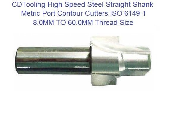

In the past when I looked at this the recess is very specific to achieve a 15% crush of the o-ring, tapered sides and a very specific depth. Yep, a machine shop could do it, not sure I can with my drill press. It's not a crude method. I believe I got more info in the Parker catalog.
The tool I found was like a multi-angle valve seat cutter, it cuts all three of the critical surfaces at once.
What I was thinking of as an alternative are Swagelok/Yor-lok fittings. Swagelok I believe had the male end that transitions to their tube compression. Alternatively, the cover can be drilled and tapped for 1/2” NPT. NTP can handle the pressures with Stainless.
At the receiver what I have is a Yorloc fitting, tube to 3/8 female npt. It has a 7/8 hex, so there is meat to drill and tap to 12x1.5mm. Then we need the o-ring. One alternative could be if the fitting is damn flat (no design reason for it to be) and try to use a high-pressure flat seal in place of the OE o-ring. It would have to be tried to see if it would seal at elevated pressures and temps.
I think the cutter is actually around $200, not 600. But you need the stability of a mill, not a drill press.
What I have in my notes, it's not the same as the first images, ISO6049 or SAE J1926, Those would not handle the pressures. I believe it’s an ISO 6149.
