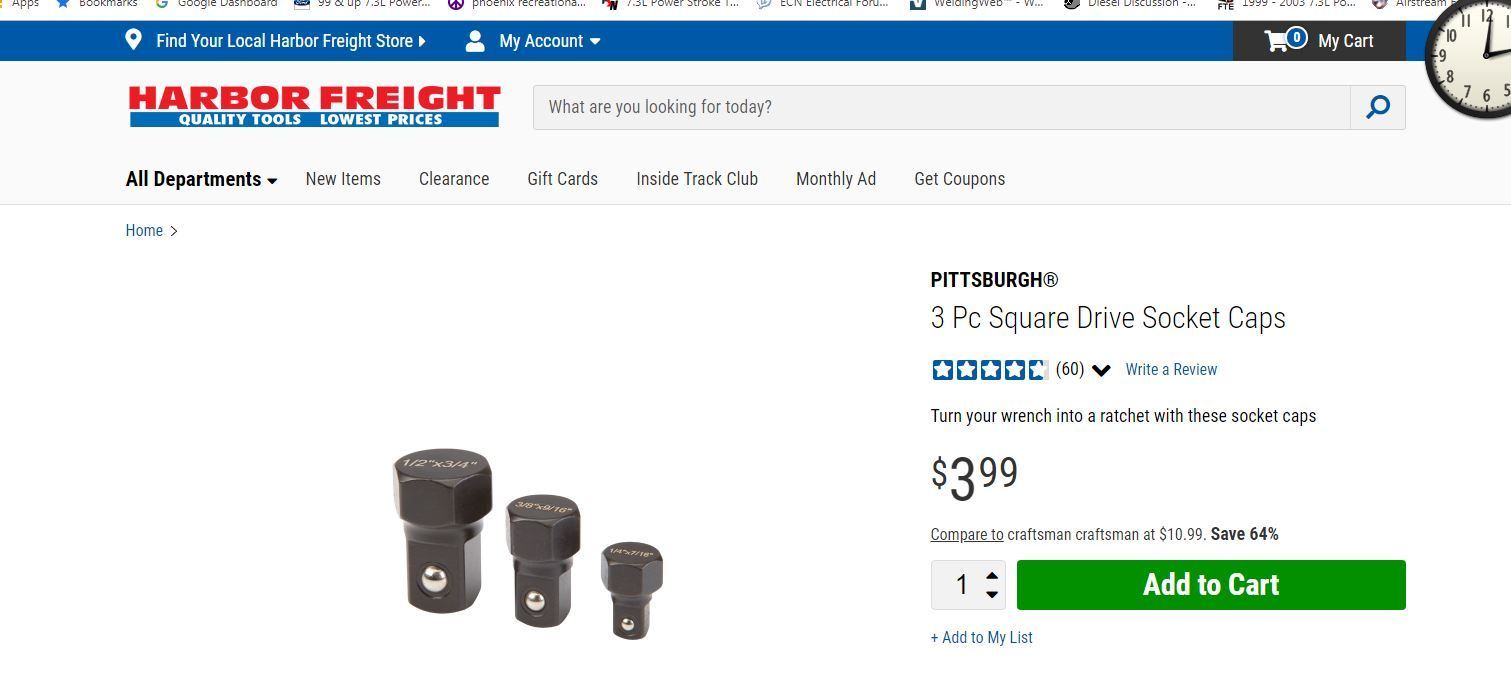

Good video however no need to dismantle a rachet when you can buy adapters for sockets with a hex nut on them
